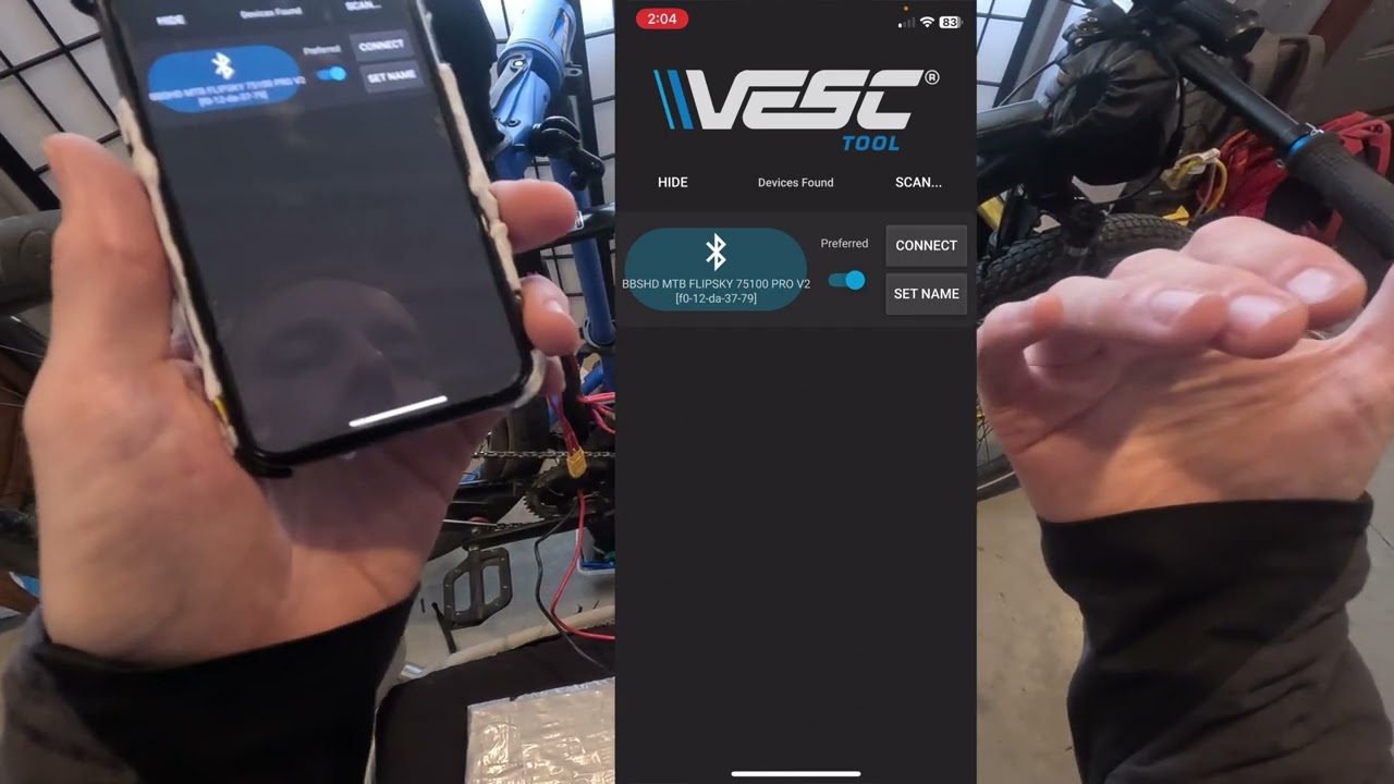

Ah okay, on the MKS 75100 it shows the correct name and also the firmware update was correct. So just need to be cautious with updating Flipsky I guess.

I have the Makerspace 75100 V2. There the name of the VESC was already setup correctly from factory and the correct firmware update is pulled.
