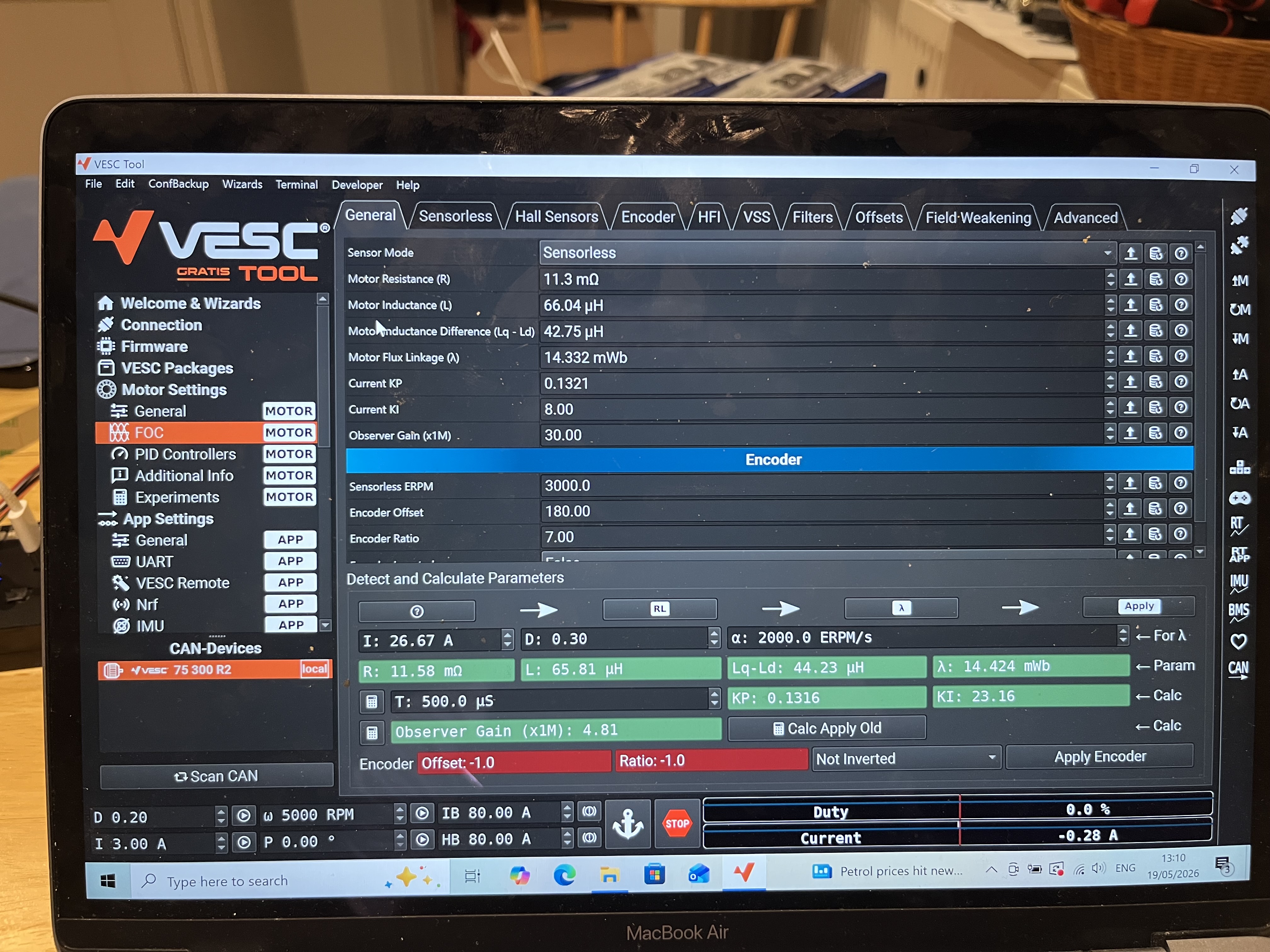

  • Full FOC motor detection completed successfully
  • Motor parameters detected: R=4.4mΩ, L=67µH, Flux Linkage=14.4mWb

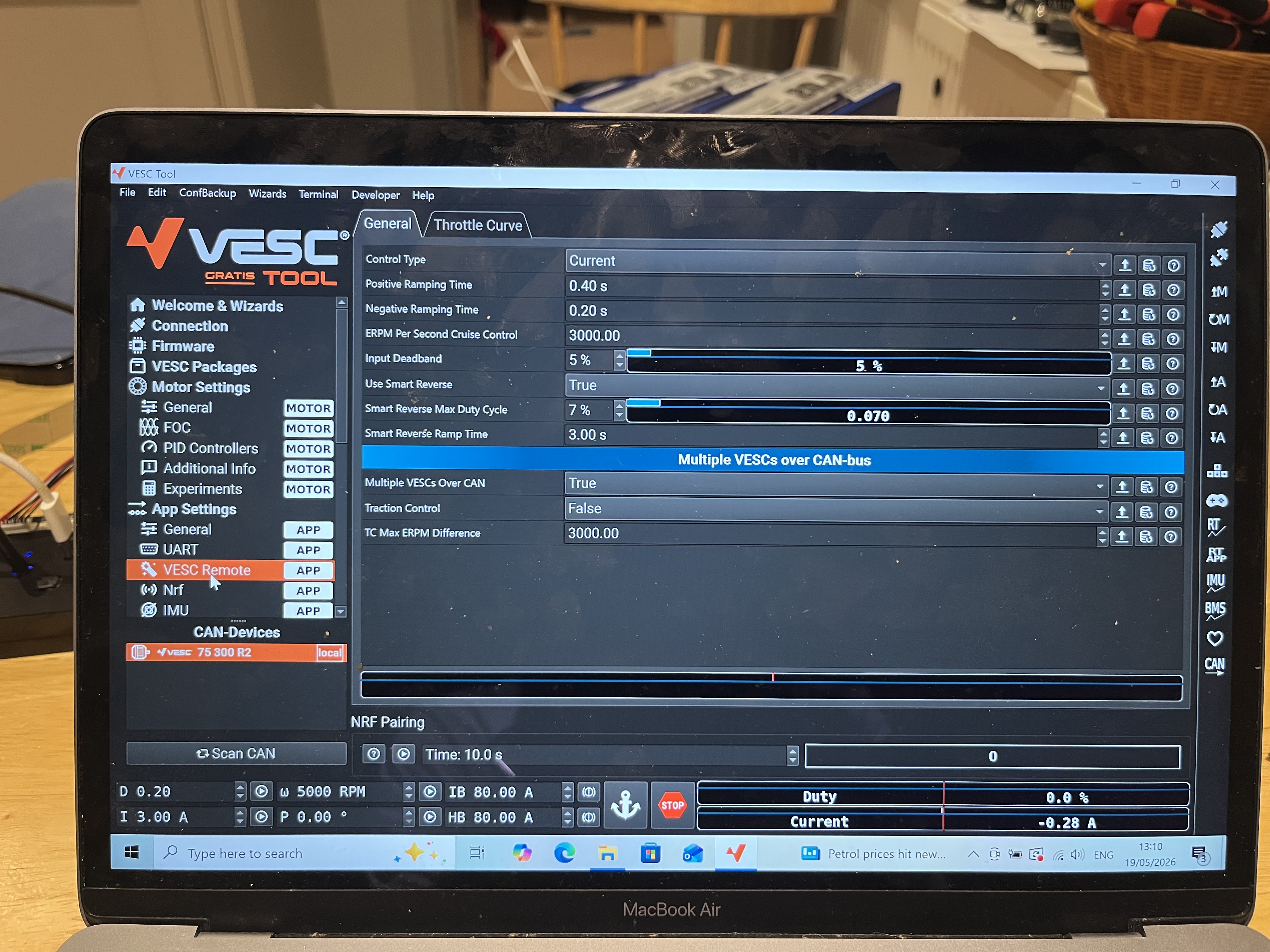

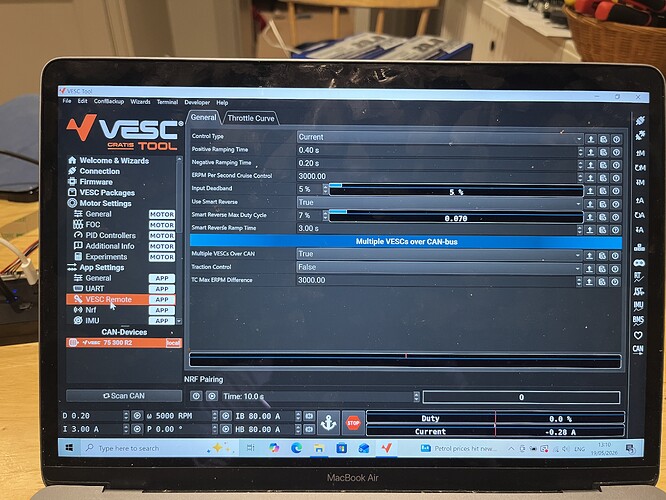

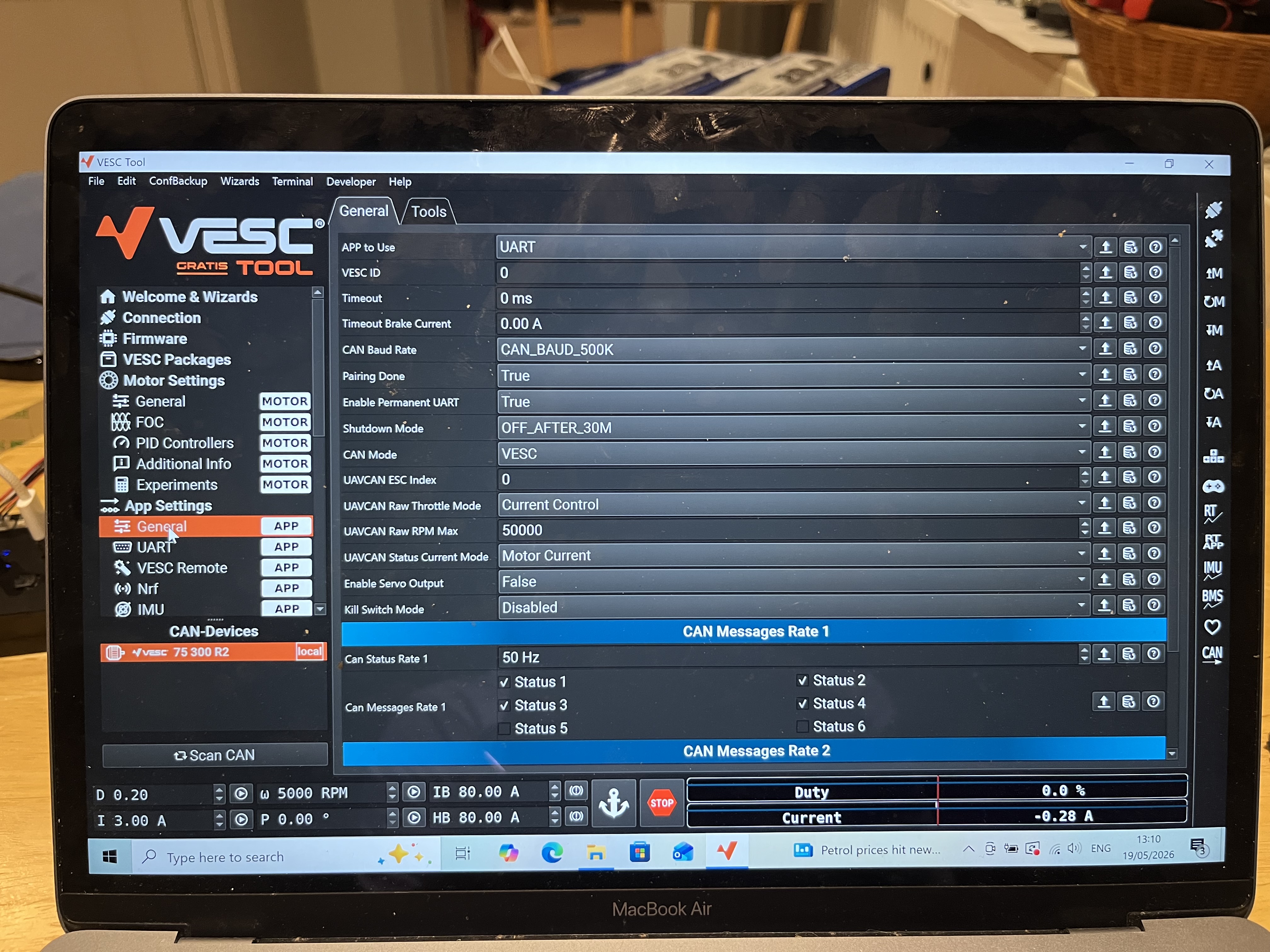

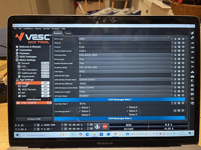

Under App Settings → VESC Remote
What value do you have under “Control Type”? It should be “Current No Reverse”.
Under App Settings → General
“Pairing Done” should be set on “true”
I have setup my VESC freshly yesterday and those two settings were on “OFF” and “false”. I had the same symptoms as you.
Maybe you can post screenshots of your settings?

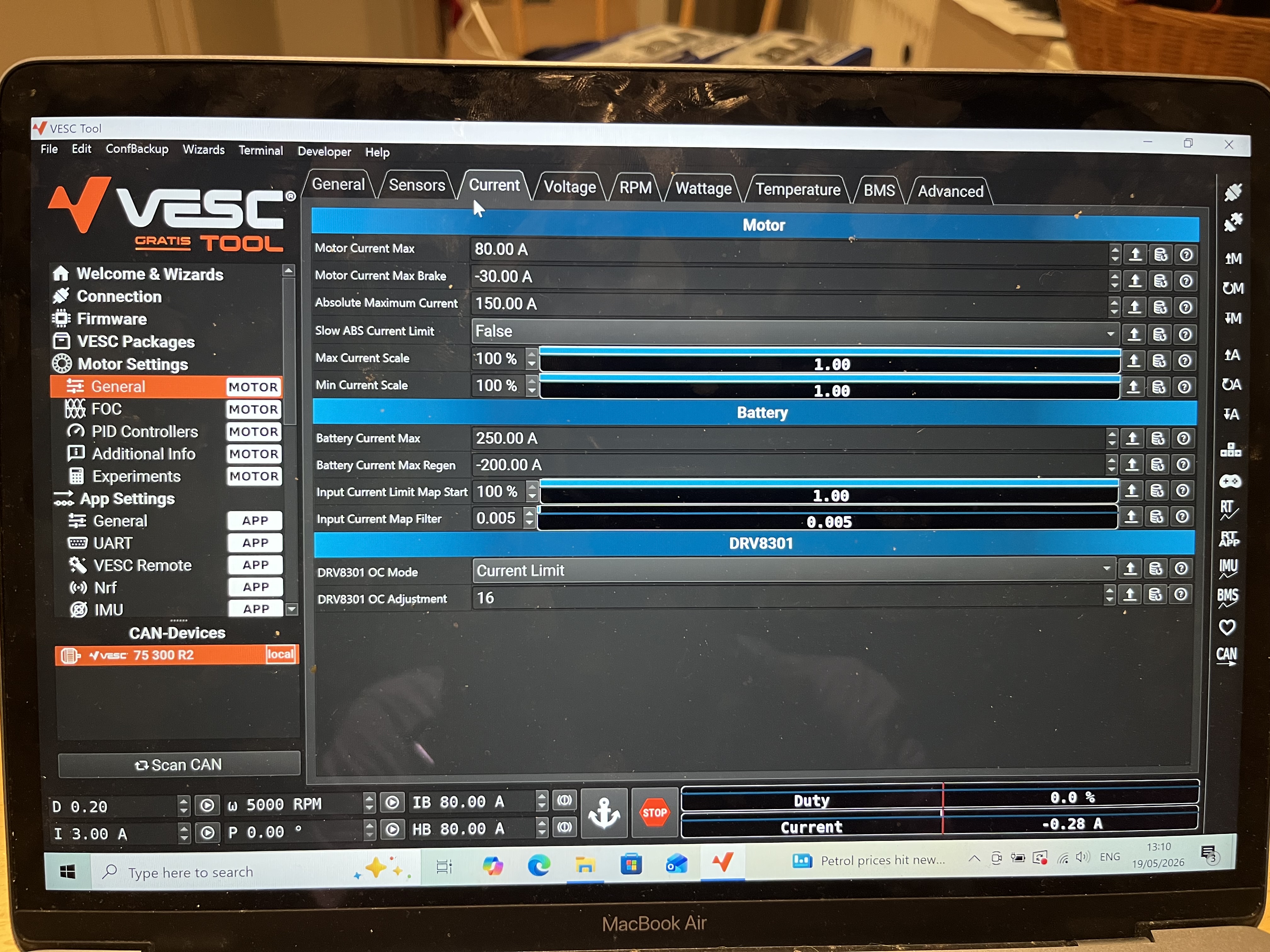

these are my setting when I do flux linkage test the motor spins nicely.
there was also no difference between current and current no reverse.

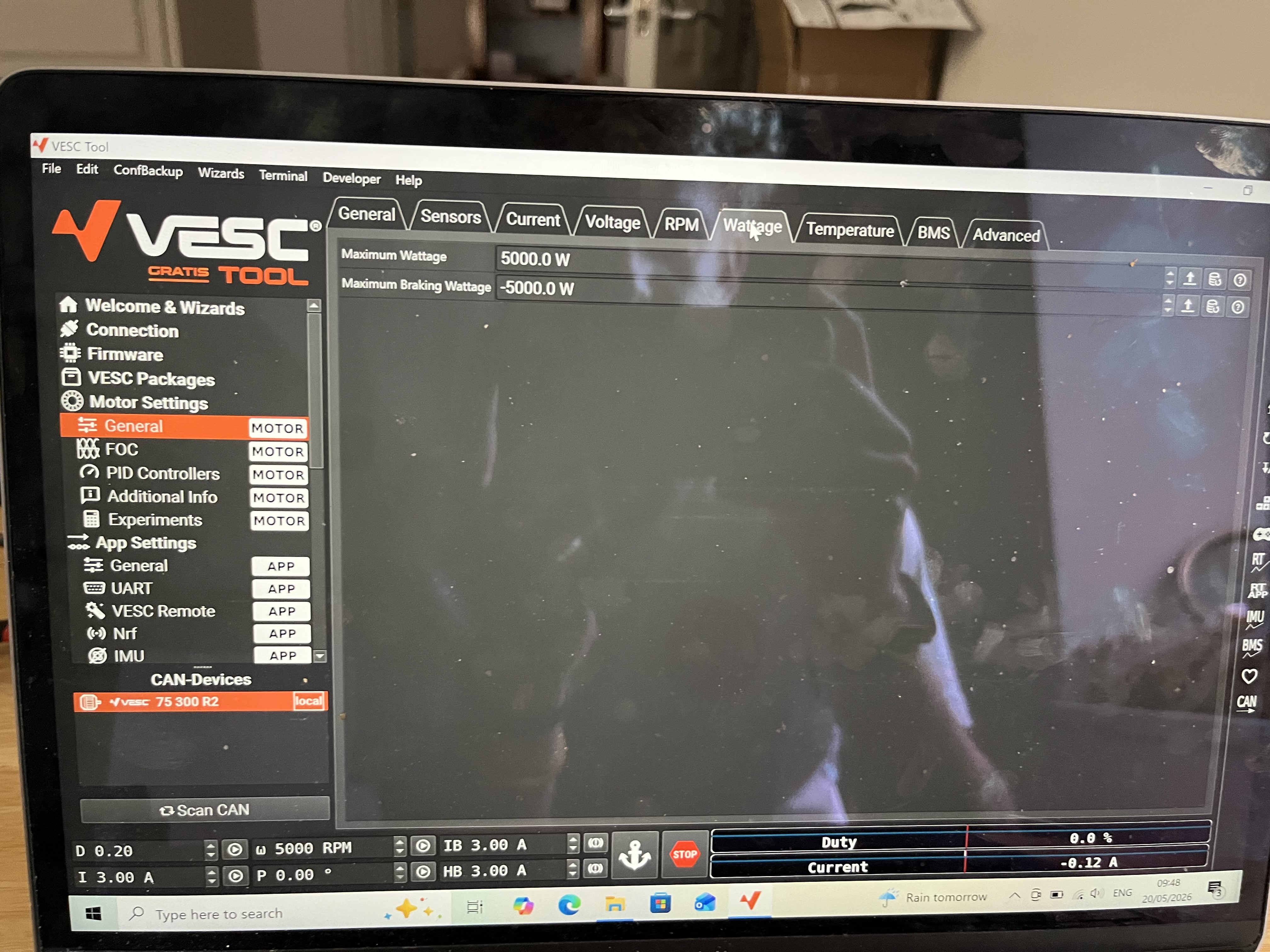

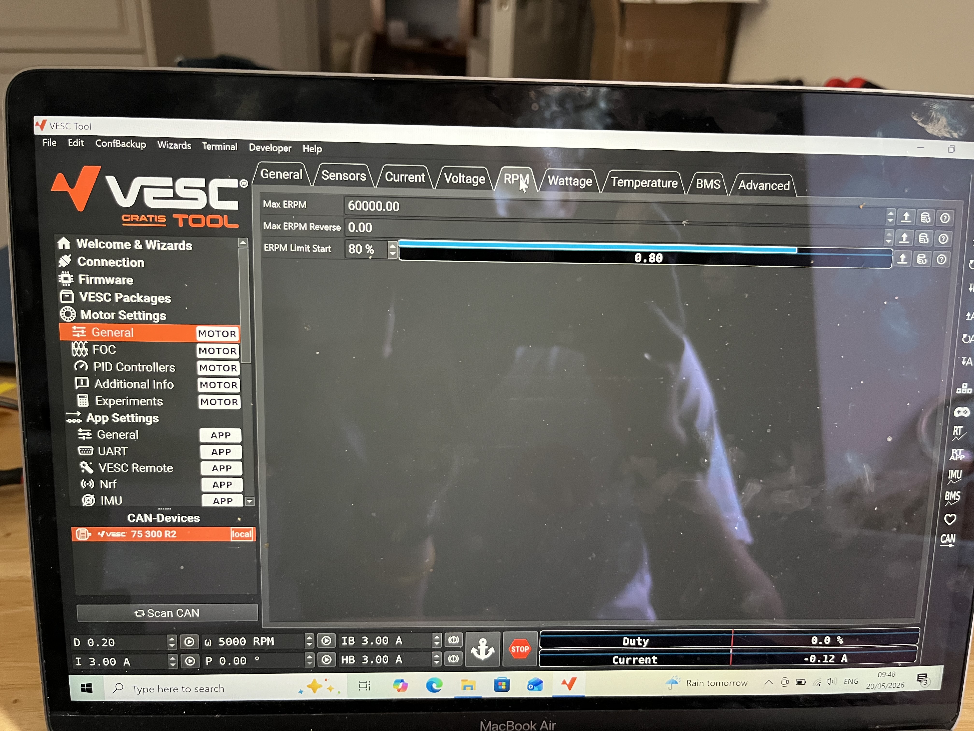

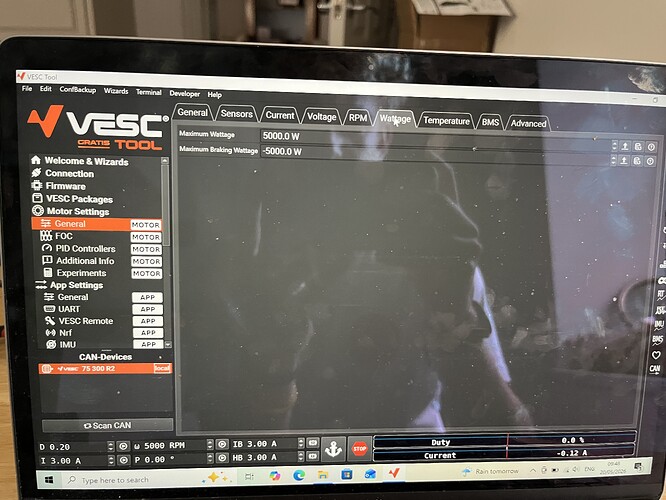

The settings seem to be fine. The only odd values you should change, but will not help you to resolve your problem:
  • App Settings → General: Timeout should be at least 1000. I have 500. This is a safety setting and it stops your motor when the controller looses connection.
  • Motor Settings → General → Current: Motor Current Max to low, Battery Max Current and Battery Max Regen Current are way to high. Your LiPo might be able to deliver it, but you really do not need it and you probably will never hit that value.
    For the 75100 you can set Motor Current Max between 100 and 120A (I have it at 120A with good cooling and it also depends on your motor Kv) and Absolute Maximum Current at 160A. The Battery Max Current you can set between 60A and 90A to be able to reach the motor current (really depends on how much your battery can safely deliver → I do not know your battery, so might have to limit it lower + your needs might be lower → bigger board for example). Battery Current Max Regen is not relevant for us, but it should not be 0 because it could cause other issues. In the setup video he says between 20% and 50% of Battery Current Max. I have mine way lower than 20% (6A) with not problems.
I would really advise you, if not done yet, to watch the video @DutchFoiler posted above on how to setup a vesc.

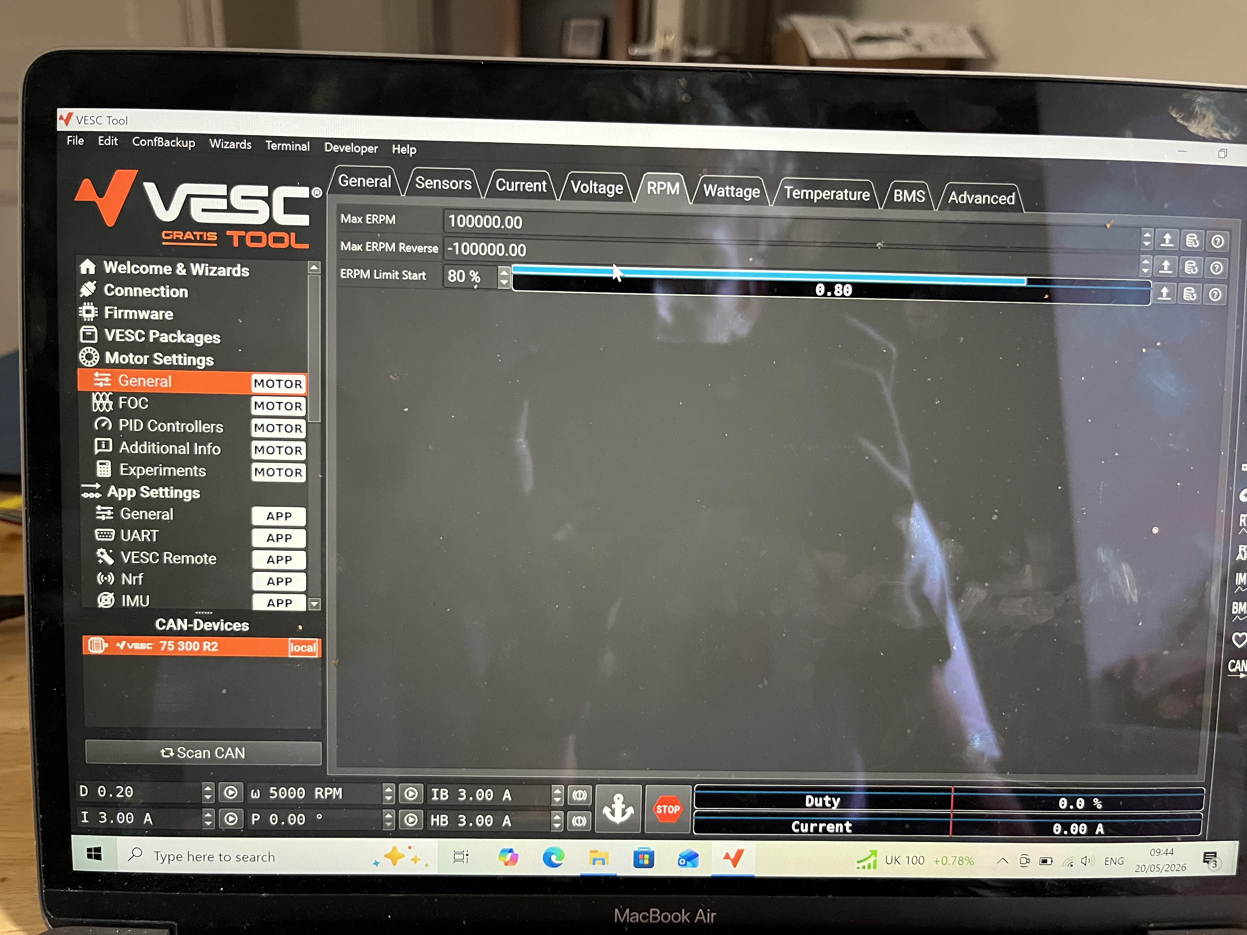

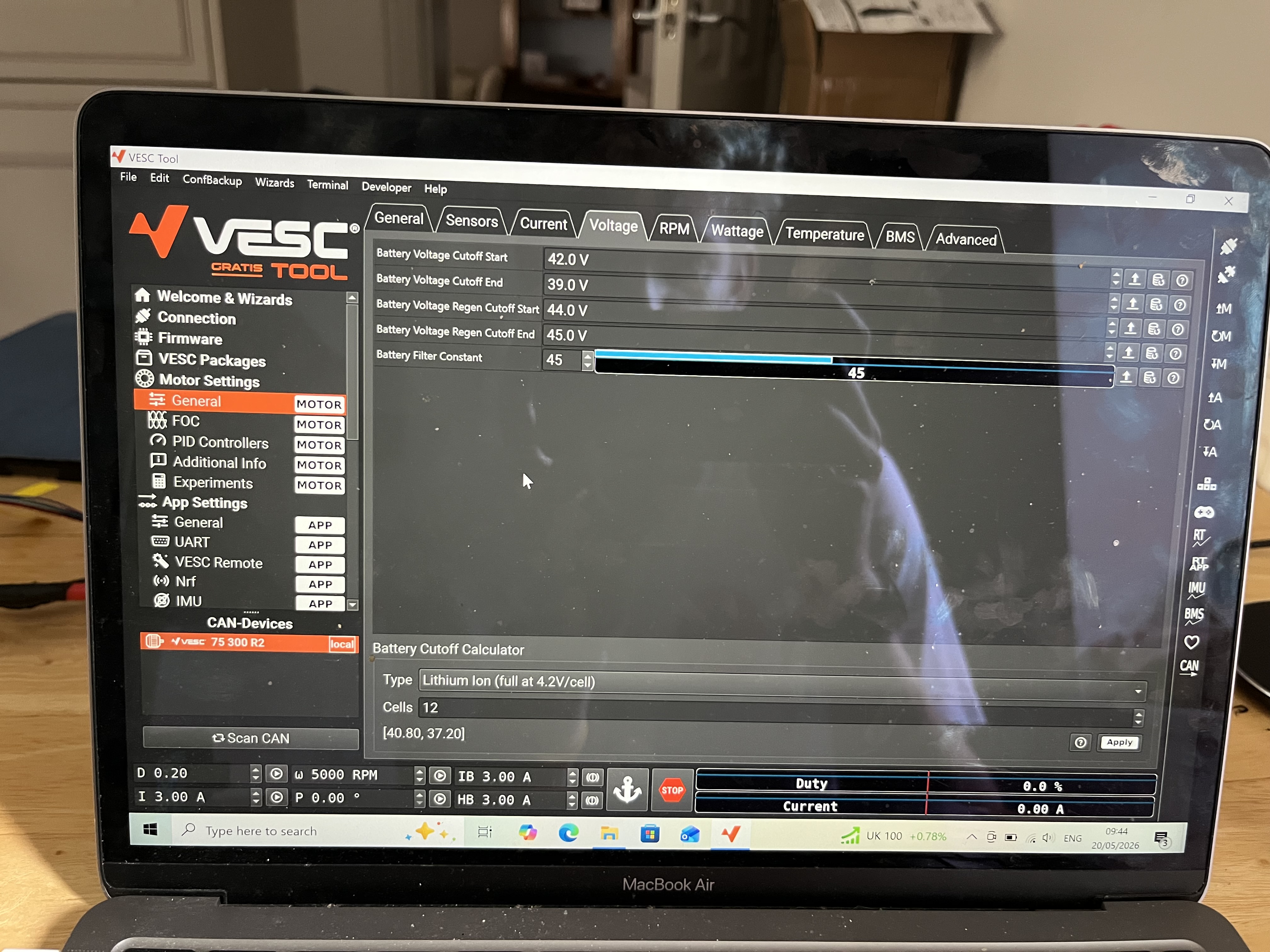

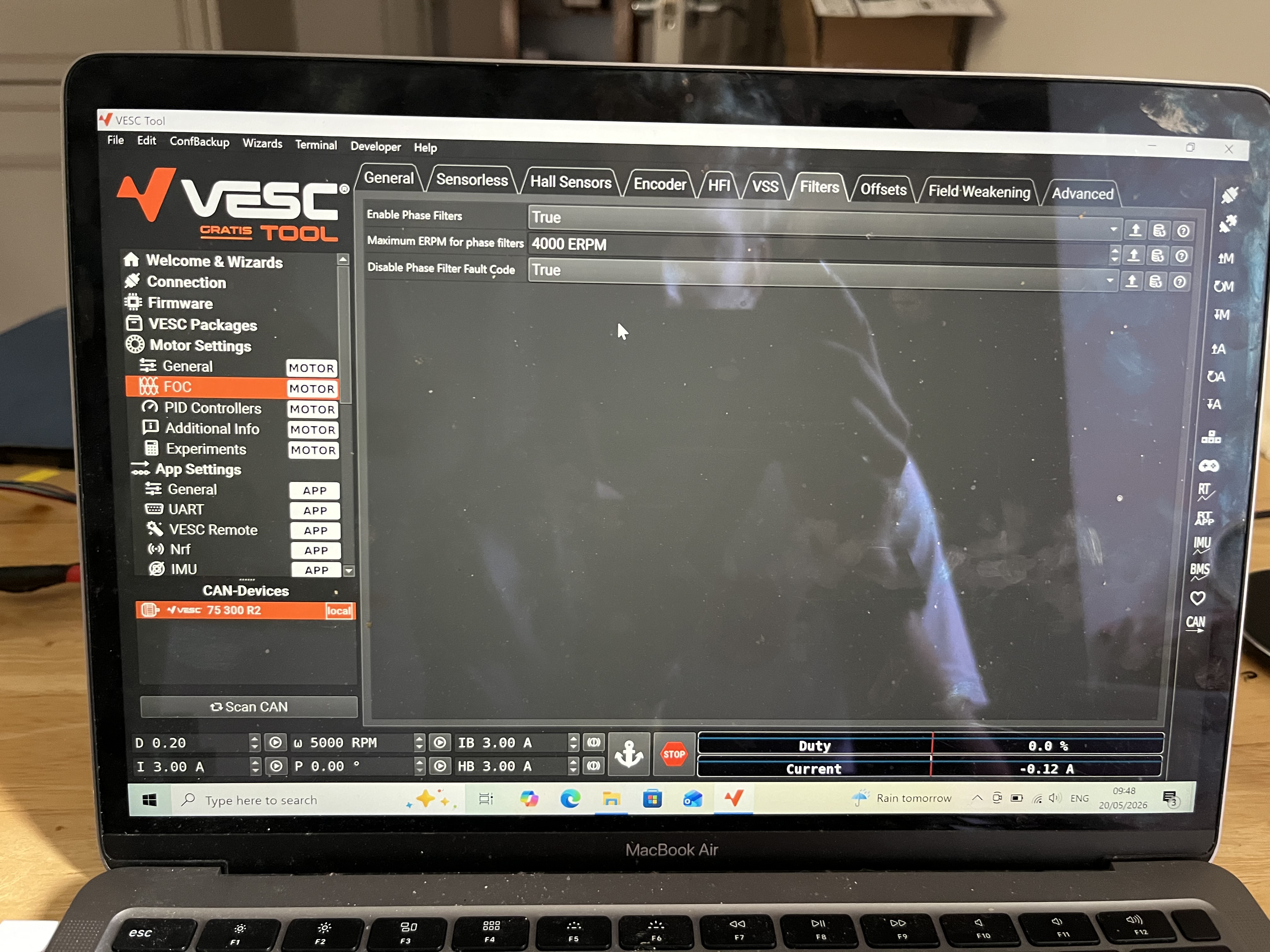

Could you also send the rest of the settings under Motor Settings → General → Voltage, RPM, Wattage. And Motor Settings → FOC → Filters
From the screenshots you left out the settings for UART.
Not even sure what VESC remote is, but since you selected UART, that is where your settings are.
