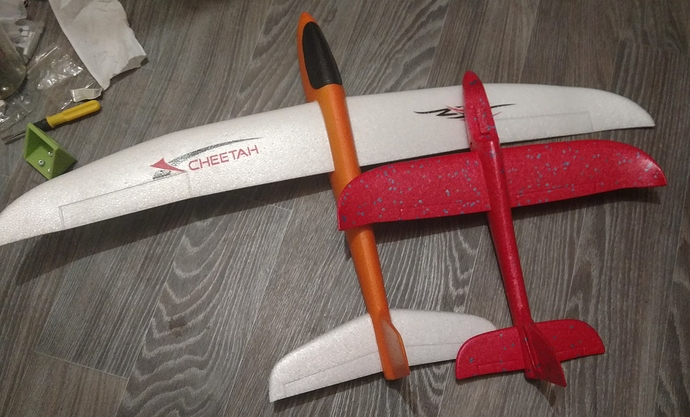

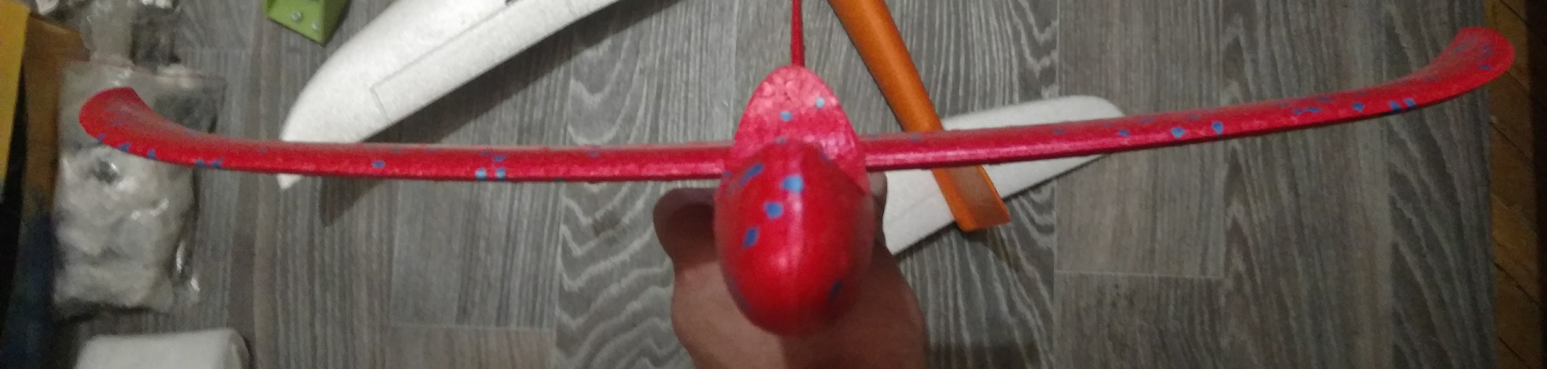

I’m watching on this model and interesting is it good to take mold for fuselage or wings (35-48cm span) or even cover wings with fiberglass or carbon to make rare wings from them?
Beware! Those are dihedral wings (angled up at the tips). You’ll want anhedral wings (angled down at the tips). Dihedral is great for roll stability. Anhedral decreases stability. That’s normally really bad for an aircraft or hydrofoil, but actually allows for better turning on a foil board. Or such is my understanding.
Since dihedral tend to oppose to roll action, it brings roll stability, the board goes back to horizontal position when the rider engages in a turn. Do we need it as the board would be less manoeuvrable ?
Anhedral perform very well under water because our efoils are not unmanned gliders, efoils are controlled by weight shift. See the new eTakuma (Avante) Carver frontwing below:
