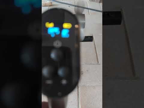

I have received my Erayfoil remote and have just opened the box and the remote itself. see the following pictures.

All the electronics are sealed in the circled part arrow #1 . I understand now why the screen is so small. You can see in the pictures above that the only part exposed is the antenna. The arrows pointing to 2 and 3 are small magnets that are used with the hall sensor. The weight feels good and solid. Construction of the remote is solid and has a very comfortable feel.
I bench tested it and it looks OK.
Images coming soon.
It shows battery voltage, the lock and cruise control work as expected.
Still have to check it under water and range test under water.
Outside it penetrates 3 concrete walls and half a car. Behind the car it looses connection and locks.

Cruise control demo.
Final completed my new battery so I can test the new remote. I added the JST-PH connector and a small pin for the batt voltage. I’m using PWM so all together there are four wires connected. The screen is very bright and compact. I also charged the remote and it charged very quickly.
This is the first test of the remote after calibrating it using VESC Tool. I have it set to duty cycle no reverse for bench testing. Also notice percentage point when the prop starts spinning! At around 2% throttle I’m getting movement. It has good response and a great signal strength so far. I have an antenna extension run to the nose of the board. The water test is the last real hurdle!
I completed my water test with the Erayfoil remote. This remote is ready to use out of the box and is water tight. With the antenna extension I never lost a signal or had intermittent responses. I pulled the trigger and had an immediate reaction.
