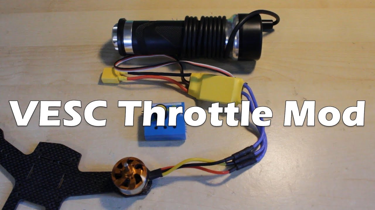

Actually this looks even better:
VESCs can take 0-5V throttle input directly so it would be an alternative for you, i’m suprised that this was not already mentioned!
