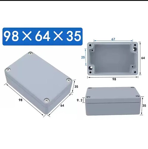

Yes, the connections of Sequre are outside, I was thinking to 3D print enclosure for the wiring connections, but I will put it in this alu box:
'AliExpress
The big advantage of this Sequre, as I see it, is - the common connected heatsink from both sides, so enough to attach one side to the box.

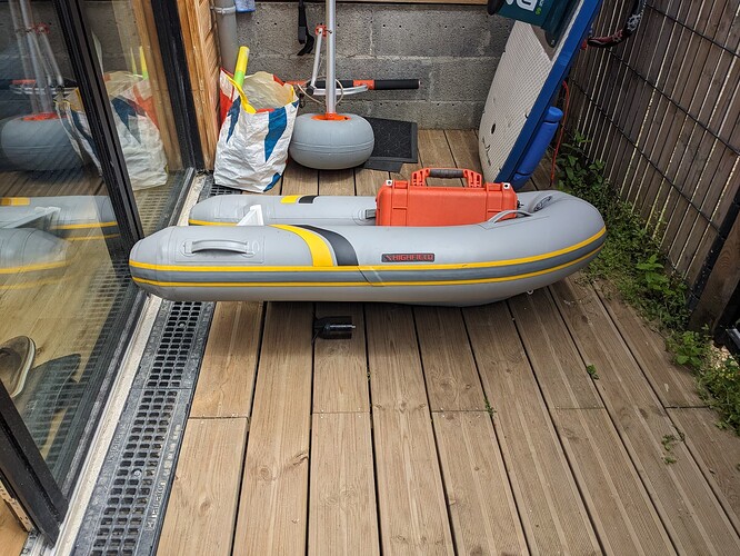

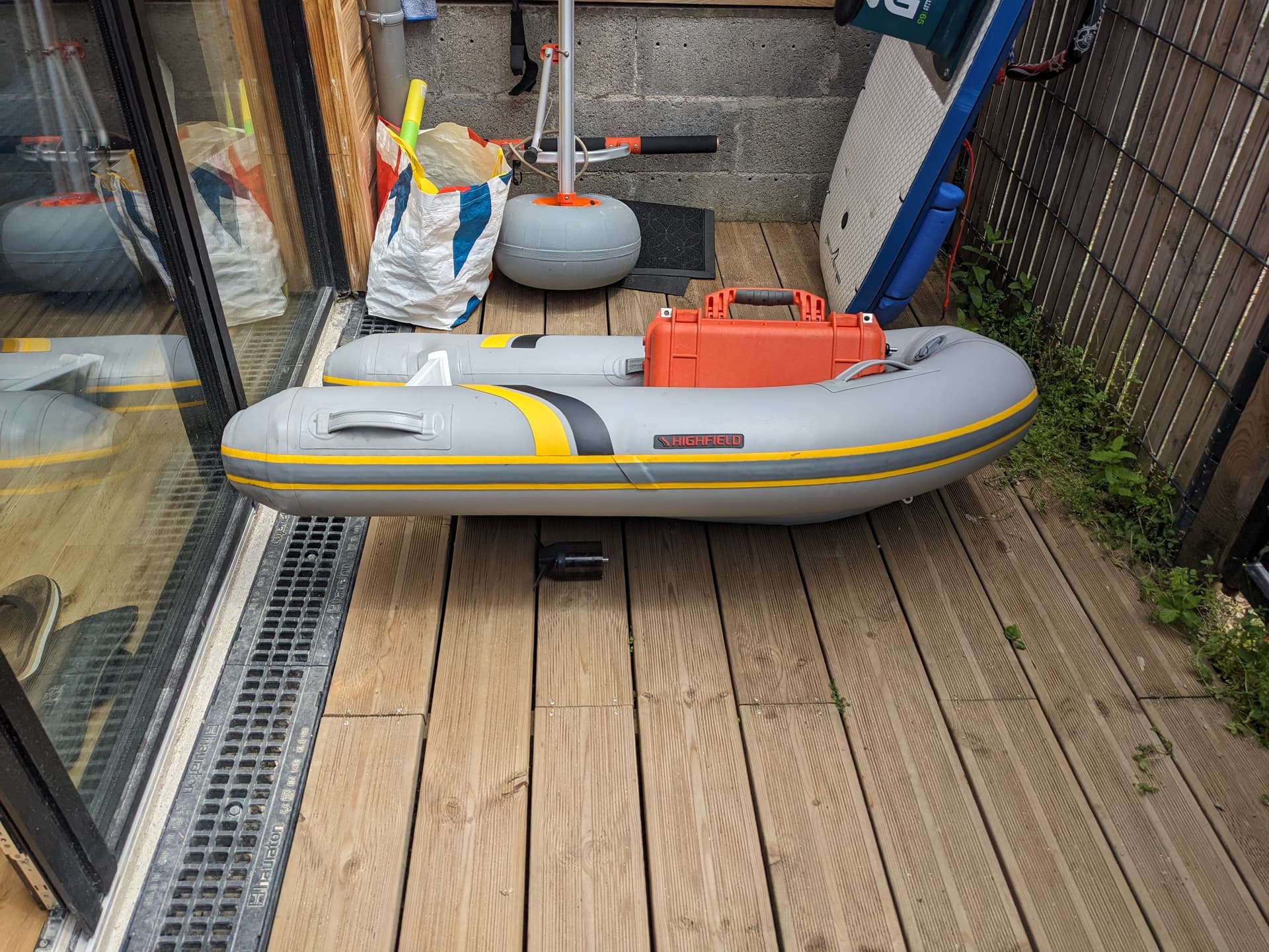

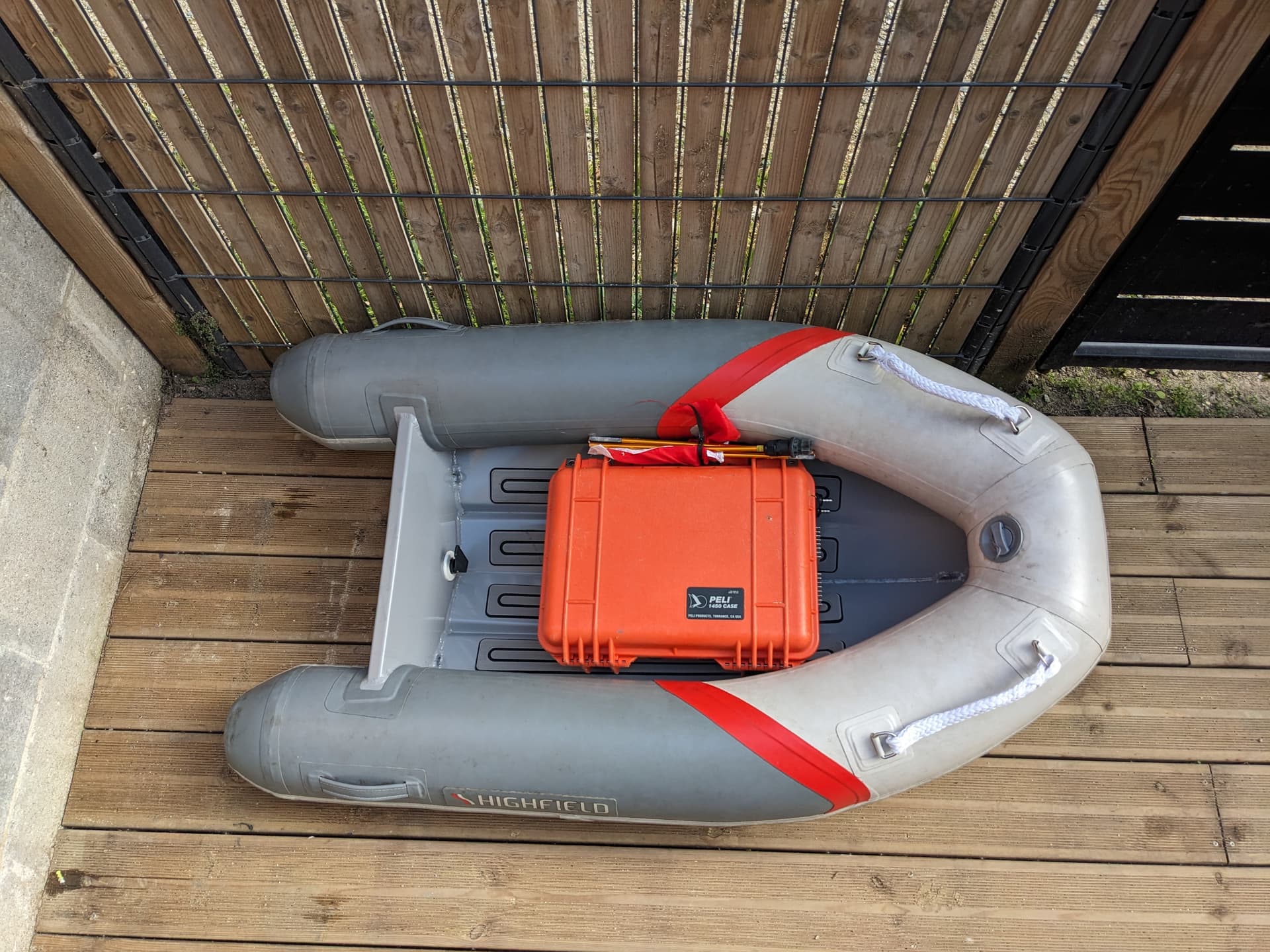

Lately I had the chance to find a micro dinghy from Highfield, the mini ALU for display. Aluminium V shape hull, 8kg.
Project is to use everything from my dual motor tow boogie with a Bremote V2.
Hope to find the good balance:
I’ll put the box as forward as possible, cut the Gong masts shorter and set the propellers closer. Hope to be able to use it without a pole bar to keep the original design🙏

Did you buy this box ?
This is not 100% aluminium (cast aluminium), so, cooling is not perfect ?
I have these boxes, but didn’t use . Waiting for Sequre esc waterproof version.

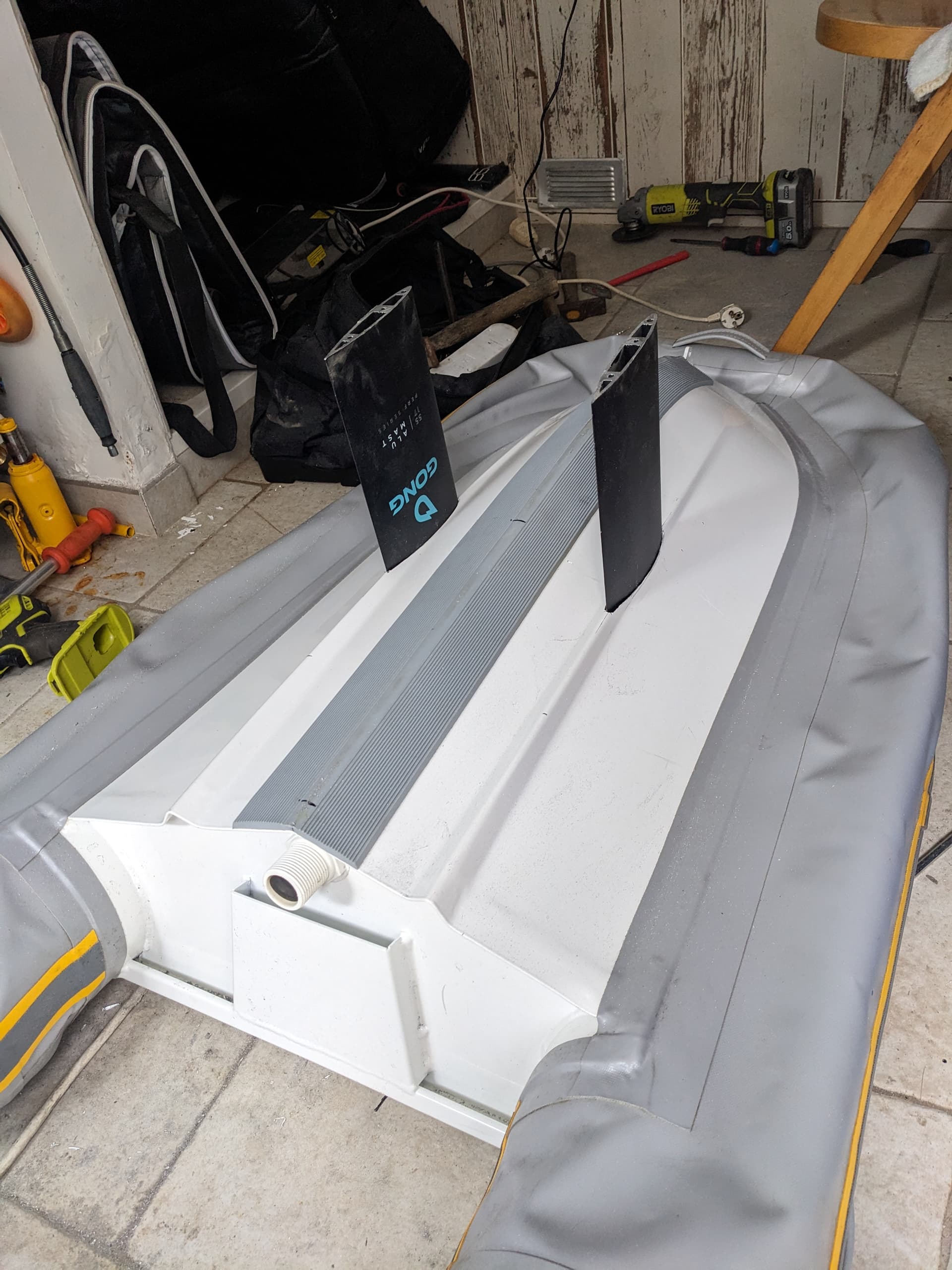

Some news about the inflatable tow project. I’m a bit constrained by the short hull for weight positionning
Succeded to avoid welding alu mast by using the original bench inside the boat, everything is screwed.

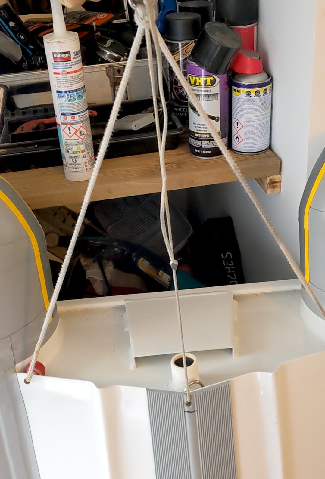

Will set the box as forward as possible and will try a V shape rope on the aft of the hull without rigid extension to counteract the water flow from the inside propeller when I turn.
I hope the rope attachement won’t be too close to the propeller :crossed_fingers:to have have a correct pivot point otherwise I will have to fix an extension bar

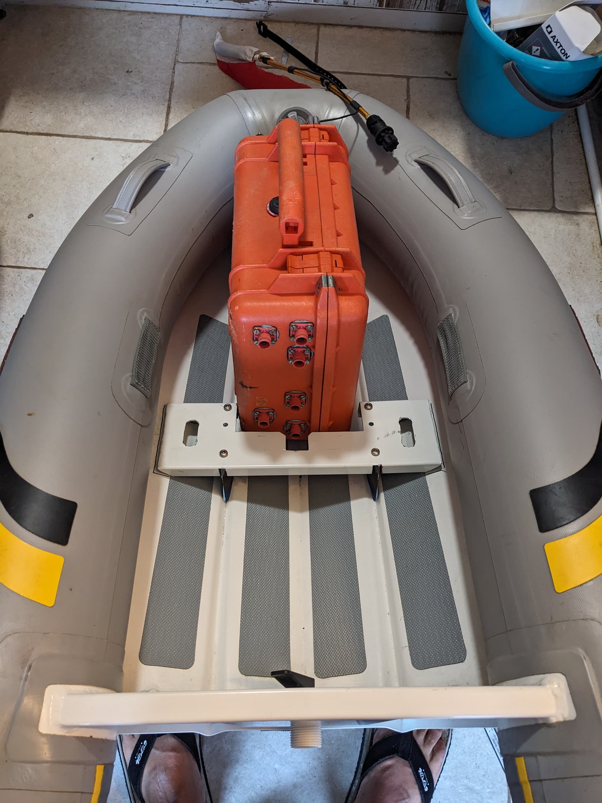

That little dinghy is so cool! Good luick with the built. If you can lay the case flat it will lower the center of gravity a bit which could help things.
I set it in this position because flat I can’t put it as forward as in this configuration
Anyway, the batteries are down in the box so I couldn’t have a really better solution than that.

I’ll try this steering system. Center rope lower point is always under tension , side ropes are activated only when I ride on the sides. I go right, it pull the left and vice versa.
