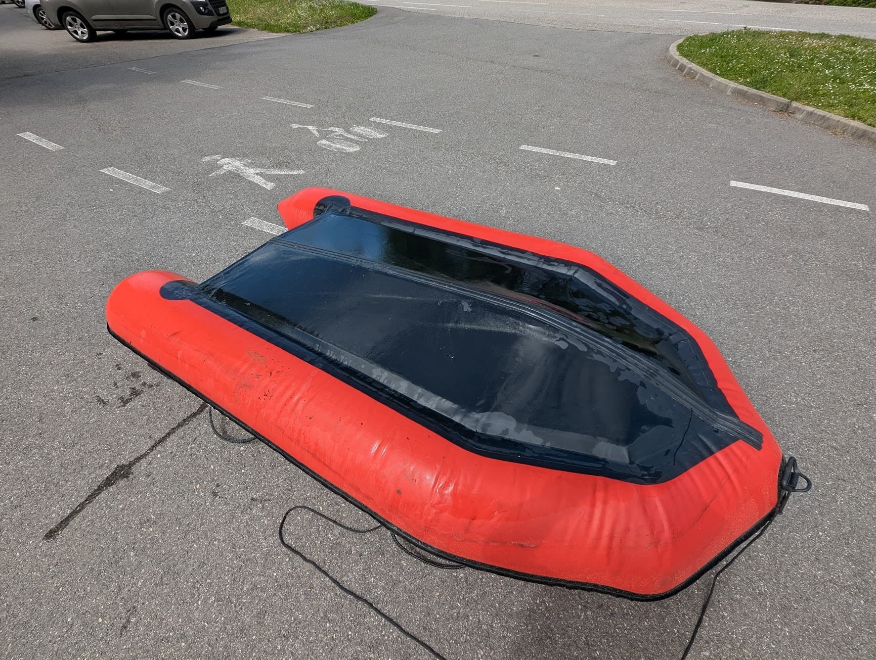

I have found one of these but it has an inflatable hull would it possible to make V hull from fibre glass and glue to bass to attach motors?

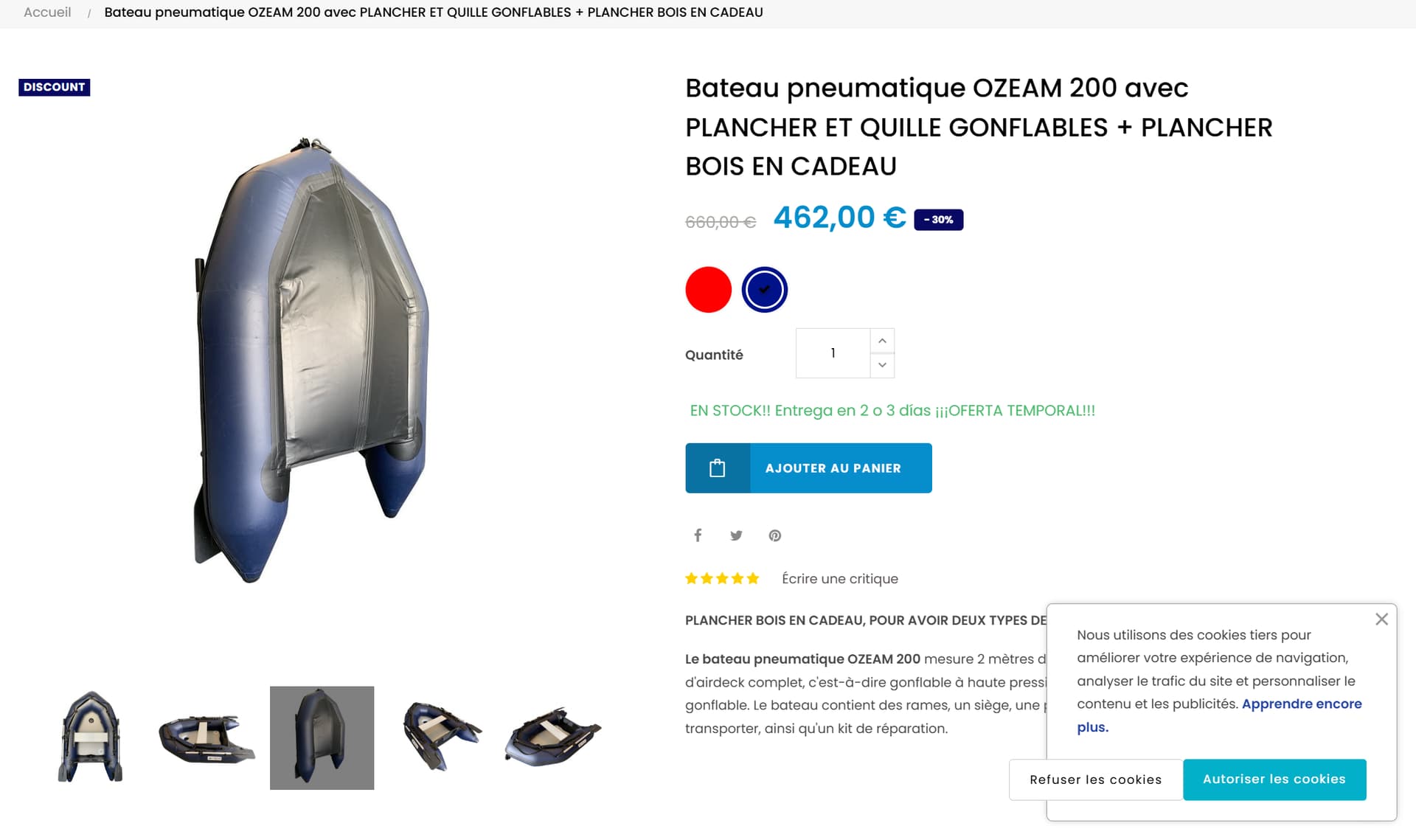

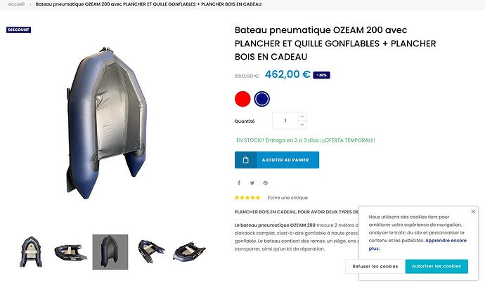

I have Ozeam air deck 300 with V queel. Very stable and light.

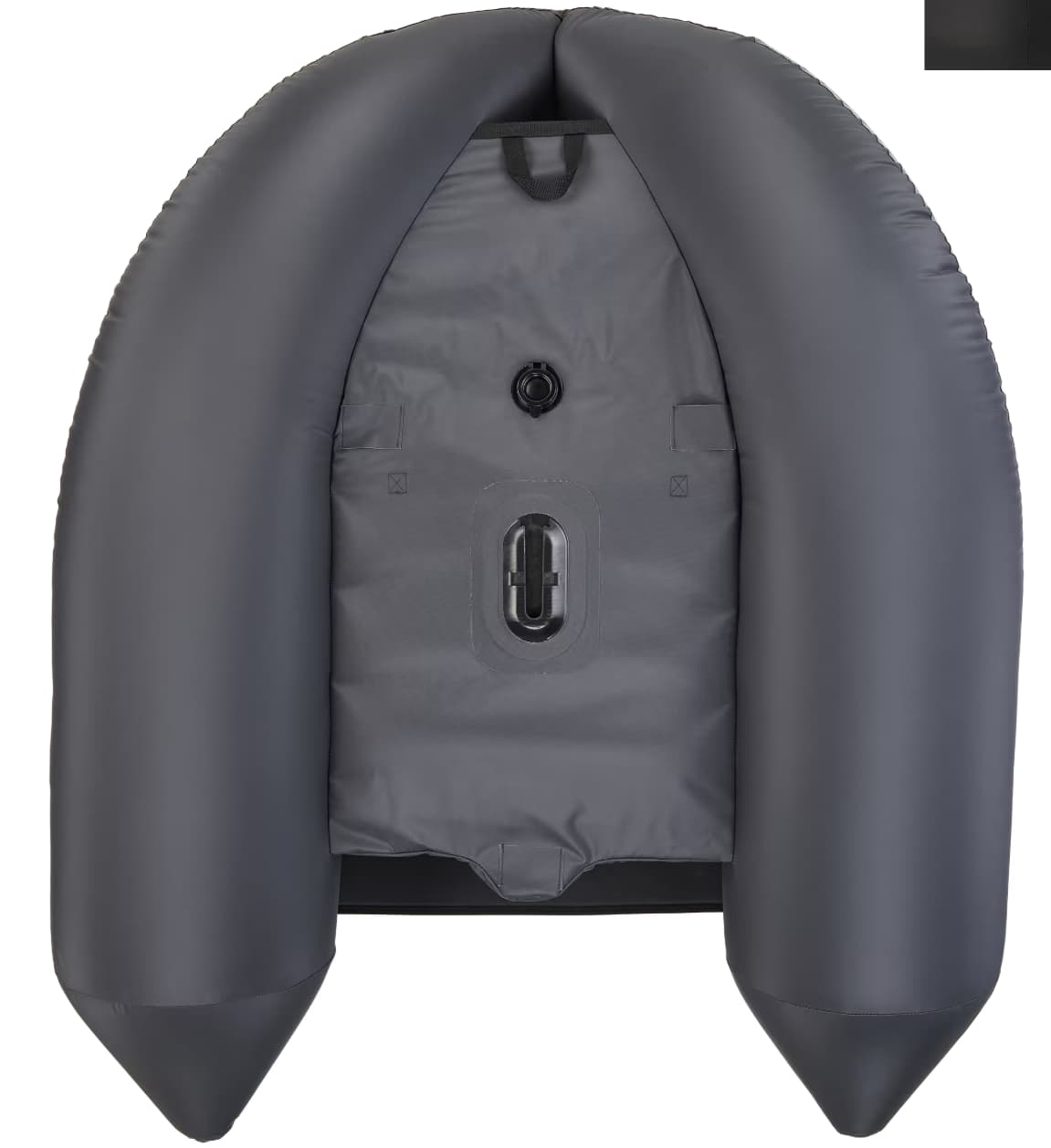

I think this would be a very interesting option (145cm x 110cm):
https://www.decathlon.co.uk/p/float-tube-for-predator-fishing-fltb-5-v2-motorisable-limited-edition-camouflage/_/R-p-332558?mc=8643994&c=dark%20grey_fluo%20orange
It already has a place to attach a single motor but could be modified to fit 2

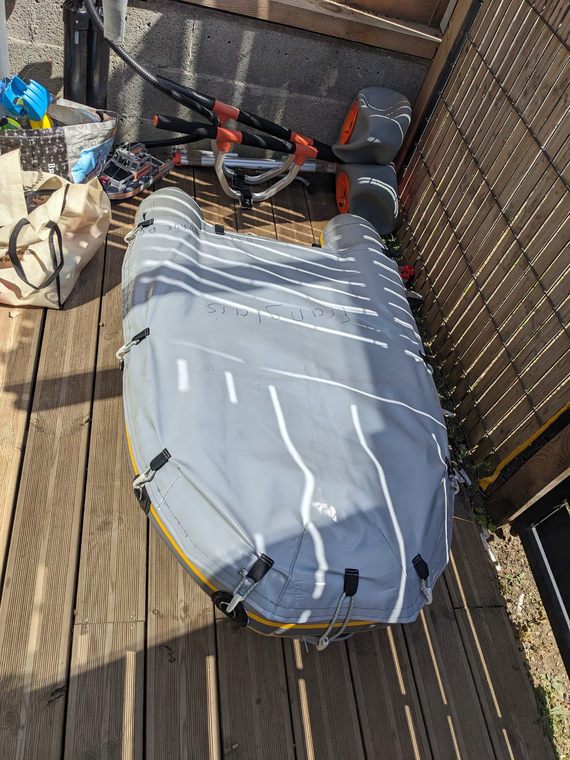

Last option of the dinghy to hide everything for a clean looking

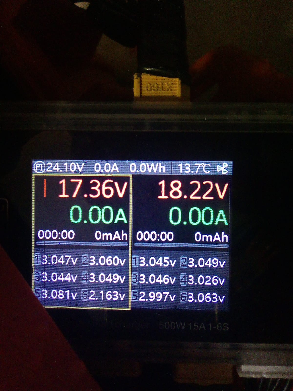

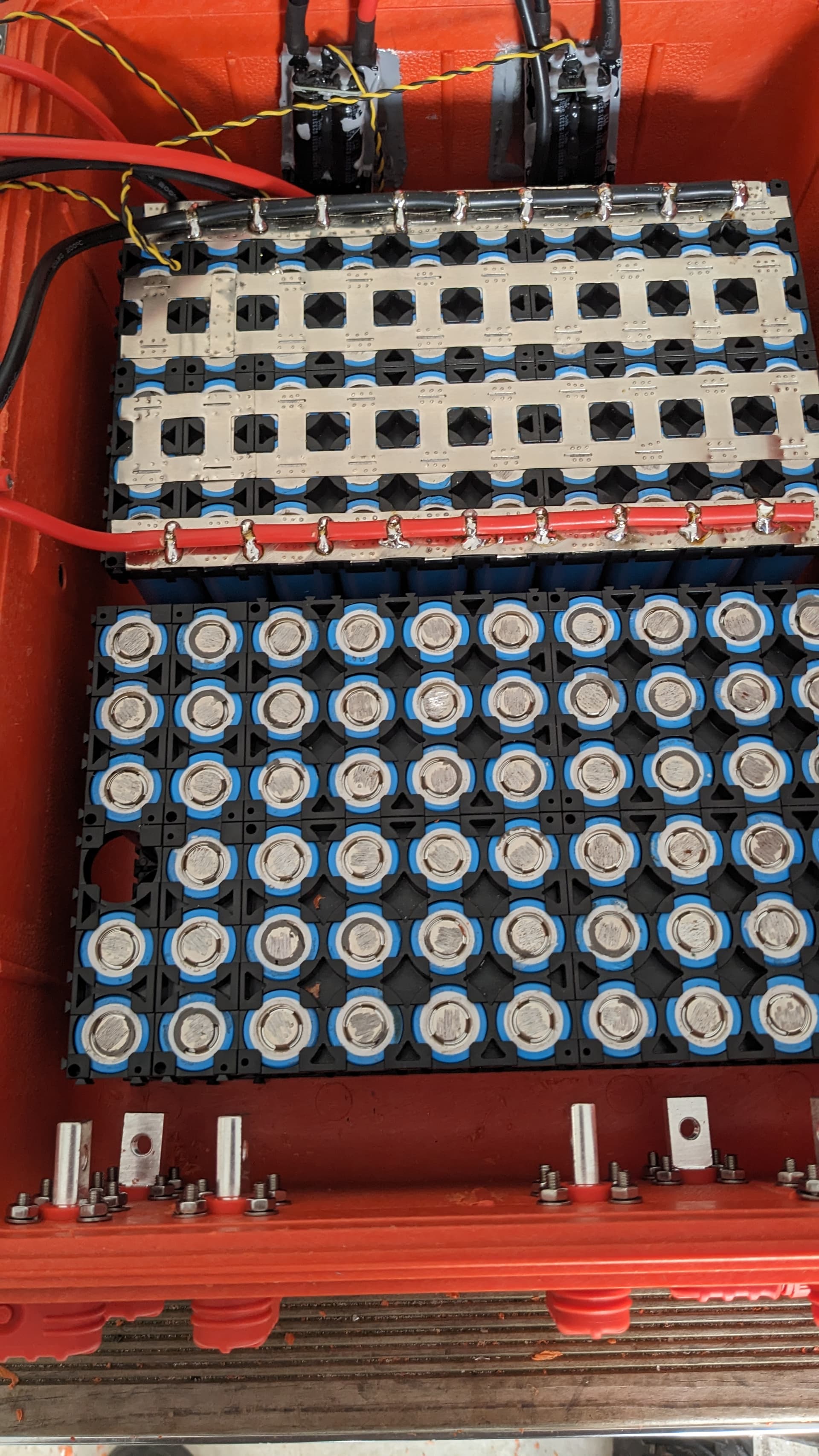

My second set of 12S11P (2× 6S11P serial) has the same issue as the first one.
Reminder: No BMS, just balancing charges.
When I go until the reasonable deep discharges (3V), one serie drops under 2.5V.
Any reason related to the design ?
I do not think it is a good idea to go below 3.25V under load ever.
Li-Ion at 3.0V at no load is basically 0% SoC.
The actual difference between 3.0V and 2.1V is pretty much nothing.
