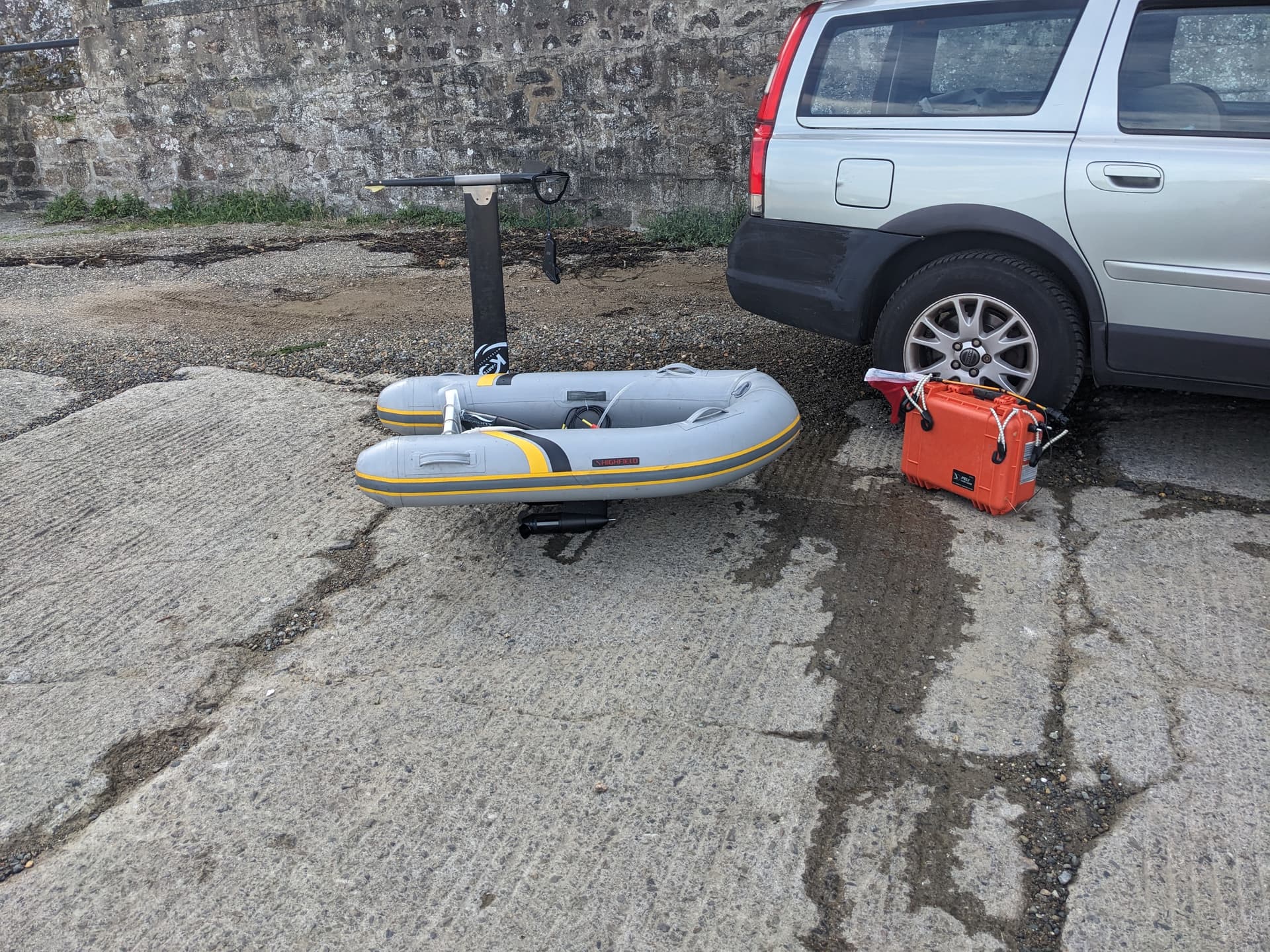

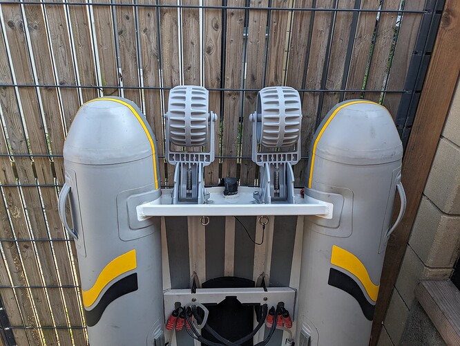

Etienne Dual Motor Tow Boogie

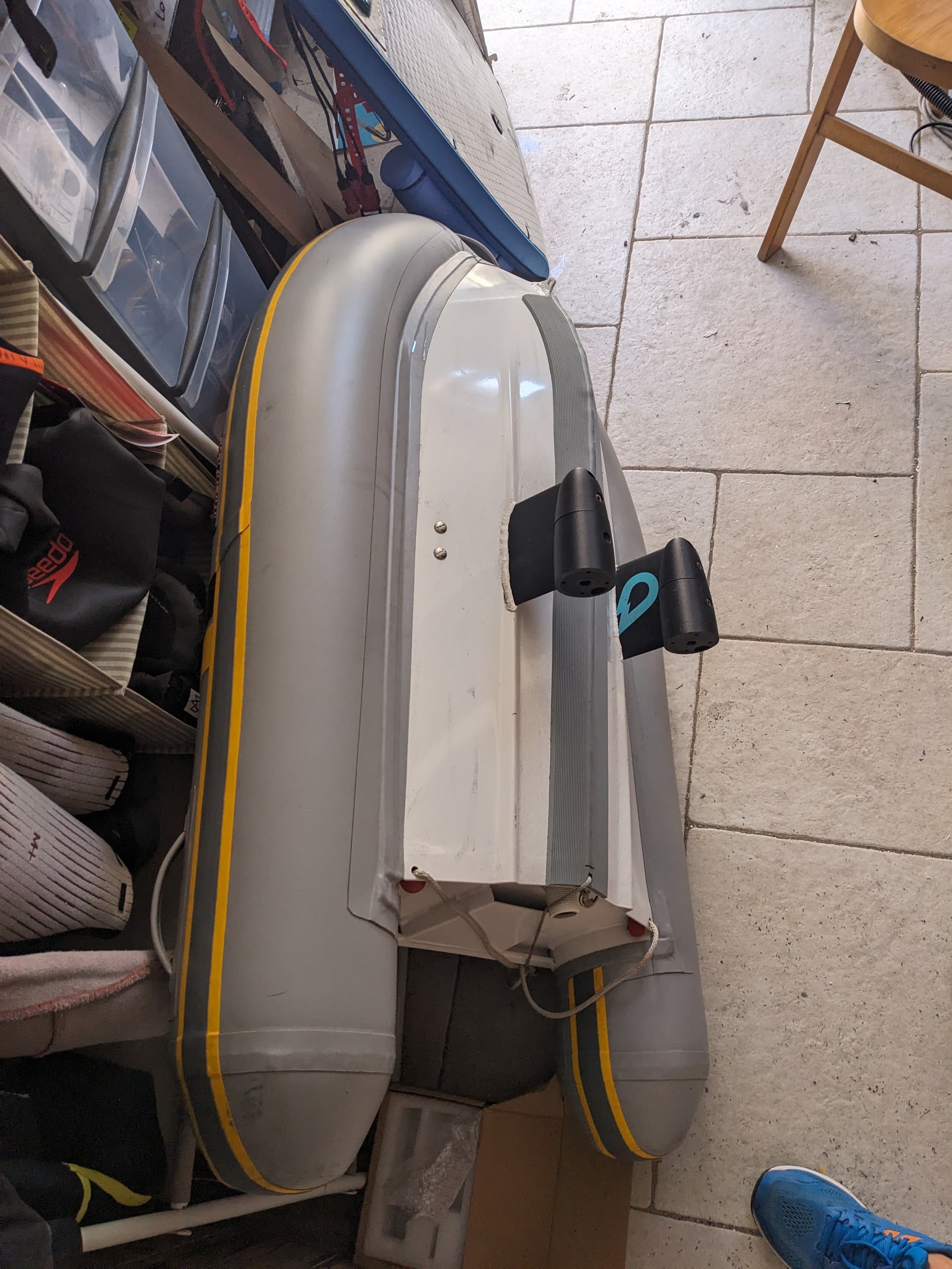

First try today, it’s a crazy how the hull has a better behaviour than my boogie.
Pivot like a zero tow, so smooth, even with lot of throttle no capsizing.
Not to much nose up on take off even with no tow bar
This Dinghy Tow is a real Game changer !!!
Propellers distance center to center 21cm
Propellers center distance to waterline 17cm

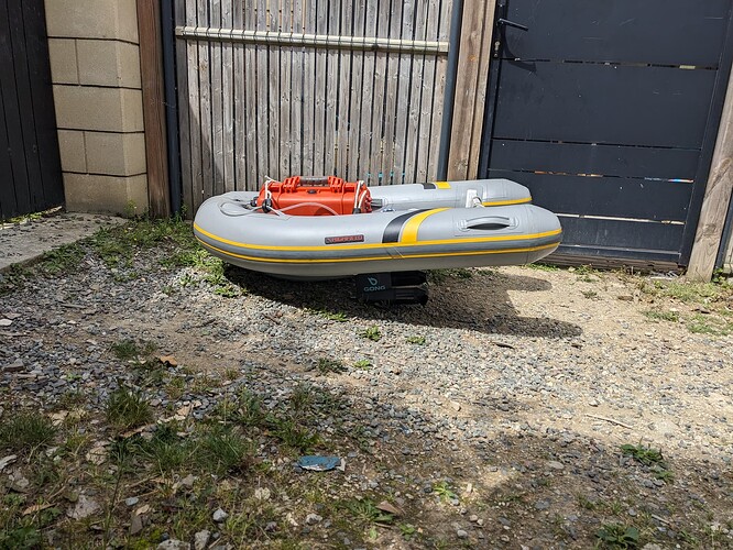

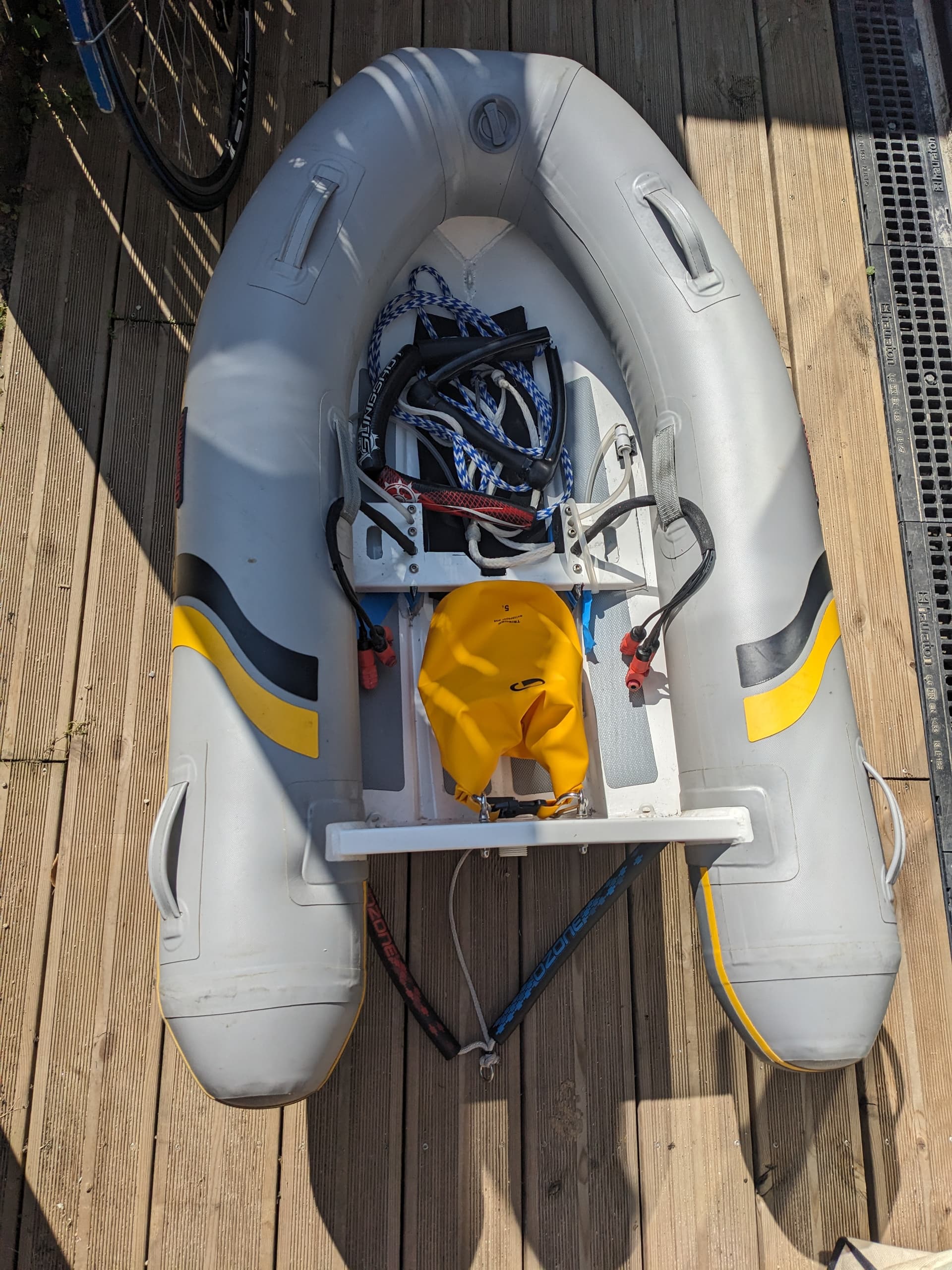

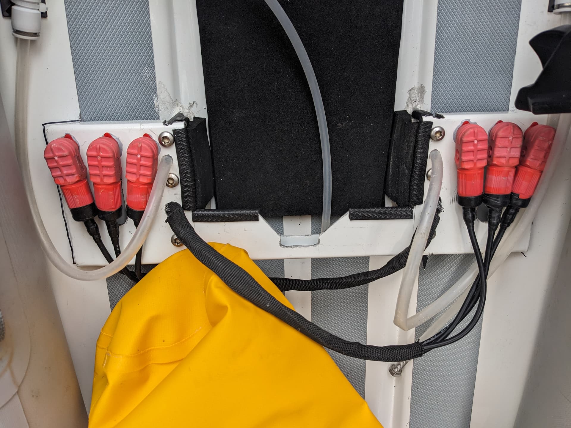

Some improvements of the last days
Filling mast with electrical gel to waterproof gong V3 masts. Top of mast are under waterline.
Stuck the dust protector of amphenol connectors inside the boat to carry it properly
Set a waterproof yellow bag to carry rope and handle + possibility to ballast sea water easily if it’s choppy.

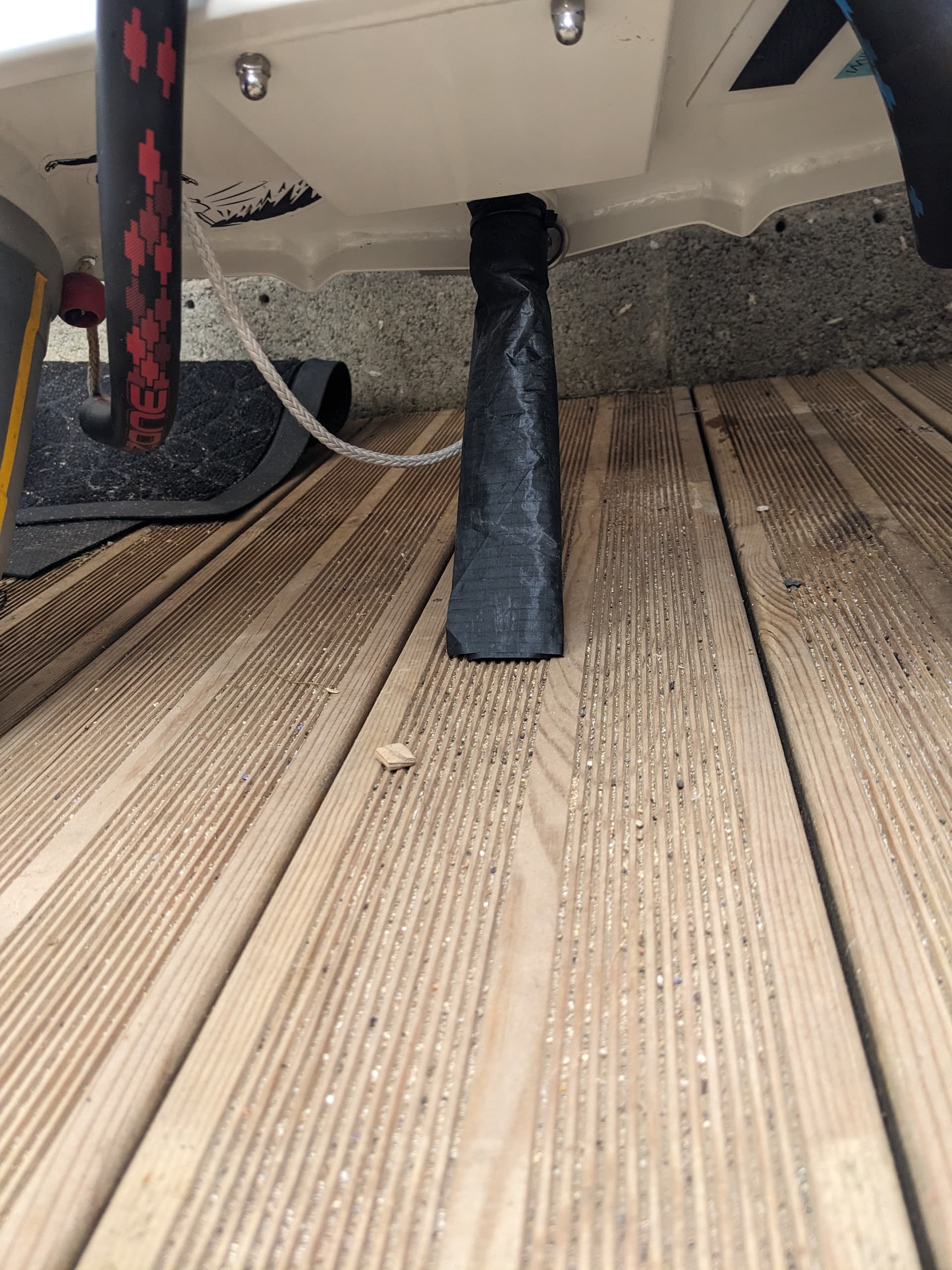

Made a sock to add another water barrier to the non return valve, works like a charm
Next projects: onboard wheels and a cover to avoid waterspray coming in !
I tested to turn with one motor only, compared to my boogie design. Without the extension bar and despite having reduced the distance between pods from 27cm to 21cm, the tow dinghy turns on a dime, the radius is around 5/7 meters I’d say
Here is a weblink to see how the dinghy rides

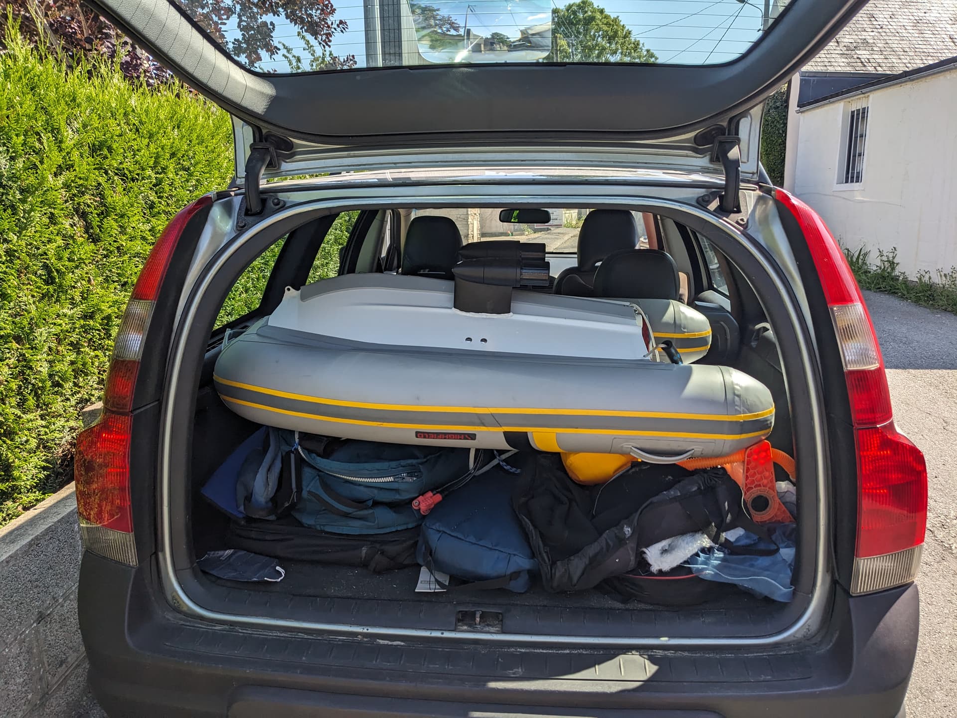

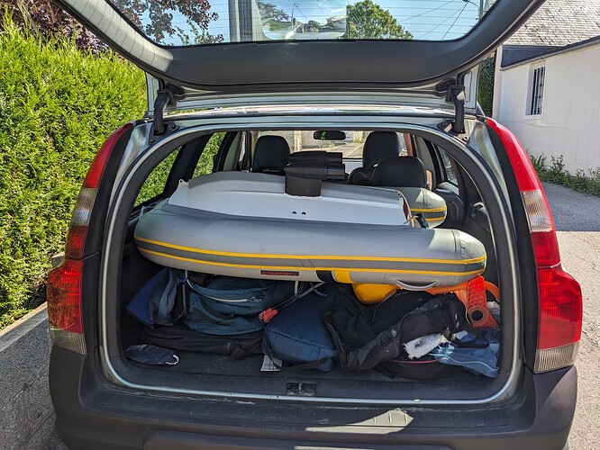

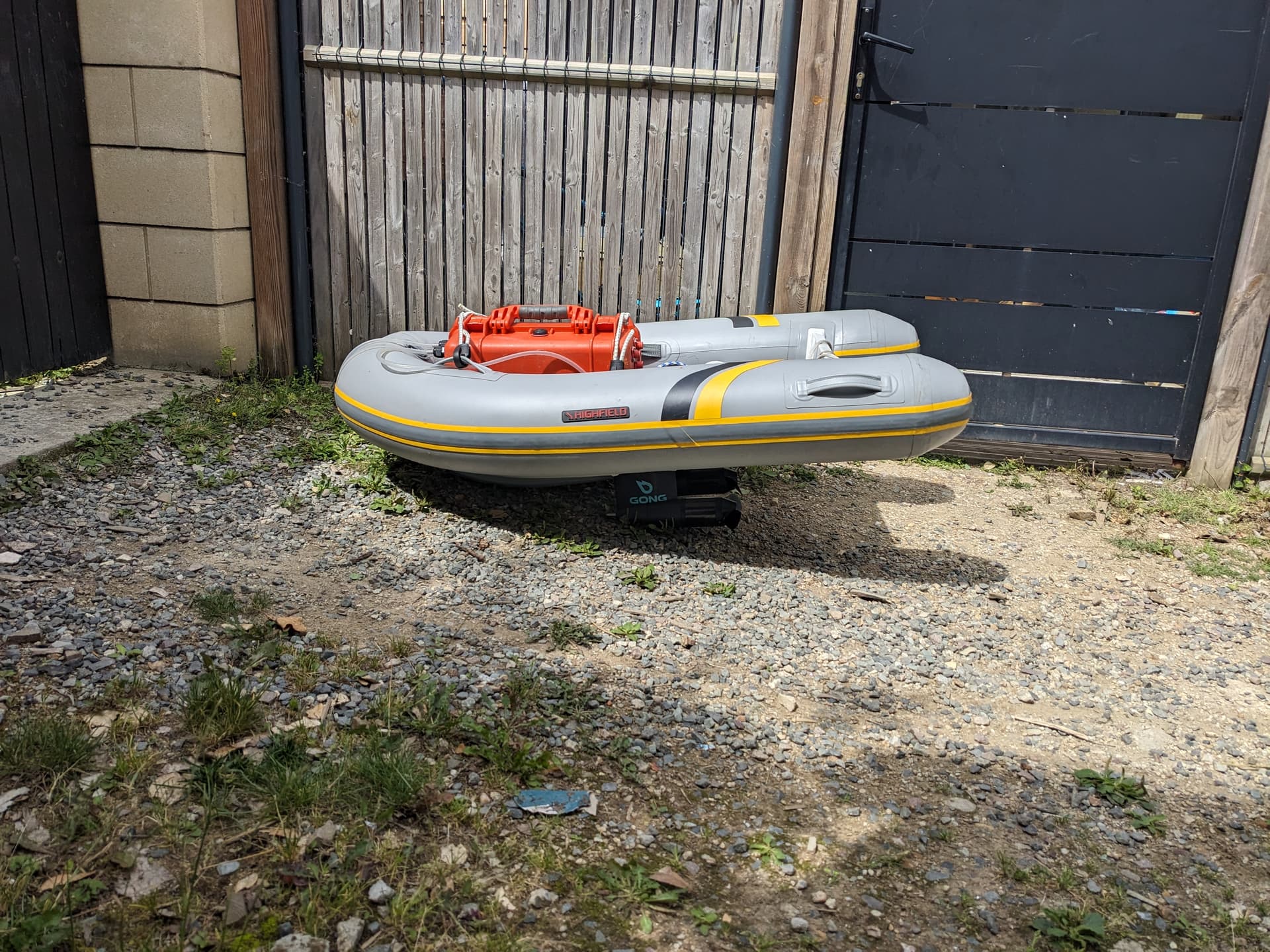

Fine tuning time, here is how I got rid of my huge trolley.
https://a.aliexpress.com/_EwOOcTs
Good lesson of the weekend : Pelicase fell in the water. I was into jumping to dive but it floats perfectly :stuck_out_tongue_winking_eye:
