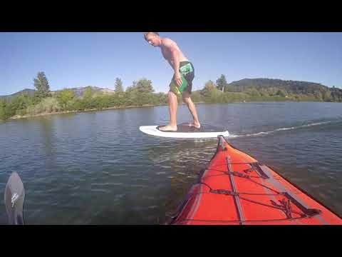

I’ve been doing some more searching, and found the clearwaterfoils.com 2300 wing.
They are claiming that it will start to foil at around 5 mph (rider 77kg)
“3 km/h” (c)
That looks a little bit faster than 3 km/h, but still nice and slow!
Yeah, I think there ~5+km/h, but you could ask him his config :slight_smile:
Currently building one of their foils , should be testing it in a few days
Yes please. Keep us updated.
Is it the 2300 wing?
That music :grin:
