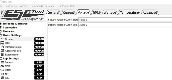

Sorry for potential ‘dumb question’. But can you explain the difference between the cutoff start and end?
To me Cutoff means from on to off. But this rather looks like there is a range where this will occur. Like based on what would I set these values?
Cutoff END is when the VESC sees the value you have set and STOPS. This is the value that protects your battery from going below its low voltage value. IMO this should be set to be greater than the manufactures spec.
Cutoff START is when the VESC sees the value you have set and REDUCES power.
The range between the two values allows you some time under power to return to safety. Perhaps not enough power to foil, most likely not enough power to get up on foil.
Good idea is to create a safe situation to know how much time and what capabilities you have during the reduced power period.
