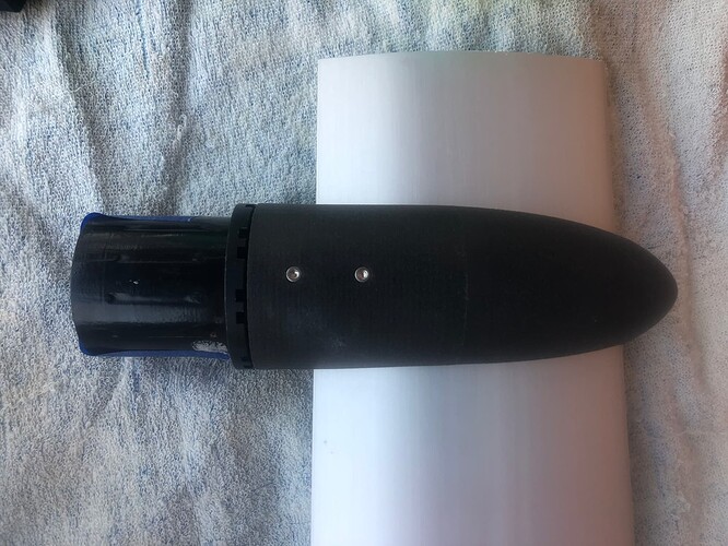

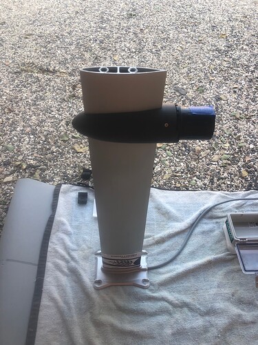

I have a Foil Drive Assist Plus Project Cedrus mast. The mast is 70 cm long and has the motor is in the efoil position near the bottom of the mast. I want to move the motor so the motor center is up high about 6” from the board. I would appreciate any advice from someone who is knowledgeable or experienced before I get started.

Could you place the mast the other way around and reroute the cable?
It’s a shame FD didn’t build the functionally (with a clever cable routing method) into the design.
The 19mm axis mast is probably better suited as it has quite a large cavity in the middle.
I have one regular foil Drive assist plus and use it for surfing most every day. Before I bought this PCIM, I watched YouTube videos in support of using this version for surfing. I am now reasonably good foil surfer thanks to my FDAP with motor 6” below the board. I feel thus PCIM with motor in efoil position is a poor choice for surfing. I live in Mexico at a surf spot. Any prospective buyer wants a FD for surfing. So it has no local sales value unless I misrepresented how it works for surfing or ship it away and spend a ton of money to get it rebuilt. Like many foil addicts, I am broke. I could try to sell it used as a minimalist flatwater efoil kit. I’m afraid I will have to lose at least $1,000 on the sale for a sale to happen. I find I like the idea of modifying it to high motor myself compared to any other options. I have no need for adjustability. I love surfing. I know just where I want the motor. I think it will be even better than my FDAP after it’s modified. My plan is to modify it, care for it well, and use it forever.
I heard about that flipping it idea. Then I measured it and figured out how close the prop blade tips would be from the power cable. I think about 12mm. I like the idea of patching the existing hole and sand ing it smooth with the mast contour better than having my prop blade tips 12mm from my power cable.
I paid lots of money for this PC mast. It has a beautiful base plate with power cable sealed and exiting in the wake of the baseplate. I see no sense in changing to an Axis mast.
FoilDrive has presumably spliced the three motor wires inside the mast or in the base plate track somewhere. Doesn’t look that hard to pull it apart to shorten the cable and put it back together. Would be worth asking FD for some tech support given you are a loyal customer. Good luck.

Depending on what you have available to you tool-wise, its very easy to mod and change the motor position. I’d start by flipping the mast though as then you can just use tape or a carefully placed sticker to cover the existing hole.
