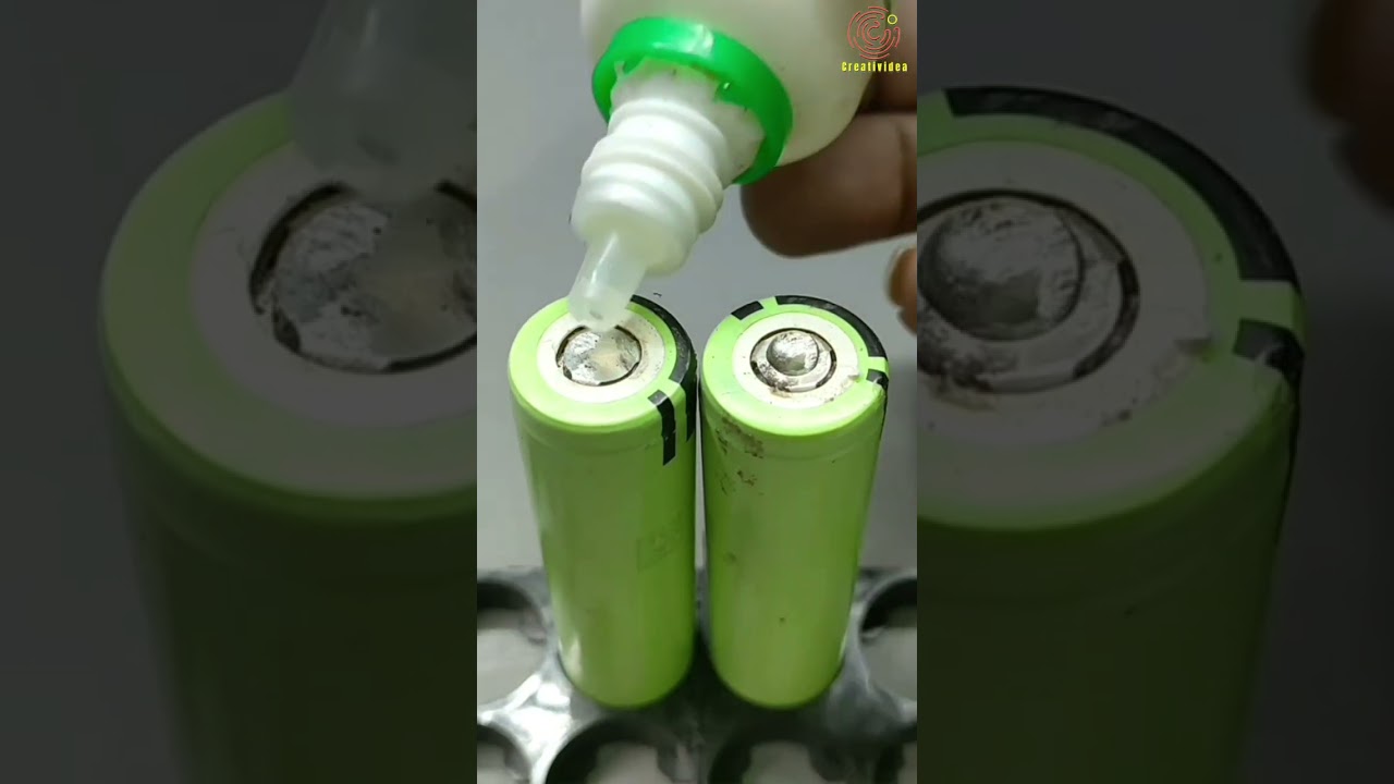

Old debate, spot welding or soldering, here is a short about how to solder not only 0.2 or even thicker nickel strips with pre-separate (=minimum) heating for cells and strip. For cheap.
Channels to watch:
