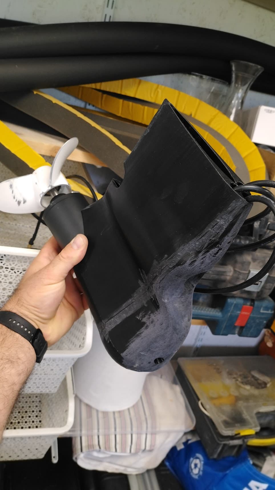

Hello Flo98, I burnt the motor, overheated. probably my fault I designed a mounting sleeve that reduced passive cooling
oh sorry for your loss:( i see if it’s 3dprinting, it may reduce cooling of the motor… Do you still use the Firduo VESC? Is it waterproof?
