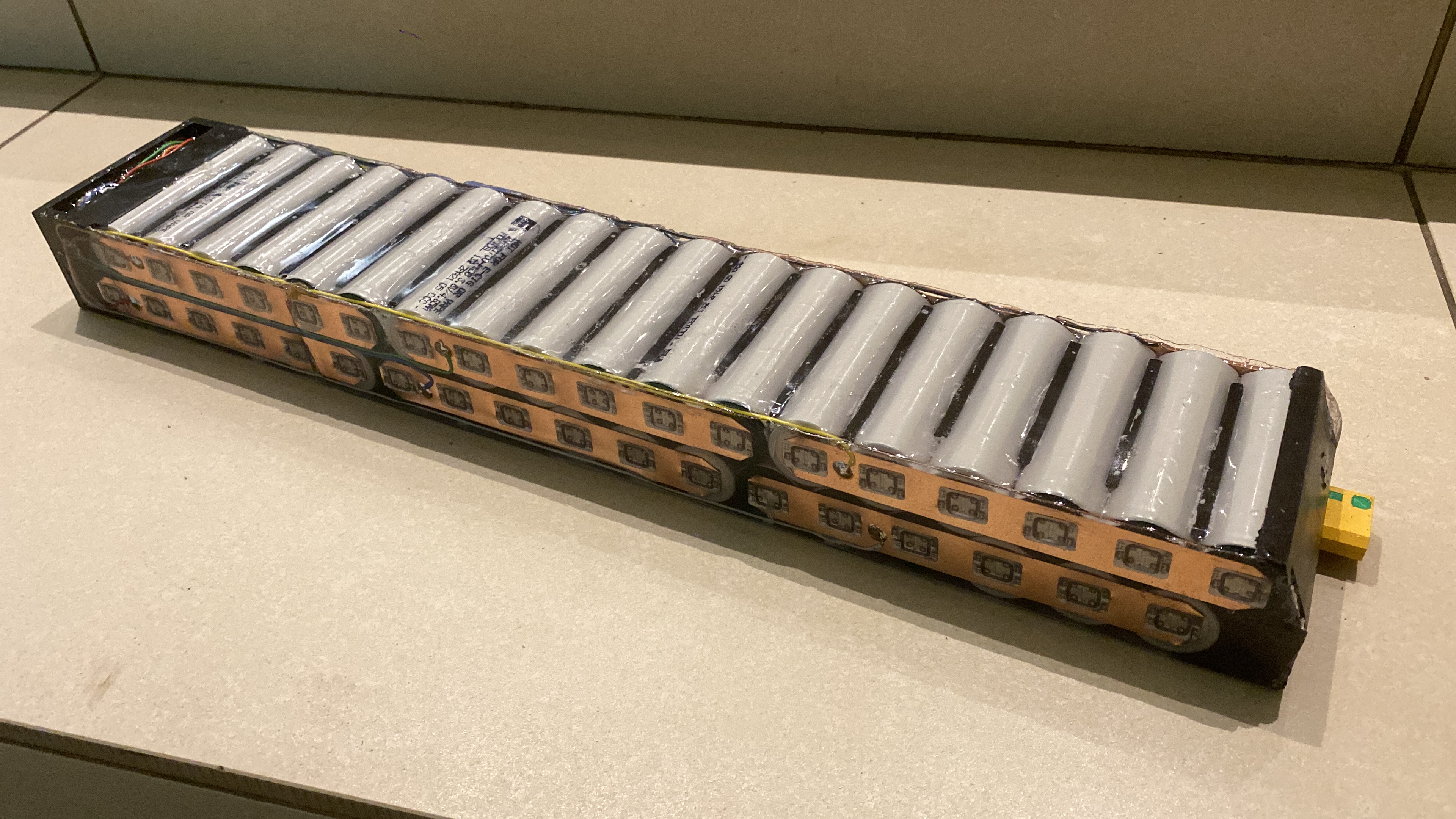

12S3P with external balance connector, needs a little sanding but fits in my unit straight from the mould taken a few attempts to get this far.
P50B Molicels
Nice! By “unit” you mean you can use it with a foil drive?
Was that a silicon mold?
A 3D printed mould lined with packing tape then cast in epoxy it released ok but the mould is one use only
It will fit in a FD with a custom nosecone but I made my own version of a under board system
Went with the clear epoxy so I can keep a better eye on the welds etc.
For a multi-use use HDPE. There’s a bunch of online tutorials you don’t even need release agent.
Nice work. Clean pack, and getting the fit right is half the battle.

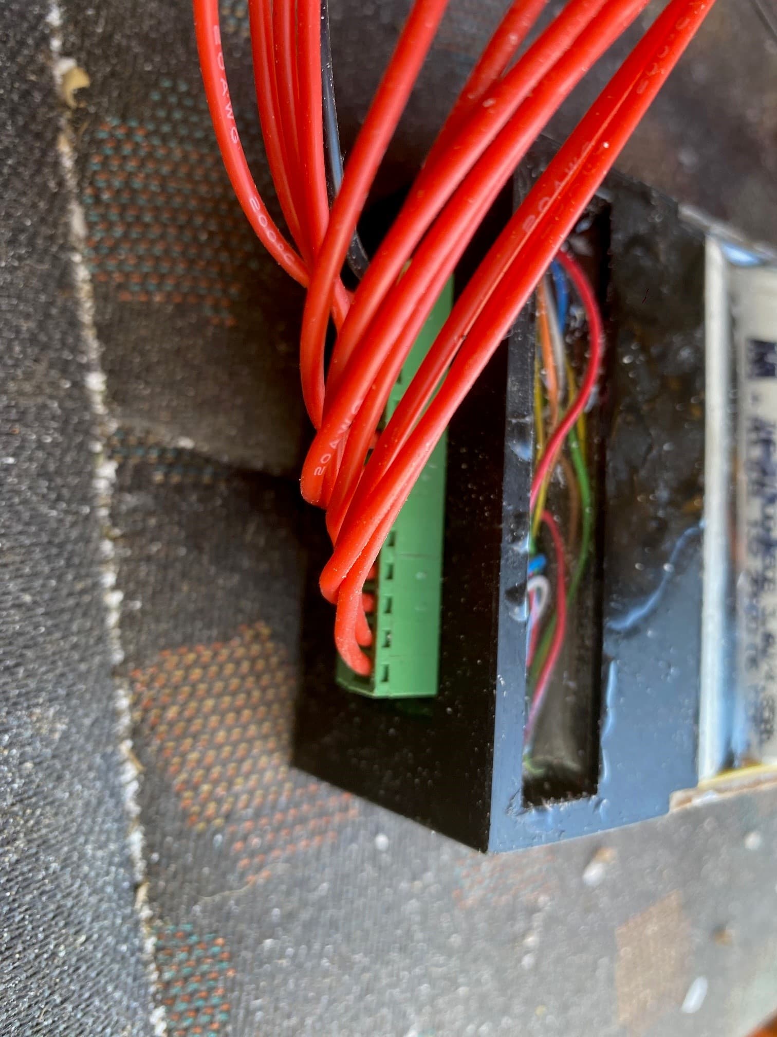

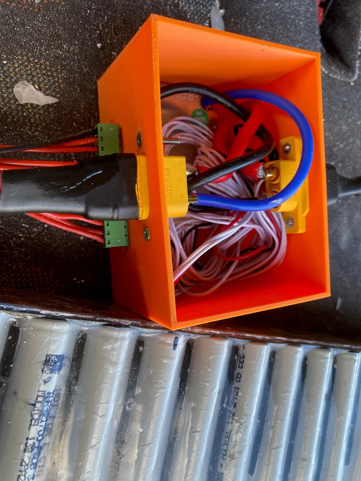

Yes, they made it with very small tolerances, mounted the BMS in a external box to make a cheap 12s charger.
