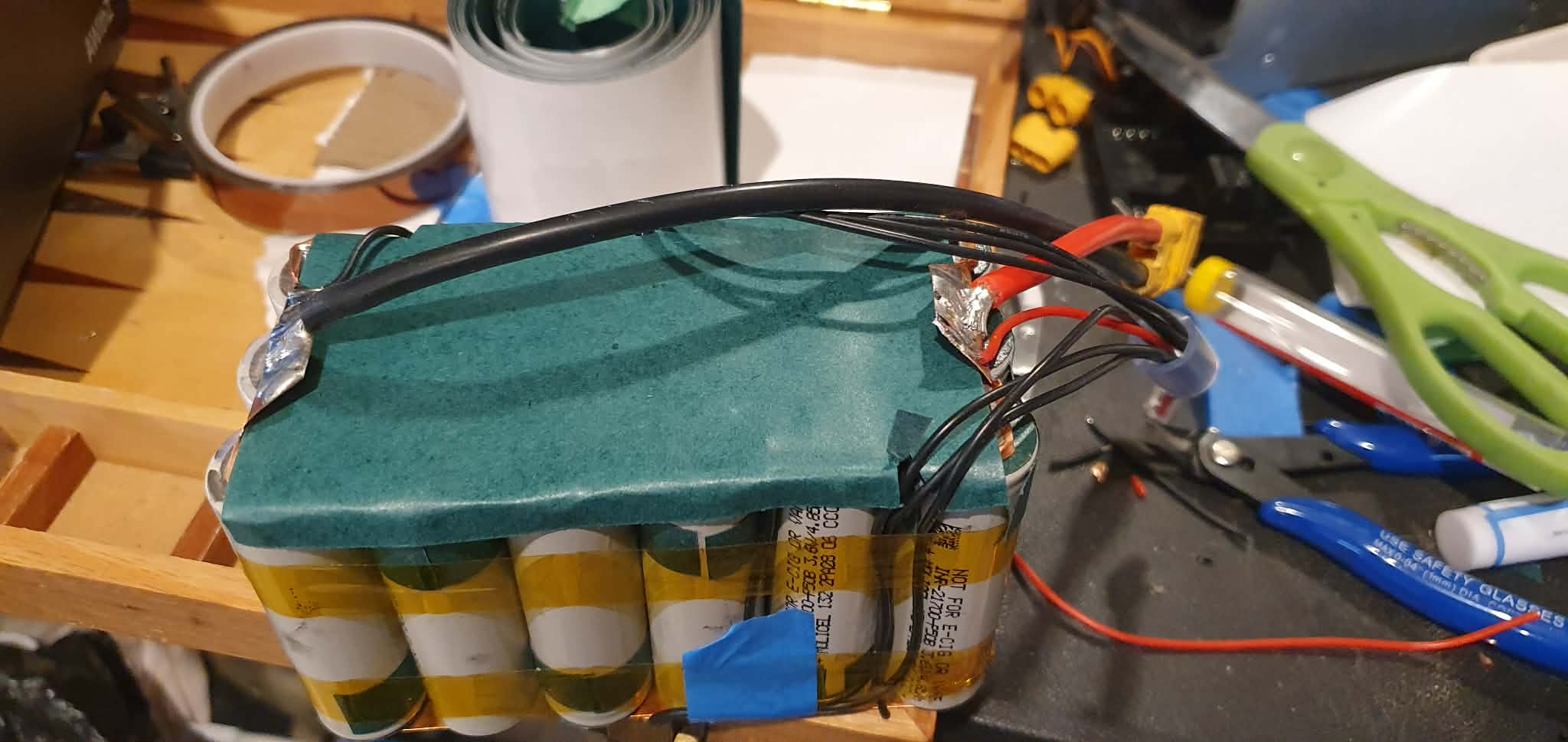

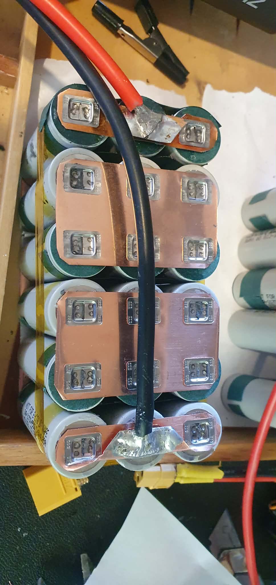

List of components, Flipsky 6384 140kv, Flipsky 75200 V2 Pro, Kparts 3 blade prop, Kparts motor mount, 2x 6s3p molicel p50b battery in series, 2x 6s2p molicel in series, 4x 6s1p Ampace JP40

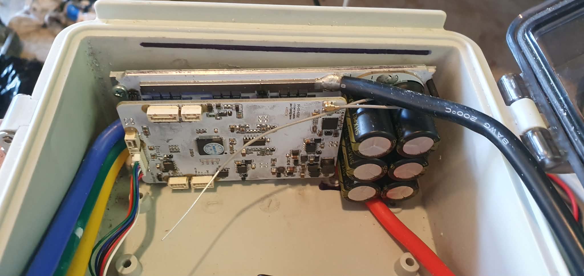

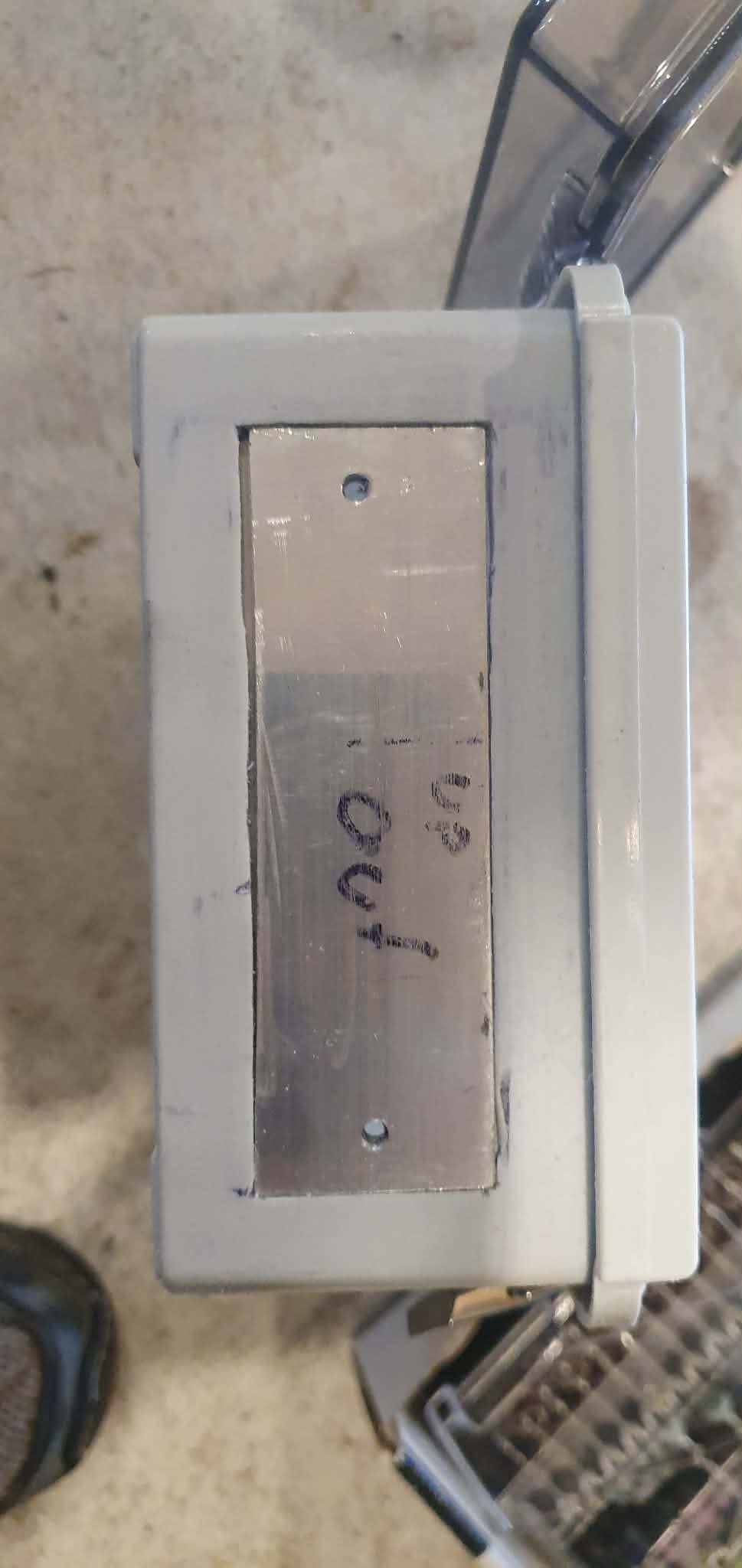

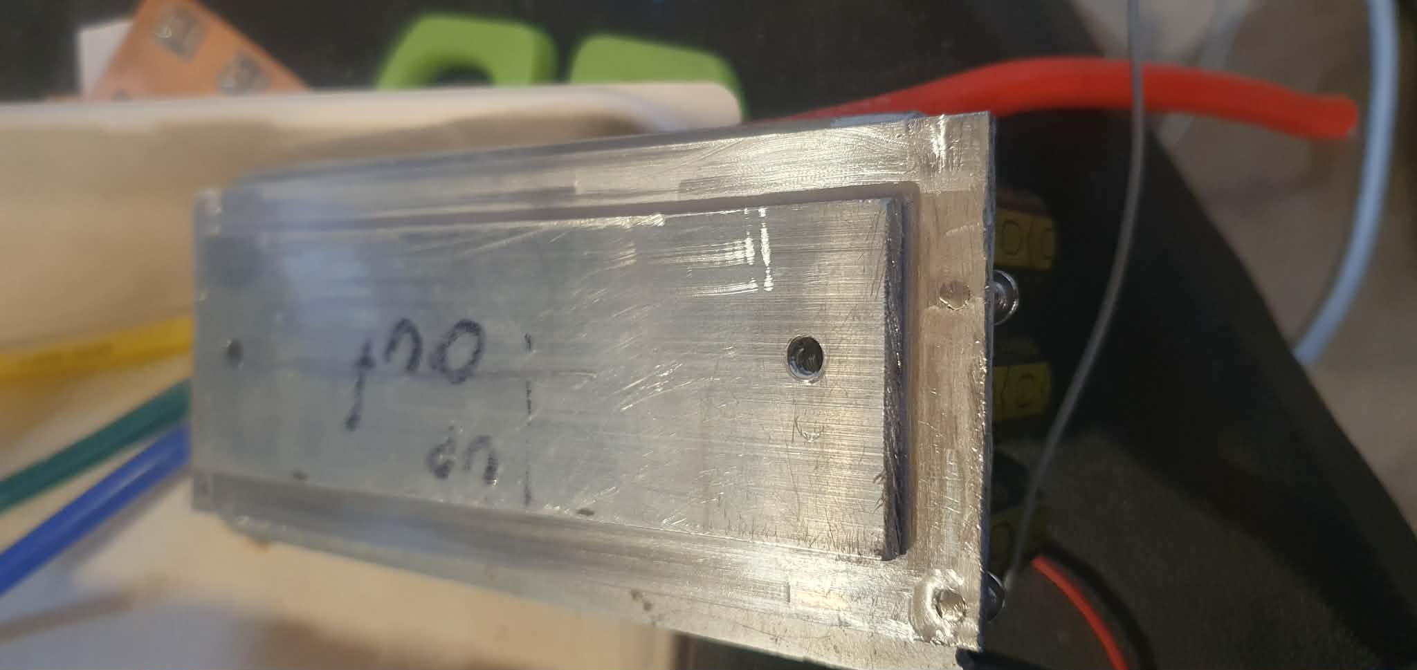

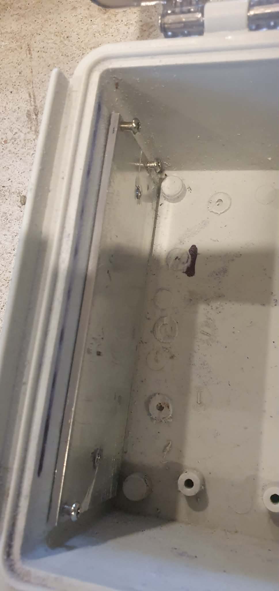

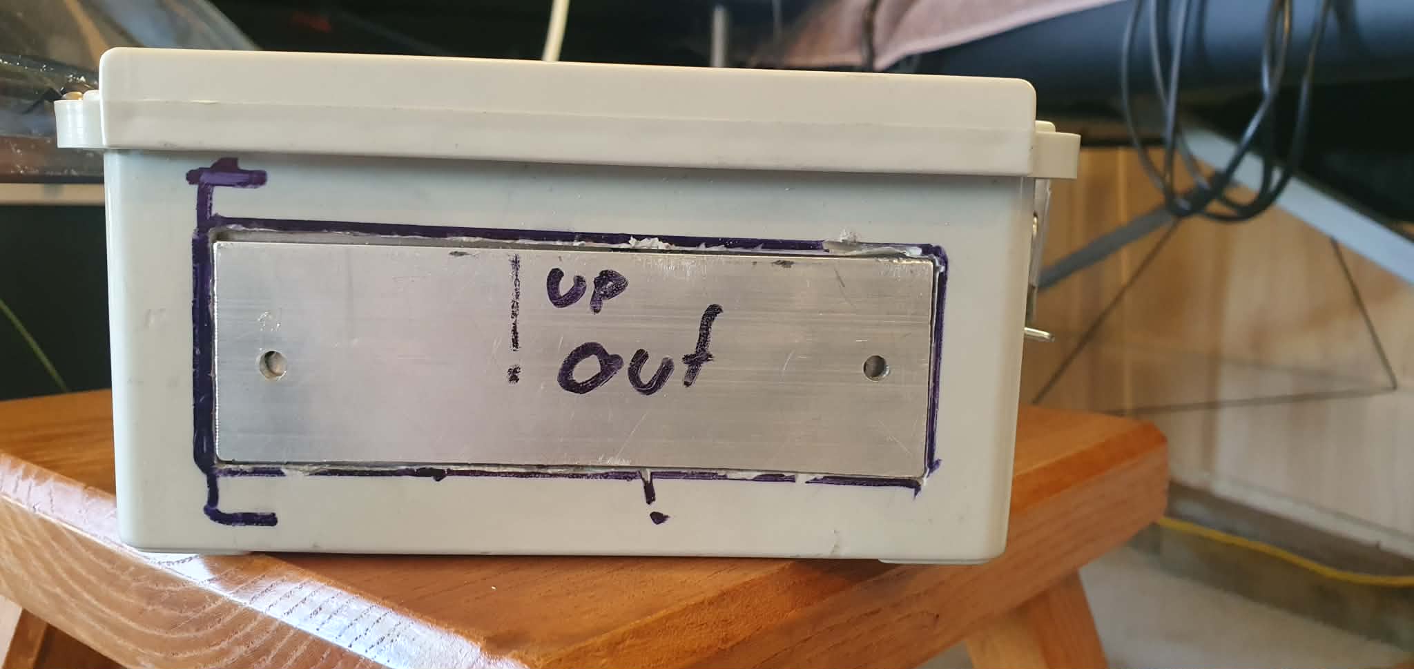

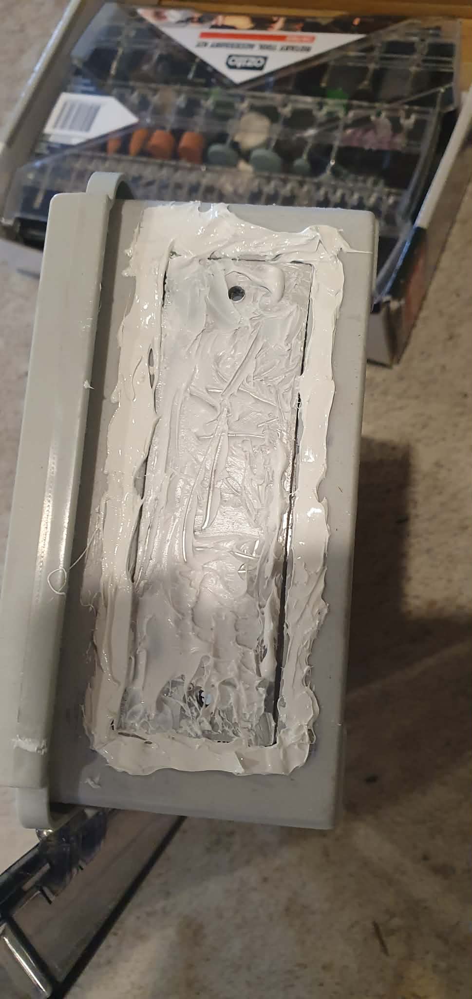

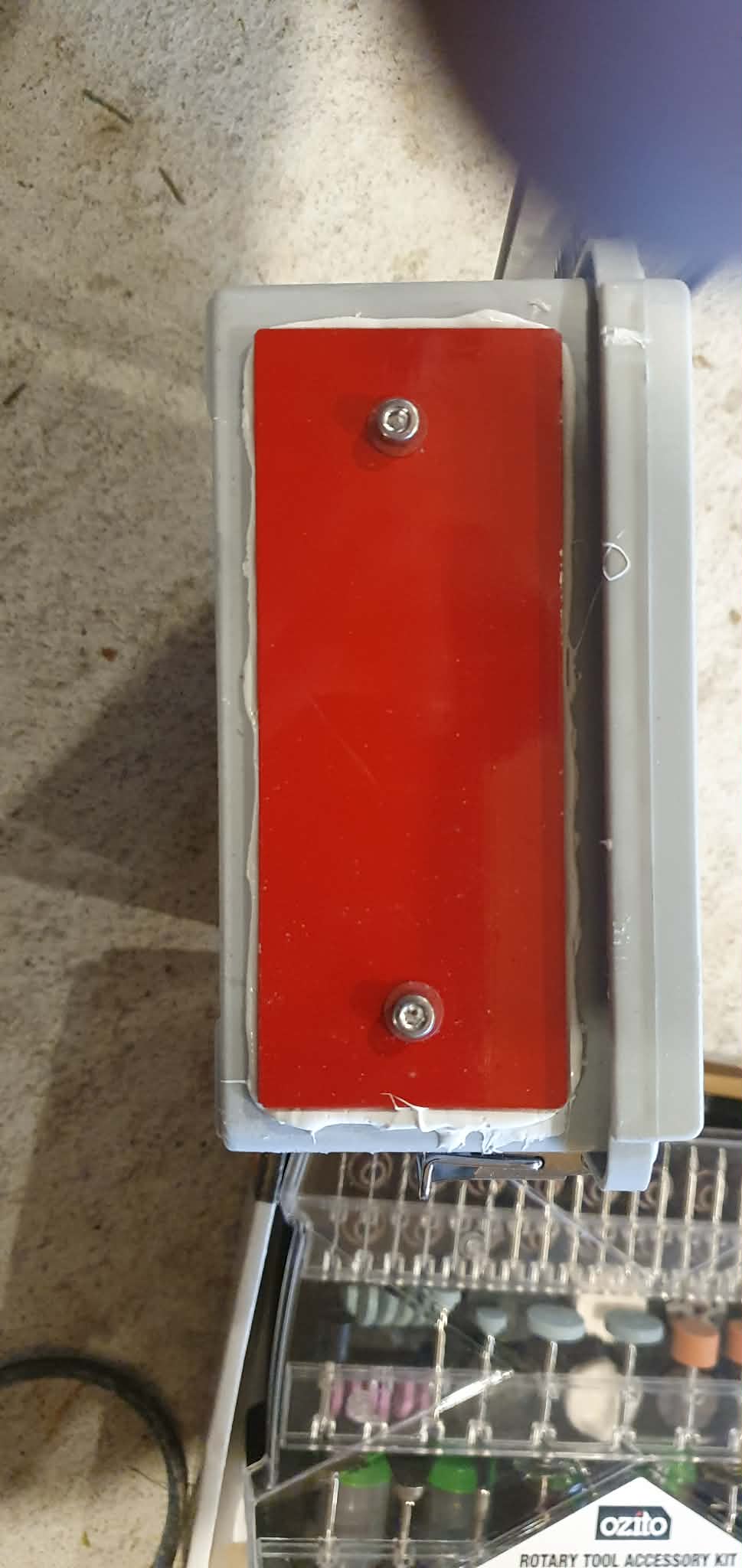

Some pics of heatsink

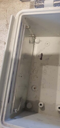

Next step is to install cable gland designed by @JonathanC many thanks :grinning_face:
Aha, you can remove the pcb from the heatsink on the 75200!! I thought it was bonded in place with some sort of white epoxy or polyurethane. That makes a big difference :+1:t3:
