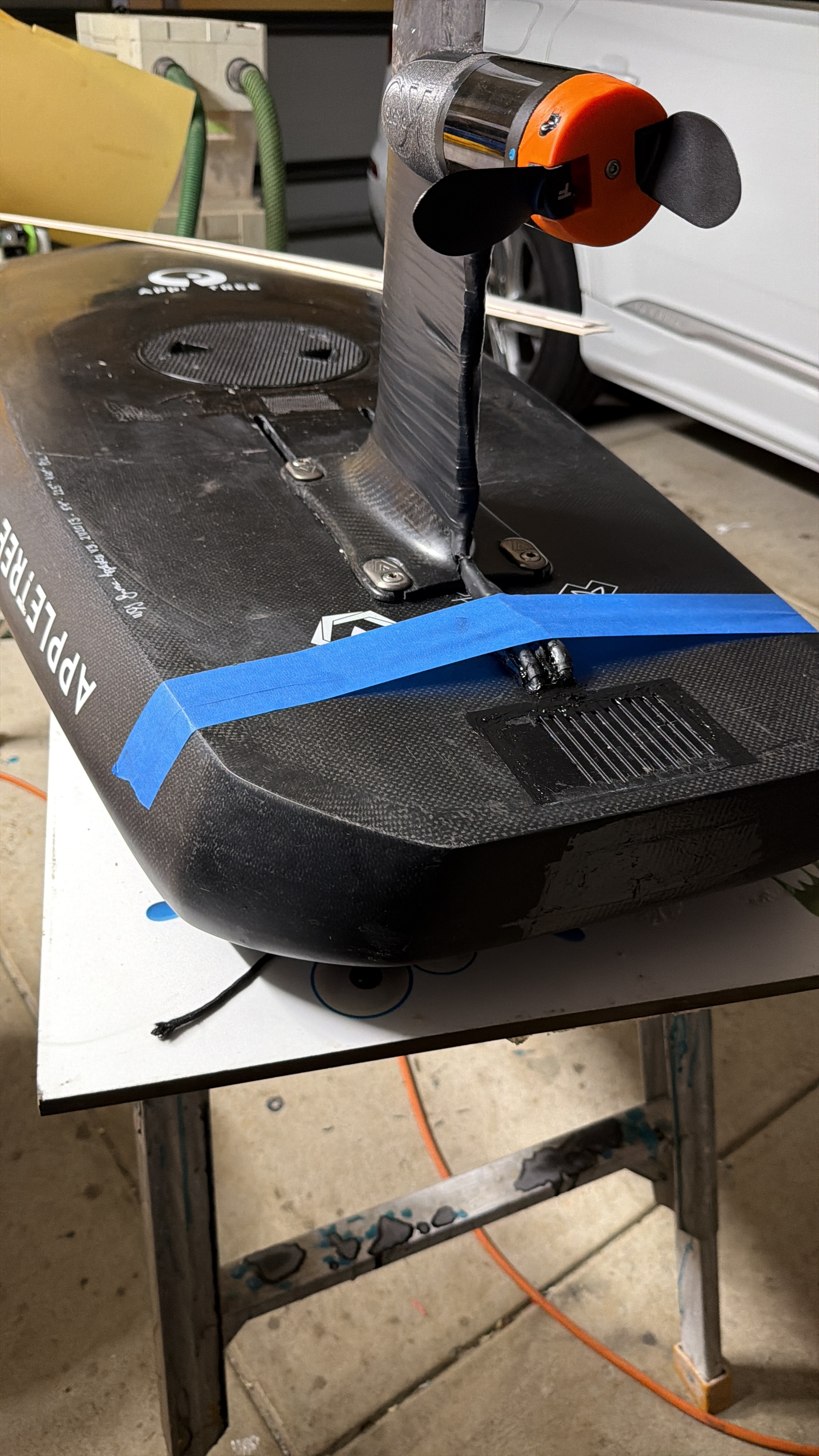

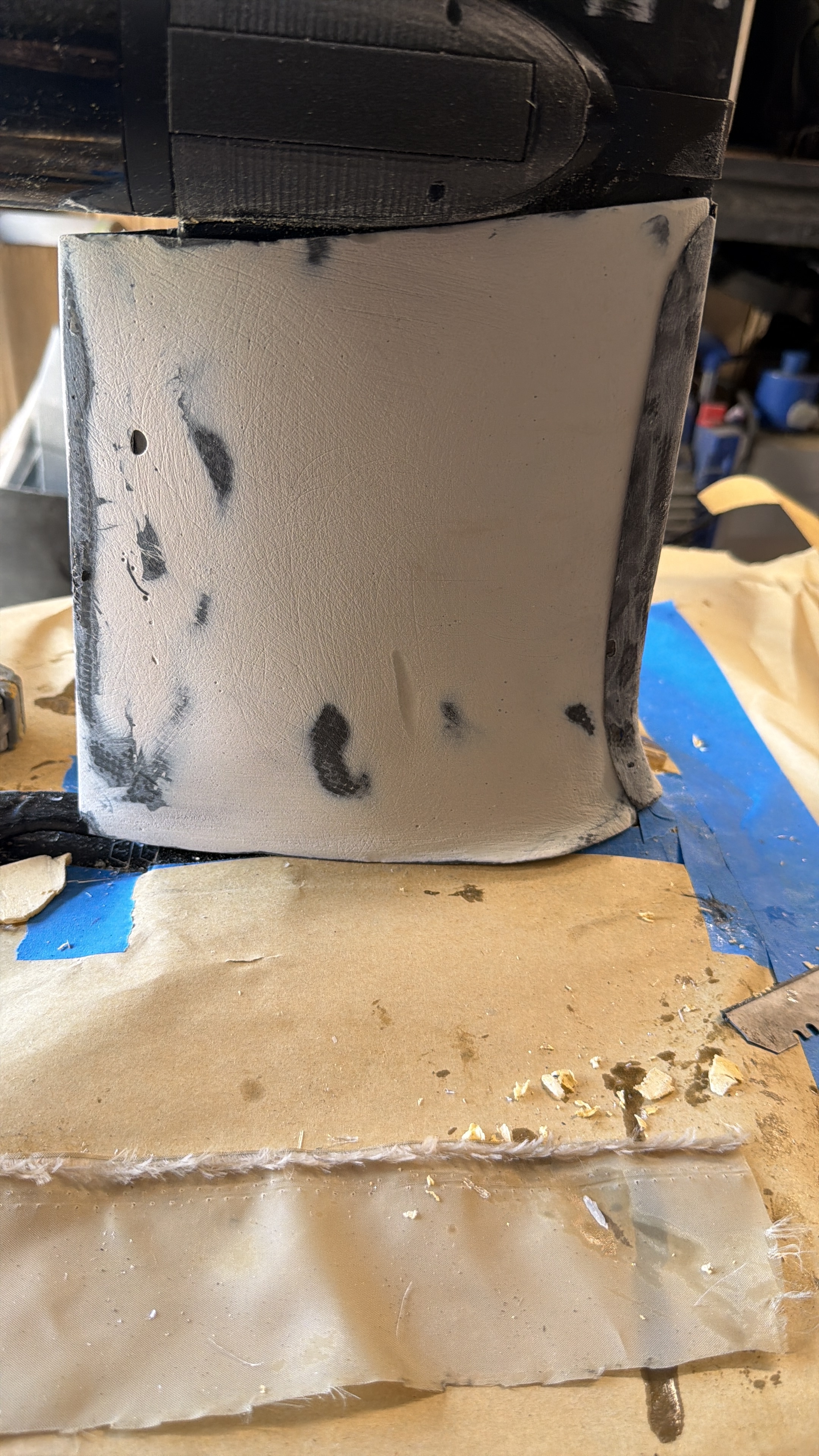

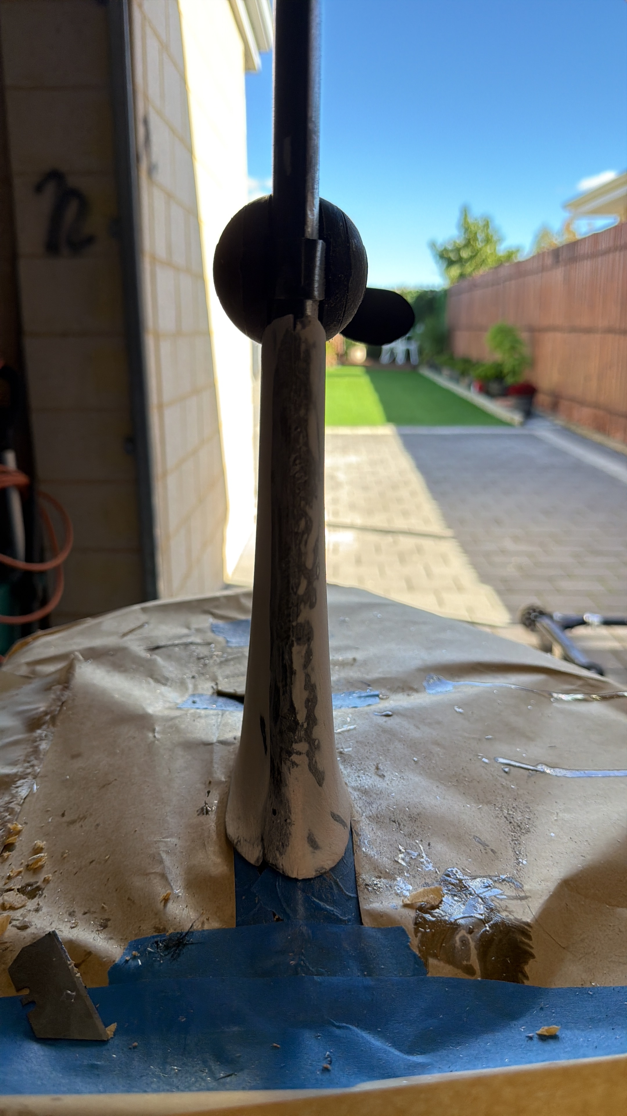

New update to my assist. Got maytech waterproof 150amp vesc and imbedded it into my board and just working on sleeve for wire guide. Yet to test to see if my settings will work
