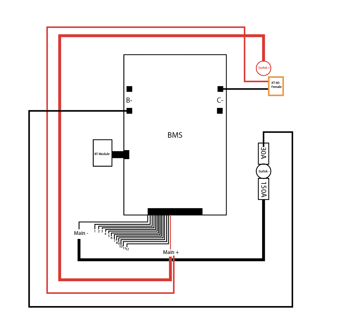

Hi All,
I am building a E-foil board and it is all going well so far, I’m looking for a bit of battery advice I have already purchased two 2.07kwh Samsung batteries that are used in many EV cars. My plans are to wire a BMS into each one for charging and bypass them for discharging I am going to use surlok connectors for the Main battery leads and have a XT-60 for precharge and charging using a Wate charger. I am using a FIRDUO Manatee100 VESC so I will set this up so its looks at the batter voltage and reduces power before shutting it off to protect it. I am going to connect all the balance leads with ring terminals because the battery works nicely for that. My main question is about fusing the batteries to protect the discharging and precharge, I am using a Flipsky 65161 motor so I am thinking 150A for the main 25mm2 cable and 30A for the precharge, my main confusion is with the placement of the fuses everyone has different opinions by the sounds of things I have drawn a wiring diagram with them on the negative side but all advice appreciated.
All my parts I would be happy to change if it makes a difference to safety (inc battery BMS etc)
I’ve linked my BMS here I have the 12S li 30A with BT: https://www.aliexpress.com/item/32819508078.html?spm=a2g0o.order_list.order_list_main.17.4ab41802qwV76W
Many Thanks
My Wiring Diagram:
