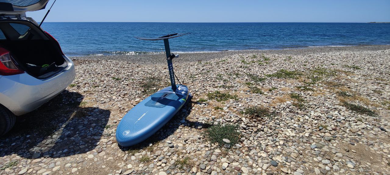

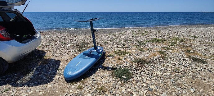

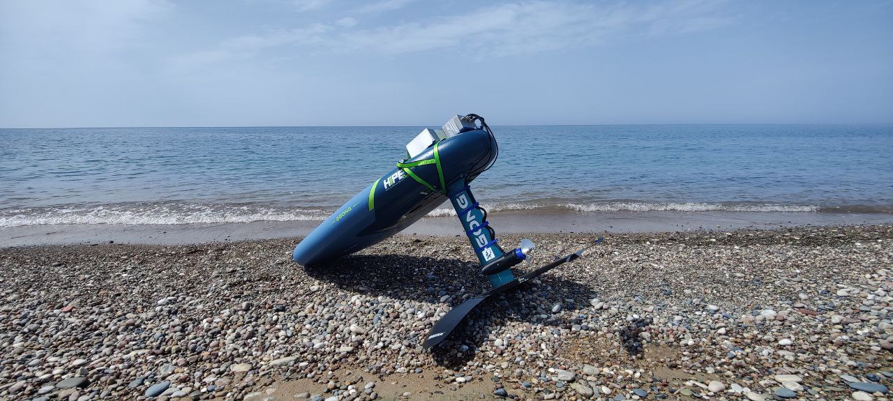

Hi, today I tested my first build. Flipsky 7070 engine, Flipsky 75200 esc, GONG 105l inflatable, foil GONG 1400cm2, mast 85cm, battery 12S6P 21700, boat prop 6". My weight is about 75kg. Tried to increase max phase current to 100A.
The maximum speed was 10km\h only. Battery current 40-45A max, ESC power - about 2000W max.
P.S. I have wing foil experience, this GONG set is my main setup with wing.

Also, the motor mount would probably benefit from a more stream-lined cover in the front
Yes, I have motor cover but didn’t mount it this time.

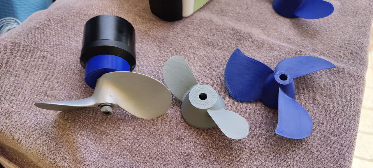

I have printed another smaller prop.

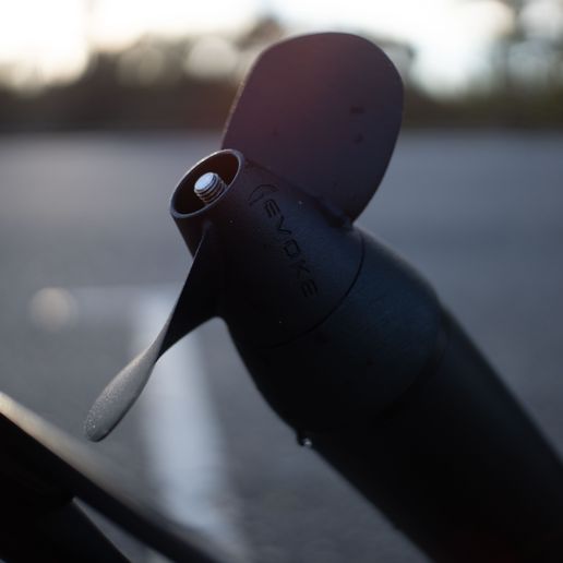

Trying a different prop and the cover should make some difference for you. Also, and if you have wing experience I’m sure you know this, but trying to take off with the wind at your back will make things easier.
I’ve had good results with this prop made by @kevintran:
(though I use it with a 65161, could still work on a 7070 motor)

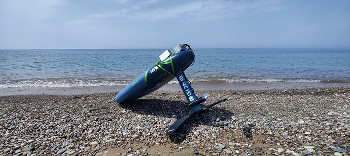

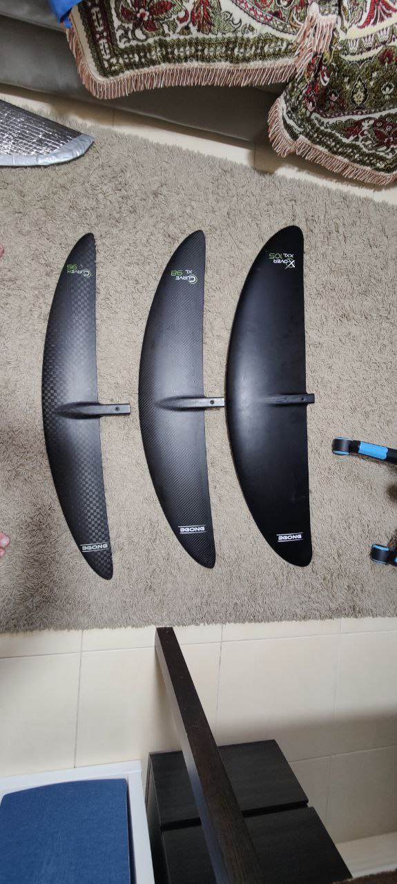

Today I tested my setup with 2100cm2 GONG foil and 55cm mast.
I have tested 3 props and took off without any problems with all of them on flat water. Battery current required for takeoff is about 45A and 20-25A - to flight.
Max speed is 21km\h.

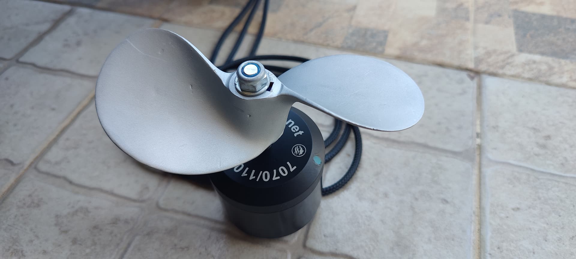

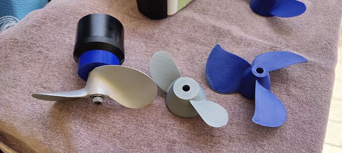

Prop #1: Thai 6" aluminum balanced prop, from ozon. Easy to start, smooth with good traction.

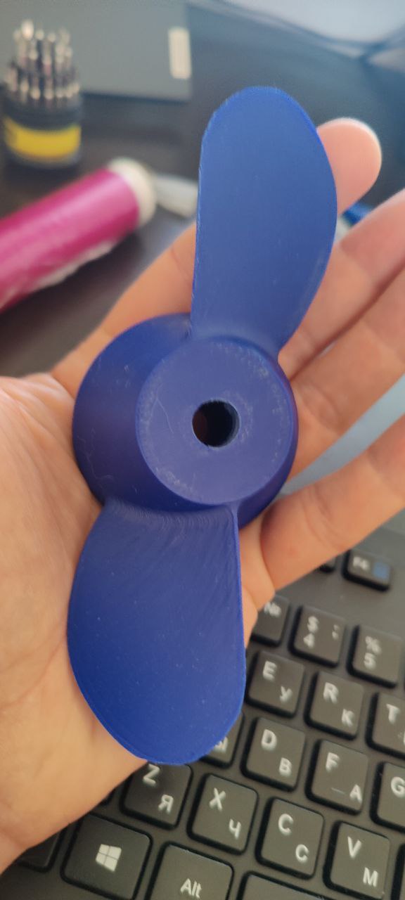

Prop #2: Printed model from this site 138mm. Easy to start but hard to control speed.
Prop #3: Printed true glide model. Bad start, not good for 7070.

I have successfully tested GONG 1400cm2 front foil - it much better than the first 2000cm2 wing.
