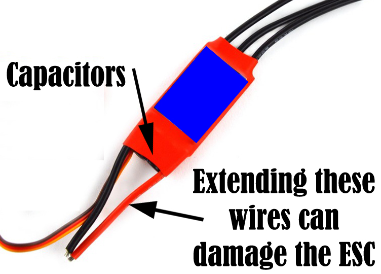

Your wires between ESC and Battery are very long. You should keep them as short as possible, or use some big capacitors close to the esc.
Thx for the tip.
The wires are 6AWG. And my battery is 14s. I haven’t had any issues. I did the math. Less then 2% voltage drop at 150 amp load. I think the guys who have problems are running smaller gauge wire, and or a 12s battery, and or Lipo cells that struggle with the load.
I’ll let you know if I have any issues.
That’s not about voltage drop but inductivity
Hi
Thanks for the further explanation.
If you don’t mind, could you please explain further?
Amps, voltage, watts. The ESC pulls less Amps at higher voltages in order to supply the needed watts. If wires are too long, or not large enough in size the Voltage at the ESC will drop causing a spike in Amps, loss in power, and extra heat.
Long wires of large gauge can provide the same values of short wires of smaller gauge. If mathed out to be equal. Capacitors at the ESC are basically batteries to help regulate the spikes, and lulls as load varies quickly correct?
I agree the goal is to have as short of wires as possible. Which I think I have for all practical purposes I have achieved.
The battery I built is 14s14p, all 6awg quality copper wire. It can supply 280 amps continuous draw, I don’t have the same voltage drop / spike issues others might run into.
I am open to learning and improving my build. I appreciate your feedback.
Electrical Reactance
I have an electronics background so I can relate to this WIKI.
It can be complex but I remember the first thing that was thought to me about electronics was “OHM’s Law” Than all other to follow could make sense.
Something to consider. Wire size affects resistance, frequency can affect inductance and capacitance. Capacitance and induction is kinda on the opposite scale but can affect overall impedance (virtual resistance in a circuit). The right combos will lead to efficiency, and a bad mismatch leads to inefficiency and danger.
I think this explains it quite well.
