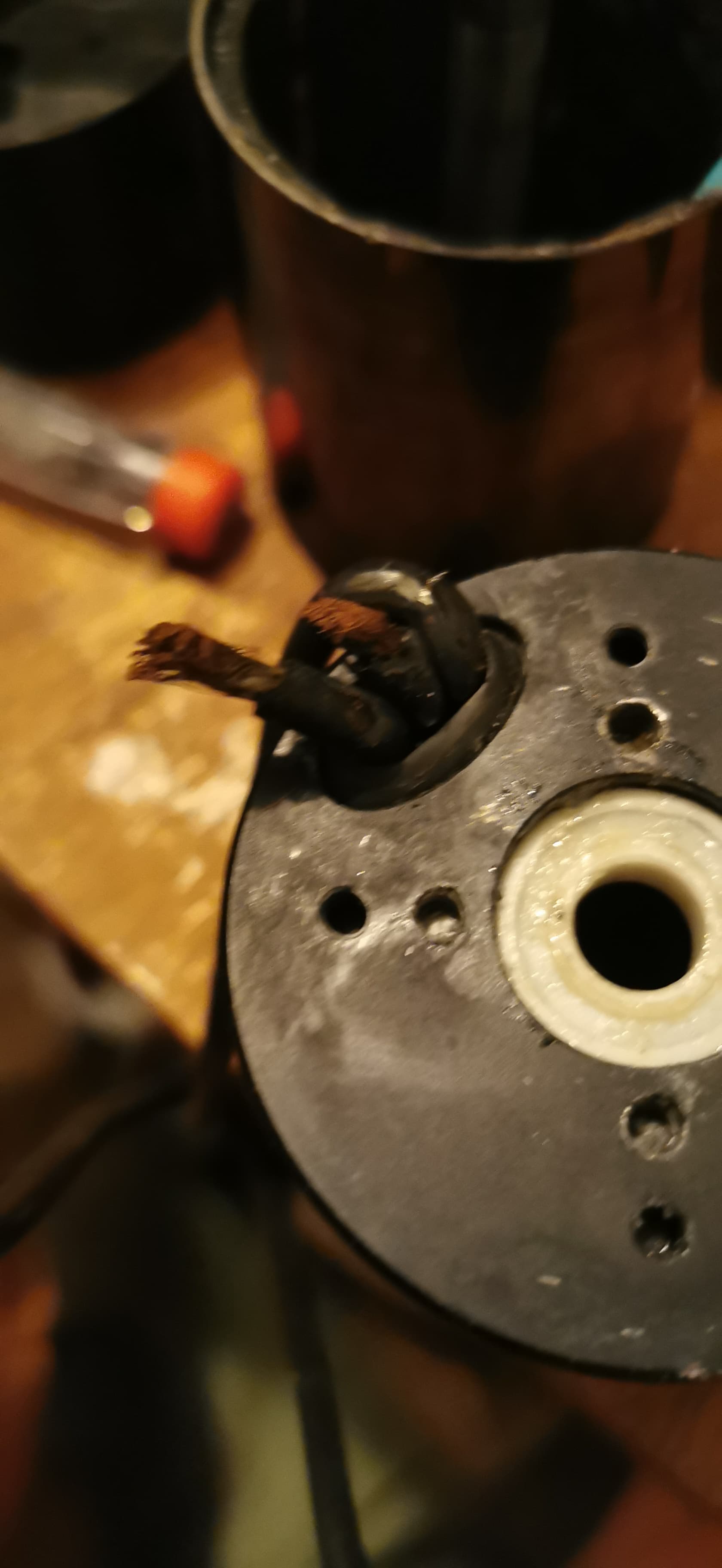

Hello, what the best to way to change the 3 cables direct at the motor? corrosion kills the awg 12 direct at the motor.

Corrosion shouldn’t be getting in unless there is a waterproofing issue. Either you have a cut in the cable or the motor wasnt waterproofed correctly at the factory. Perhaps post a picture of the issue.
Do you seriously think corrosion destroyed the silicone insulation? There’s obvious mechanical damage.
The copper has already dissolved in several places, including the motor. I also think water got in there somehow. But how can I replace the cables directly on the motor?

Those cables definitely got cut and let water in. You need to be really careful not to slice them.

I have the same issue with a Saite 6384. Two cables are damaged very close to the motor. Not sure what caused the insulation to fail.

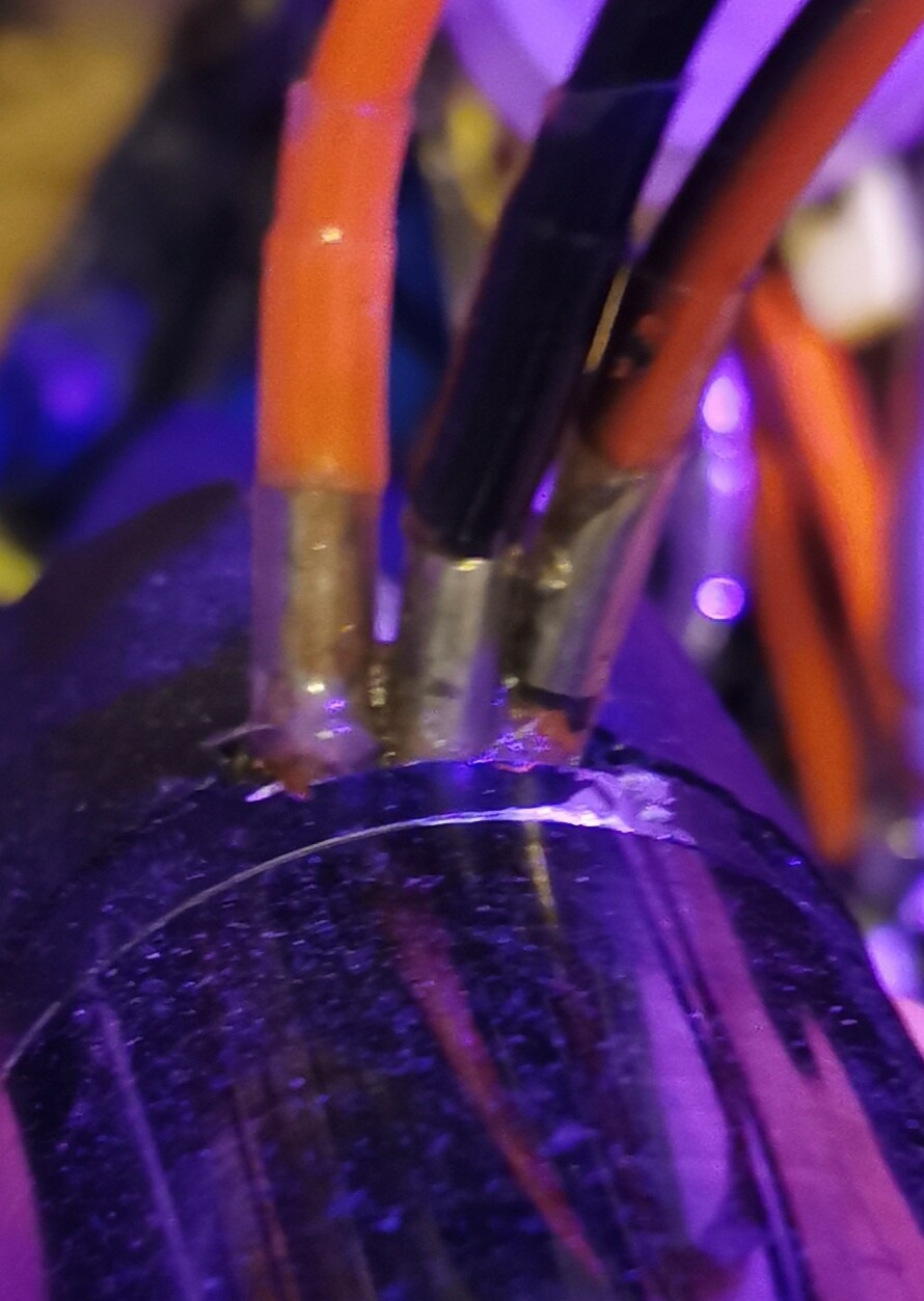

I took sleeves and connected new cables with flux and good solder, filling the cables with WD40.
