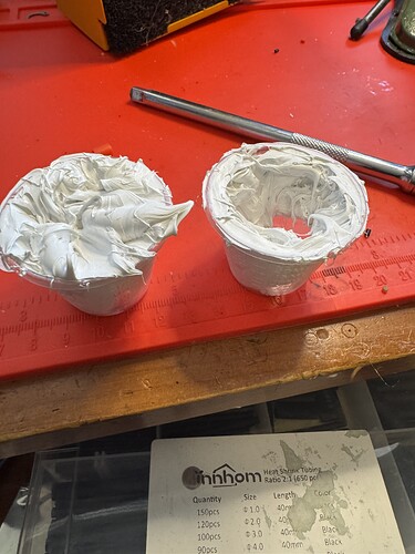

Because this motor is so weak I decided to pull it apart and change the speed controller to something with a little more giddy up and see what happens. I took it apart today and started cleaning it up. It is slap full of grease, not sure what kind, but it’s messy.
