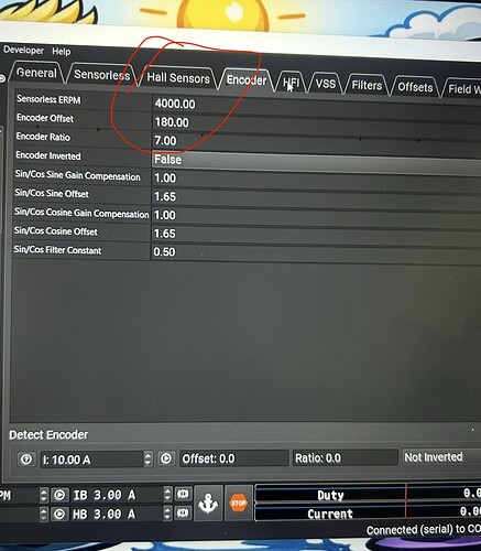

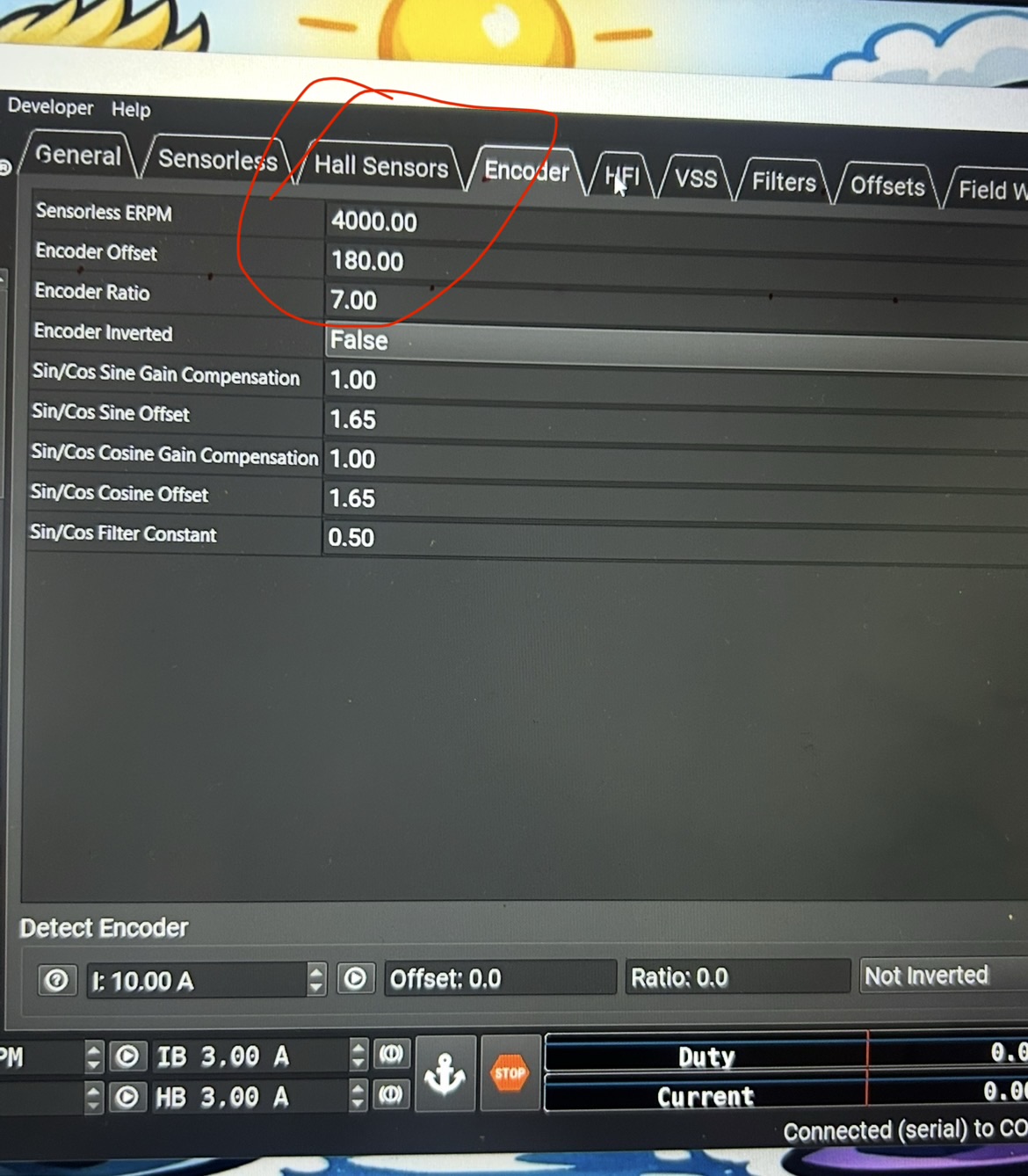

Claude ai helped me figure it out.
Adjusting the openloop erpm from 1000 to 4000 cured my stuttering.
So that means the FOC regulation (therefore motor calibration) at lower RPM is the problem..
Setting this value to 4000 means that basically all the time the VESC runs in openloop now, like a “normal” ESC does
You can run it like that, but it does not really solve the problem, just hide it (which can be fine, but then you could also have bougth a “normal” ESC or set the regulation type to BLDC instead of FOC :smiley:
Proper motor calibration would solve this and make the FOC (closed loop) regulation more stable
