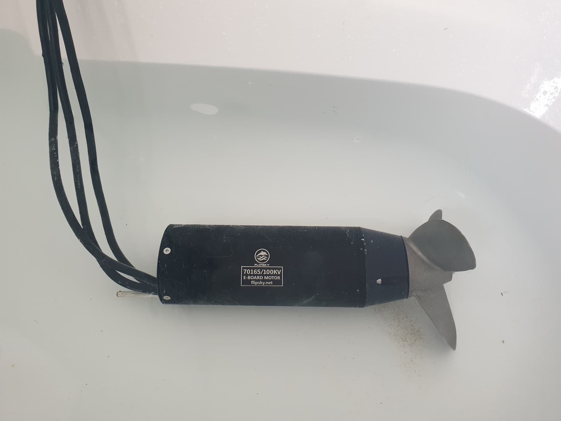

Hello,

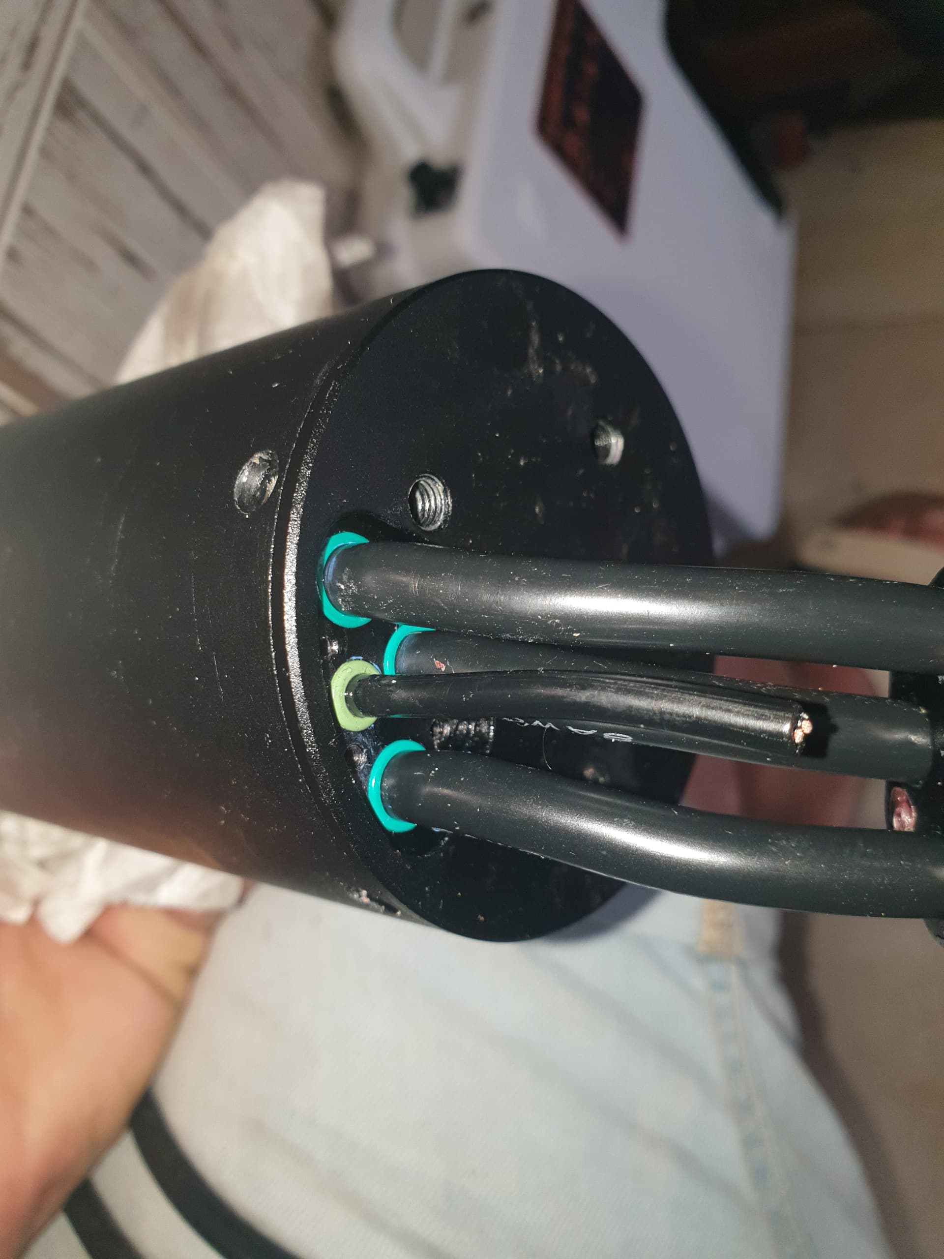

I removed the Flipsky 70165 from my boogie pod after 10 sessions and I found each phase wire a bit thicker (1mm more in diameter) and softer on the section submerged. The 4th small white wire on the picture is the temp sensor I cut & waterproofed (heatshrink + dual component epoxy)
Inside wires I feel like the electric cables are not as tidy as the remaining clean section which was inside the waterproof box.
I tested their resistance with a cheap multimeter and got 0.5 ohm between phases. Same resistance motor submerged and no bubble when I put motor in the bath.
I put some magic gel in the pod to avoid water ingress inside
The motor still runs well but I’m surprised with wire condition. The motor is almost new, never opened.
What do you guys think about this thicker phase wires ? Water ingress ? Magic gel incompatibility ? Too much heat ?
Thanks for your input :wink:
From the factory, Flipsky seems to fill the motor with some kind of oil. Ive heard that some kids of oil can make the cables become thicker, but this does seem very fast.

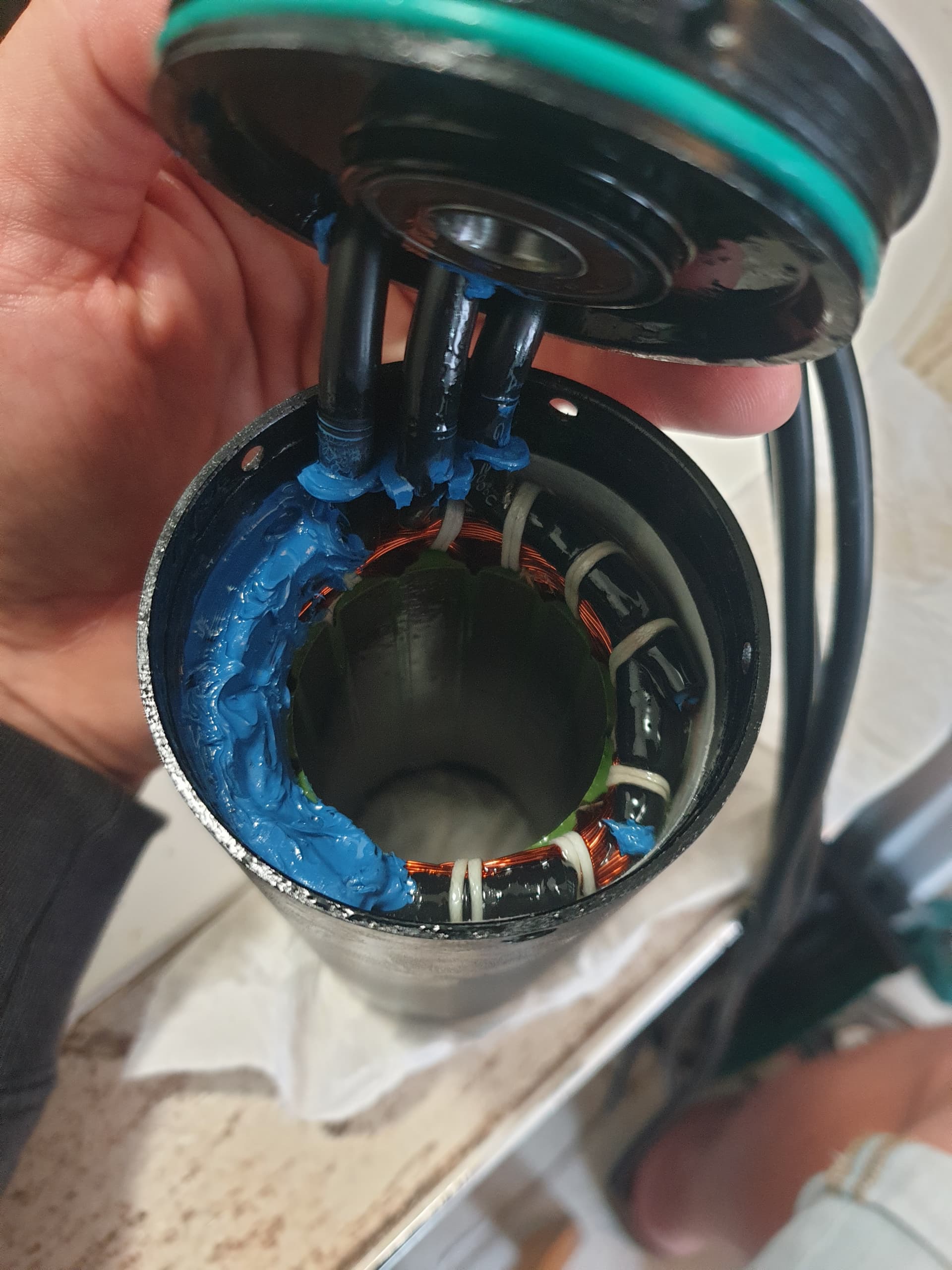

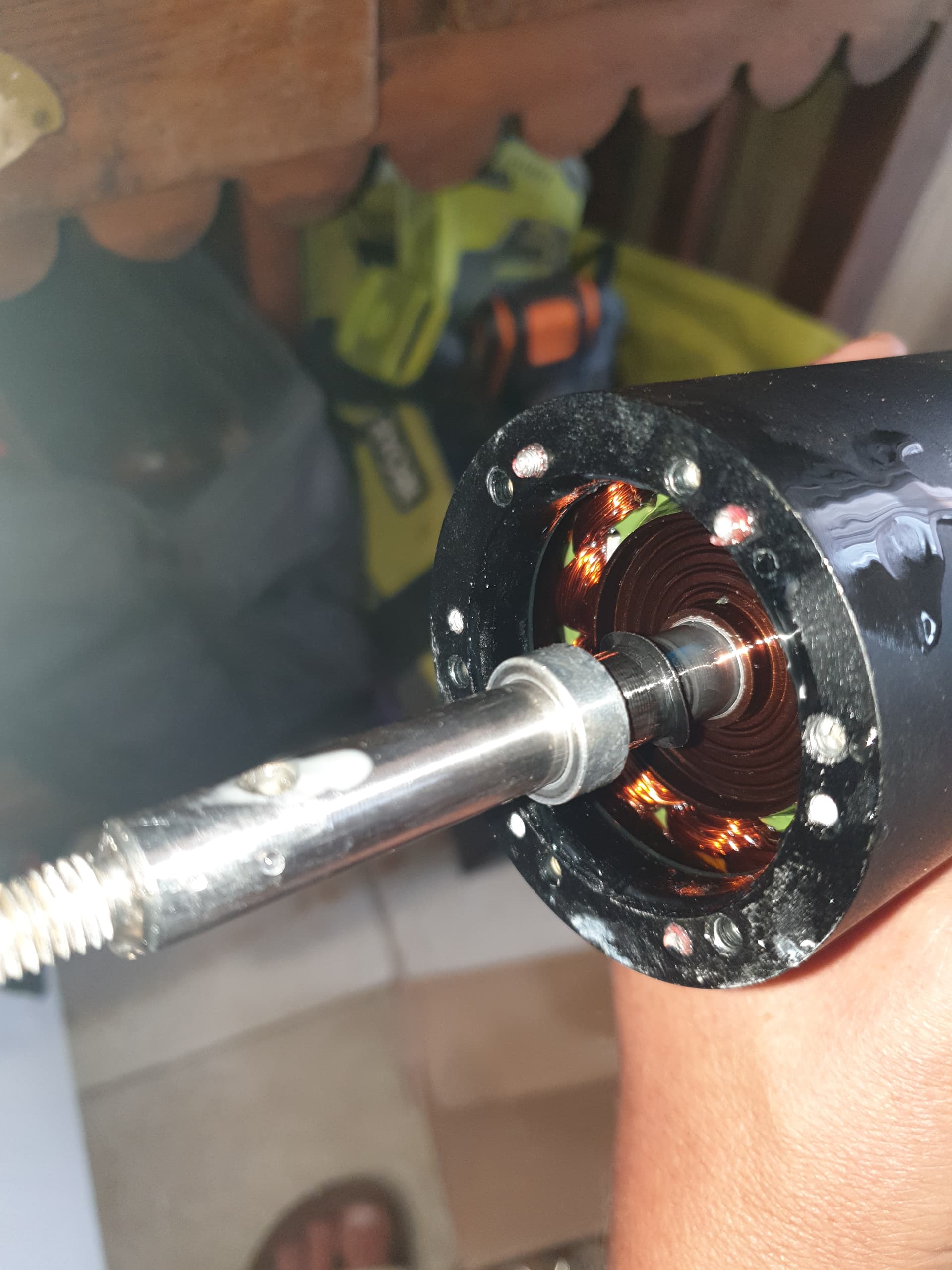

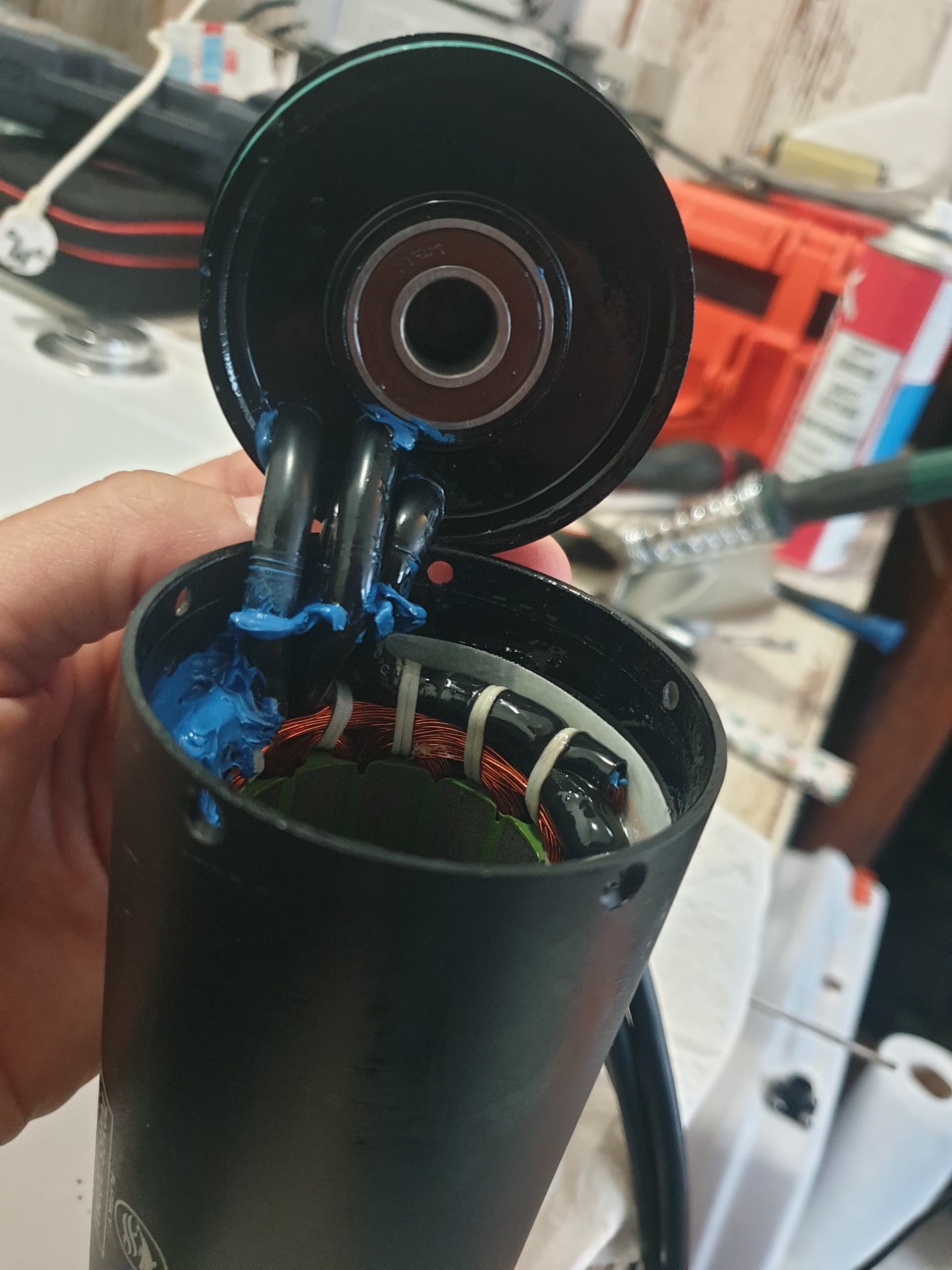

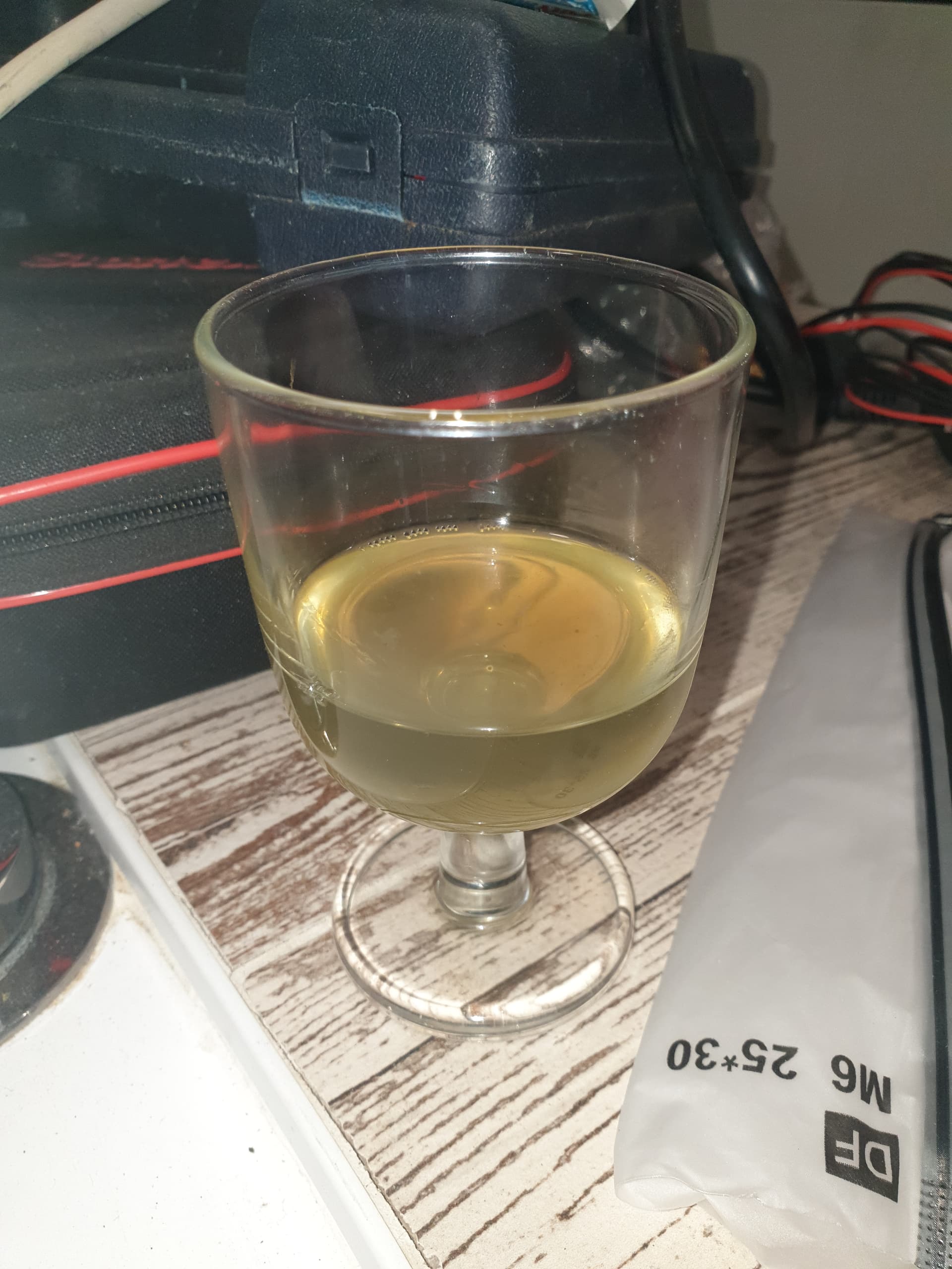

I decided to dismantle totally the motor. And in fact you were more right than this useless chat. There is oil inside the motor so it’s probably oil which climbed into cables.
Result of this useless job: 2 maintaining alen screws seized on the front cap. The nyloc compound used is red, too strong for this screw size.

How is the temp sensor mounted, is it within the copper? And, that blue stuff, is that from the fsctory?
Small tip, next time when opening a motor, use some heat on the screws, I agree, those screws break really easily wij the red loctite. Wrong choice from their end.

Blue paste is from Flipsky
For the hall sensor inside the motor I did not pay attention. The only thing I can say is the heatshrink + dual component epoxy is good for waterproofing it’s end.
