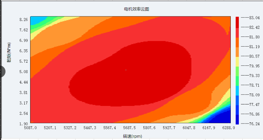

You would see lower current if while increasing the voltage of your battery you reduce the KV rating of your motor( which also changes the torque constant). Also, it is important to stay withing top efficiency range of your motor as it affect the phase to motor current relationship, which impacts the heat generated by ESC. More heat=less efficiency=more current; over and over again.
Cloud range is for 120kv
