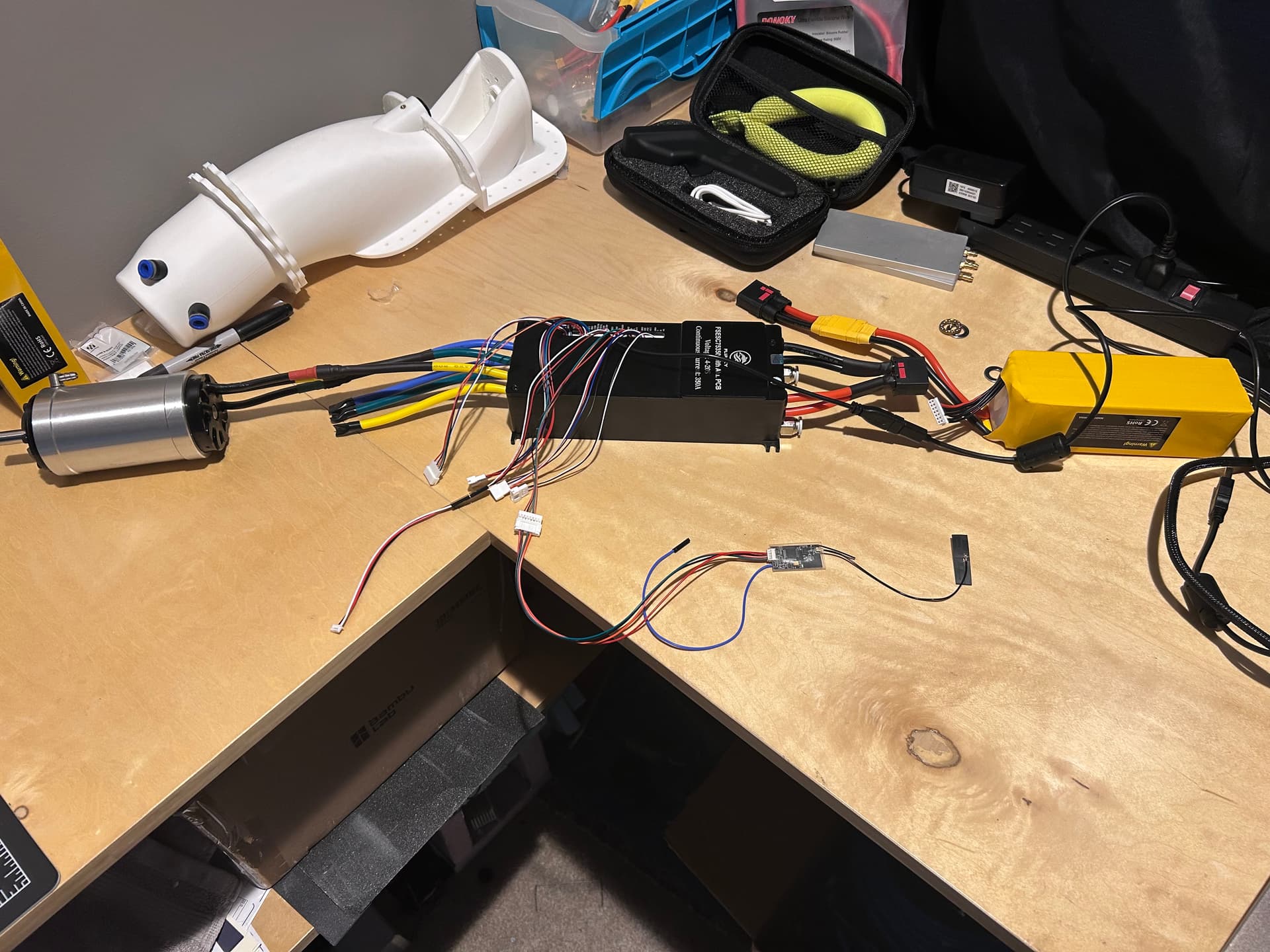

Hey, I’m new to all of these electronics and am having issues getting my motor (SSS 56123 V2 500kv) to work with my Flipsky 75350 and VX3 remote. I’m sorry if I explan badly, and will try my best. I am testing with a 6s 8100 mah battery just to get it to work properly but plan to have it 12s once I get it figured out. I am creating a jet surfboard so I will have a higher rpm than foils.

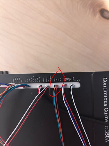

I am currently using the UART APP as I can get the motor spinning with this configuration. If I use the PPM and switch the wiring the motor does not want to spin at all. I get a esc battery power is less than 0% error on the VX3.

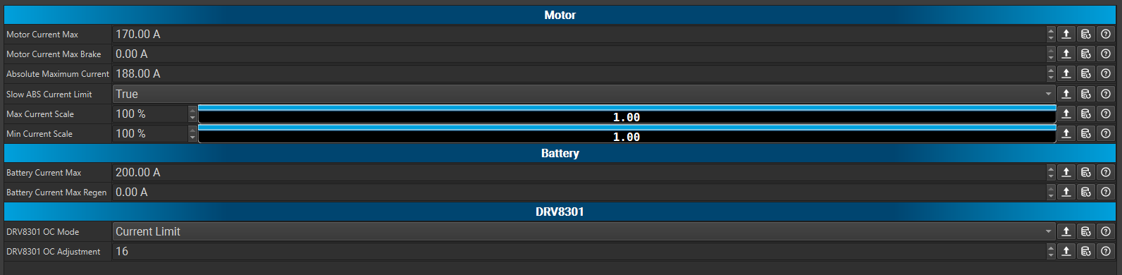

Here are my motor settings, I have max power loss at 4000w (tried to stay conservative) when setting up the motor, poles 6. Voltage is set to default for 6s (cutoff start 20.4 V and cutoff end at 18.6 V).

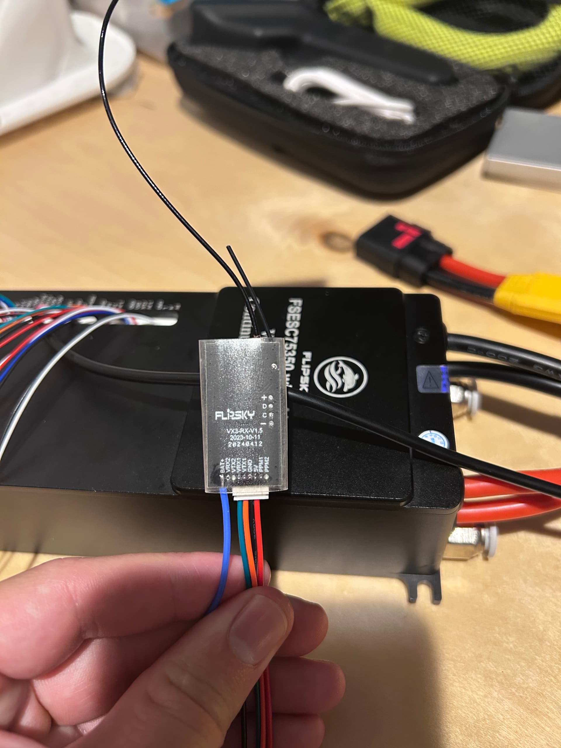

When I pull the trigger ( 4 wires in reciver - UART App) the motor doesnt respond until I go full throttle a couple times then it starts spinning at around 20% throttle but at a constant RPM up to 100% throttle. The remote has a negative watt value of around -30 to -60 and a negative amprage of -1 to -3. I have double check wiring and it all seems correct. The 75350 says its power for the output I am using is 3.3v and the reciever says it needs 5v. But this is the only way I can get the motor to spin at all.

Reciver…
Testing setup…
Motor Settings
4000W power loss seems high, should be 10-100 at a guess. Not sure what difference that would make though.

Since it is a large motor, the default Max power loss is 400 W. Does this still seem high? I may have misunderstood what it was.
I changed it to the recommended 400W , no difference as you had said.

And put these cables all together. Like the red and black ones from the battery.
Ok, I was debating this, wasn’t sure if I needed to since the motor wires are the same gauge, but since its longer wire I guess it would get hotter.
