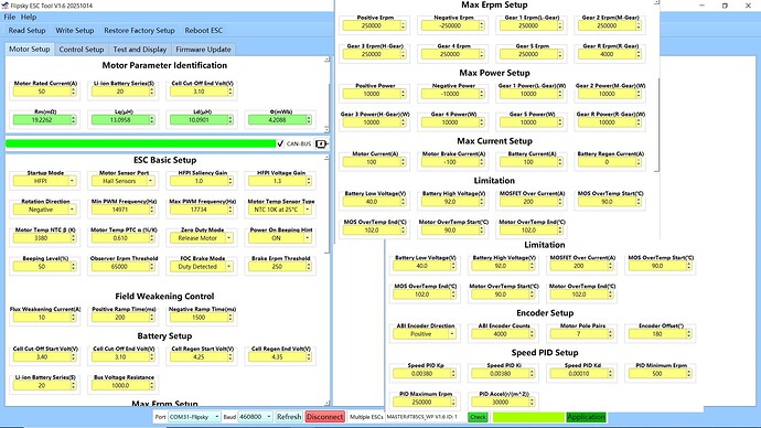

Please share the settings you have, the motor and propeller you use, etc. so we can properly help
6384 motor with 4.8inch folding prop. in water I tried 13s and 20 battery. the speed is almost the same, not enough on foil. there’s s
etting:
If you are running in water (under load) increased battery voltage will not increase RPM if motor current limit is the limiting factor. Motor current limit is effetively a torque limit. So if your propeller is to tough to drive that would limit your RPM in water no matter other limits. But I am not sure that is the case for you.
You also have 100A limit for both battery and motor current. Problably you should have significantly higher motor current limit. More then double motor current limit compared to battery current limit is not crazy with this type of motor (3-phase PMSM).
Which this specific motor I think 200A as motor current limit might be to much. I would actually guess that 100A should be decent at least. I do not know enough about this specific motor to say if 100 A is on the low end or high end. Or this specific propeller/motor combo.

I would go to 120A minimum.
it;'s Flipsky 6384 with the Flipsky folding prop. the speed is slow not enough to pop up on foll. I think the motor rate at 80amp. I put 100amp is more than enough. I see people use 6374 6384 motor in this group. I wonder how you guys setup it?
Motor current is much higher than batterie current at low speeds. (I have a different motor, but also need more than 100A motor/phase current). Increasing to 120A made the difference for me. With 120A I can start in flat water but not against chop waves (crappy board hydrodynamics, 1050cm foil, 80kg). If no one is answering who uses the motor, I assume there is somewhere a thread with the settings people use. So KI search should find it.
