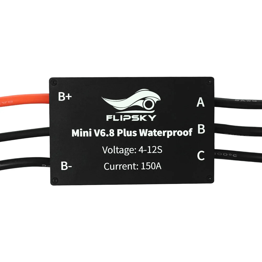

are you using this one? of course there is a CAN bus. there you could attach a vesc express that saves logfiles to an SD card

You have this ESC:
And a BREmote V1 or V2?
For V1: You can also read battery voltage analog with the Rx and use the only UART of the VESC with a logger. You only miss temperature display on the remote this way.
For V2: Same is possible. Also with an update soon, the BREmote can also log data, so no need for a 2nd UART logger :slight_smile:
