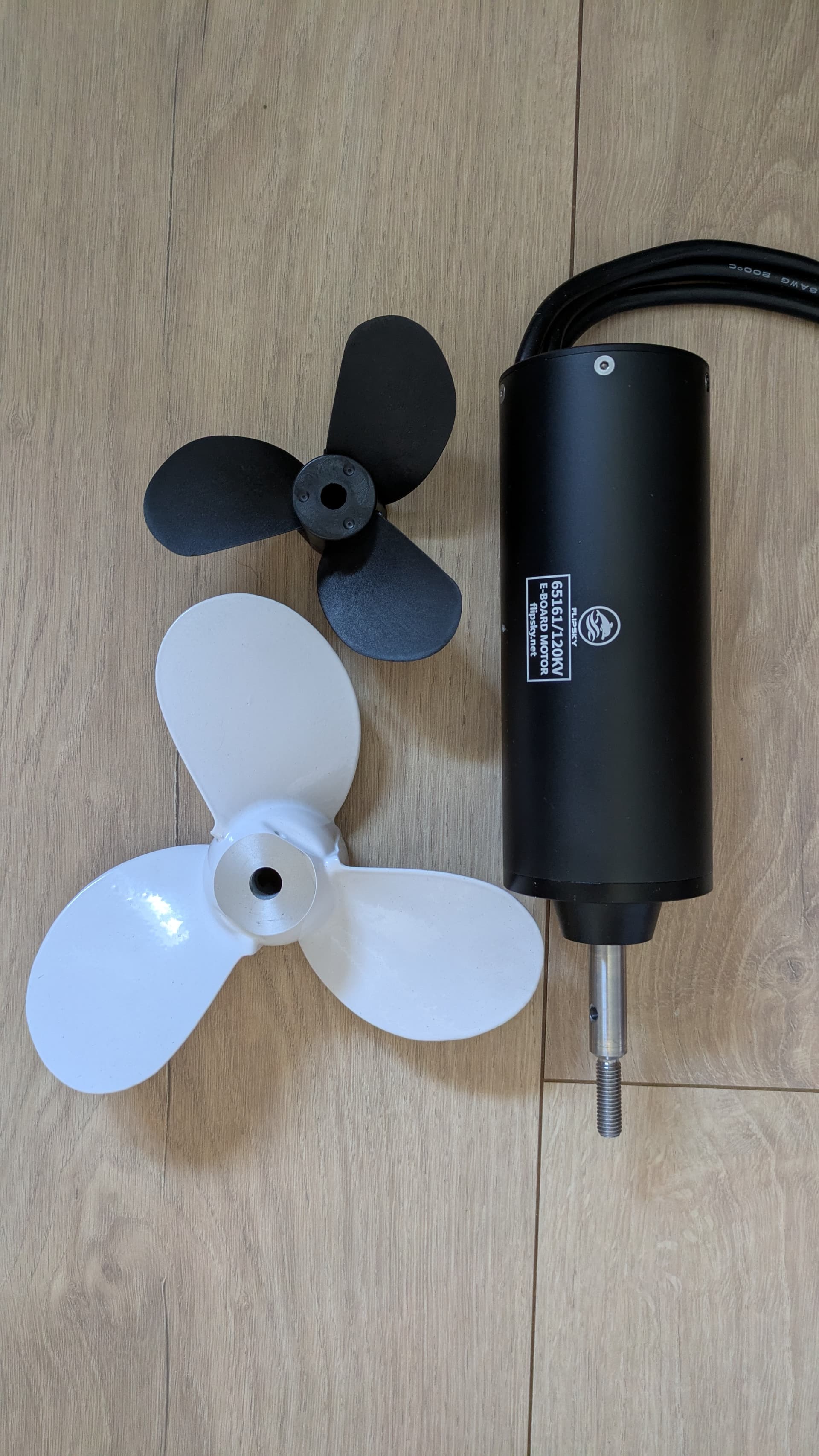

I ordered the bundeled black propeller since it was only $20 extra. Got the package the other day an Flipsky actually sent me both black and white popeller. Big difference! The little one is 6cm radius an the big one is 9cm. Here is a comparing picture👍
Depending on your battery and board etc black may to too small white too large. some users cut down the diameter of cvthe white one. some find using the inexpensive flight propeller a much better option for efoil with the 65161.

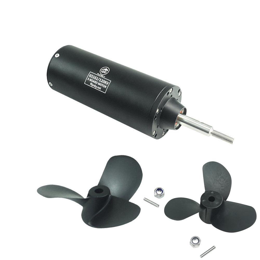

The black prop that I got does not match the one in the picture together with the Flipsky 65161 motor: Efoil motor FS65161 100KV 6000W 20S water proof for motorized surfboard | Flipsky.net – FLIPSKY
The one I got looks more like the one on their accessories page: ABS Motor Boat Propellers 3.8 Inches Electric Engine Outboard Propelle – FLIPSKY
The bundeled prop is $20 extra and the accessory-one is $15, so I thought that they were two different models. The one on the bundle picture looks bigger and more like the Flite propeller. I photoshopped together the two trying to match the size to the M8 nut and the pin (perspective not taken into account)

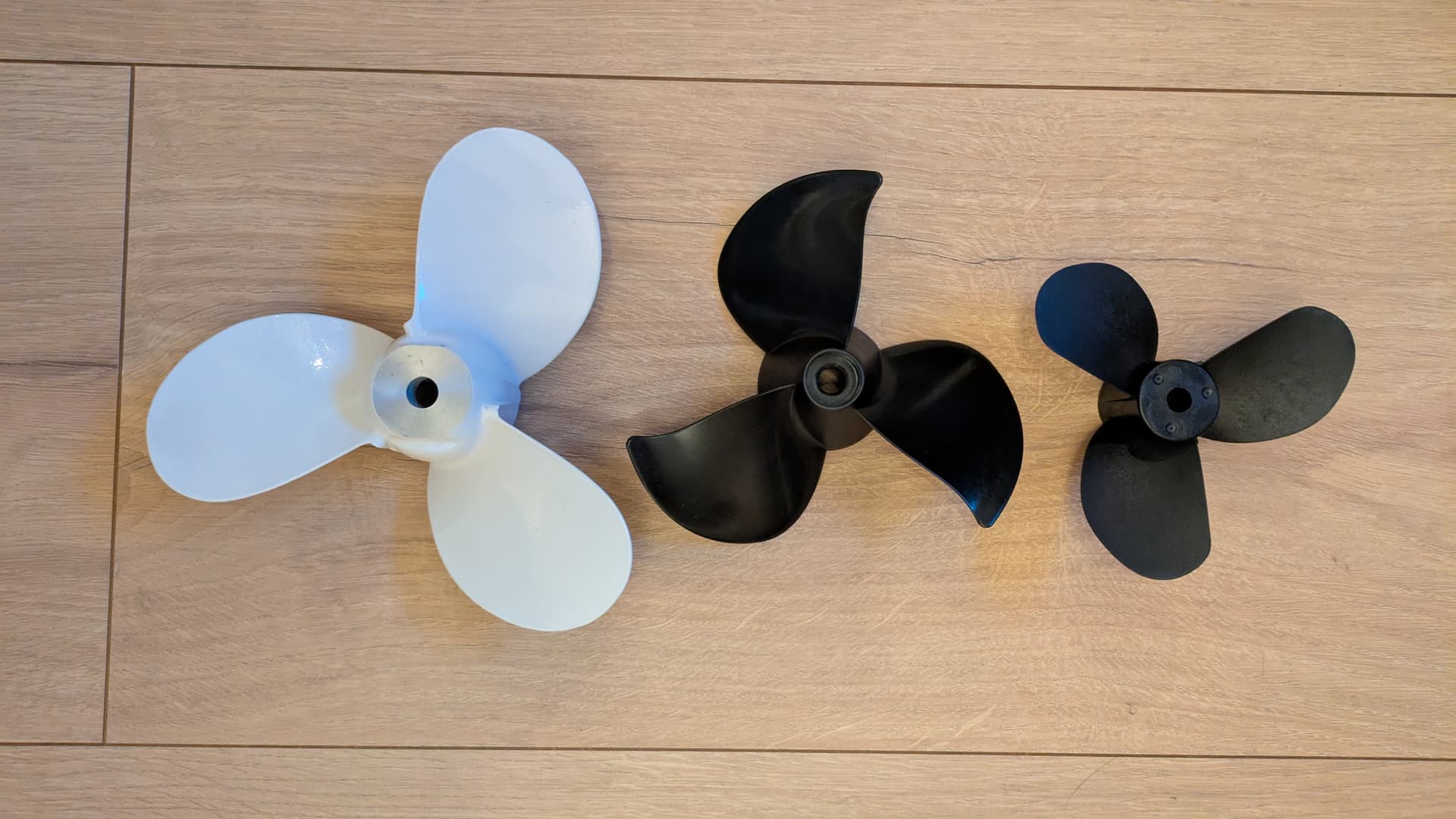

If you ordered a Flite prop, better use this one, I haven‘t found a better one and I tested quite a few props.
Got the Flite propeller in the mail. It looks a little different than i expected. More like the true glide propeller.
Looking at the Flite board website for Australia this is the design of the Flite propeller. Up here in Europe, an also US and Canada the Flite propeller looks like what i expected. Anyone know if either is a new design, or are they just different?
