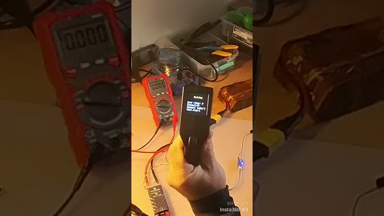

Video
In upper left you can see no signal strength for remote (only gps)
This might help. Remote in pairing mode first then power on receiver
Thanks… seen that added a video because my dsc was lacking
Pairing process in video and the one that works for me is to power on VX3 and put into pairing mode BEFORE powering on receiver.
Your video shows you doing the reverse of this.
At the end of video it looks like you are measuring V to the receiver but the video cuts off before I can see V???
Sorry bad edit… It’s 5V. Just tried it remote power, put it into pairing mode, then power up everything else. No love same result. Got me excited
