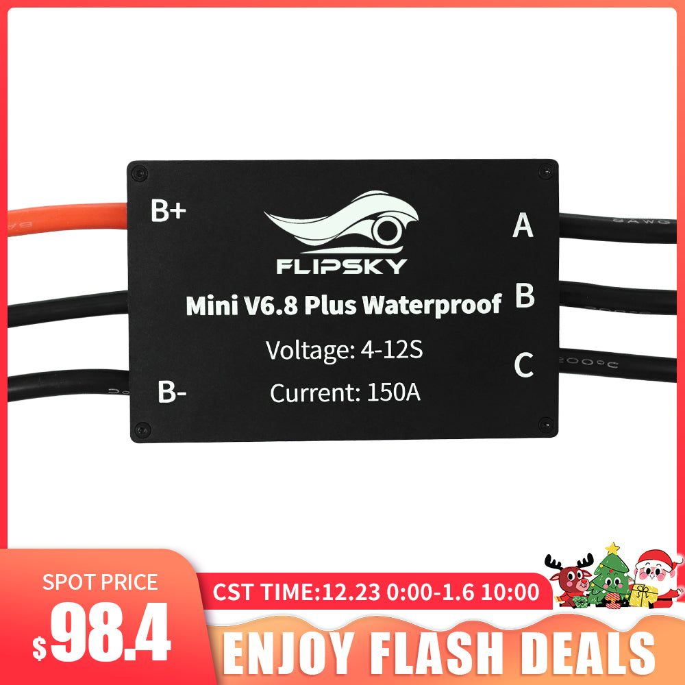

I see there is now an IP68 version. This could be useful and if exposed to air (and water) it could solve the heating issues? Flipsky IP68 Waterproof ESC Electronic Speed Controller Mini FSESC6.8
