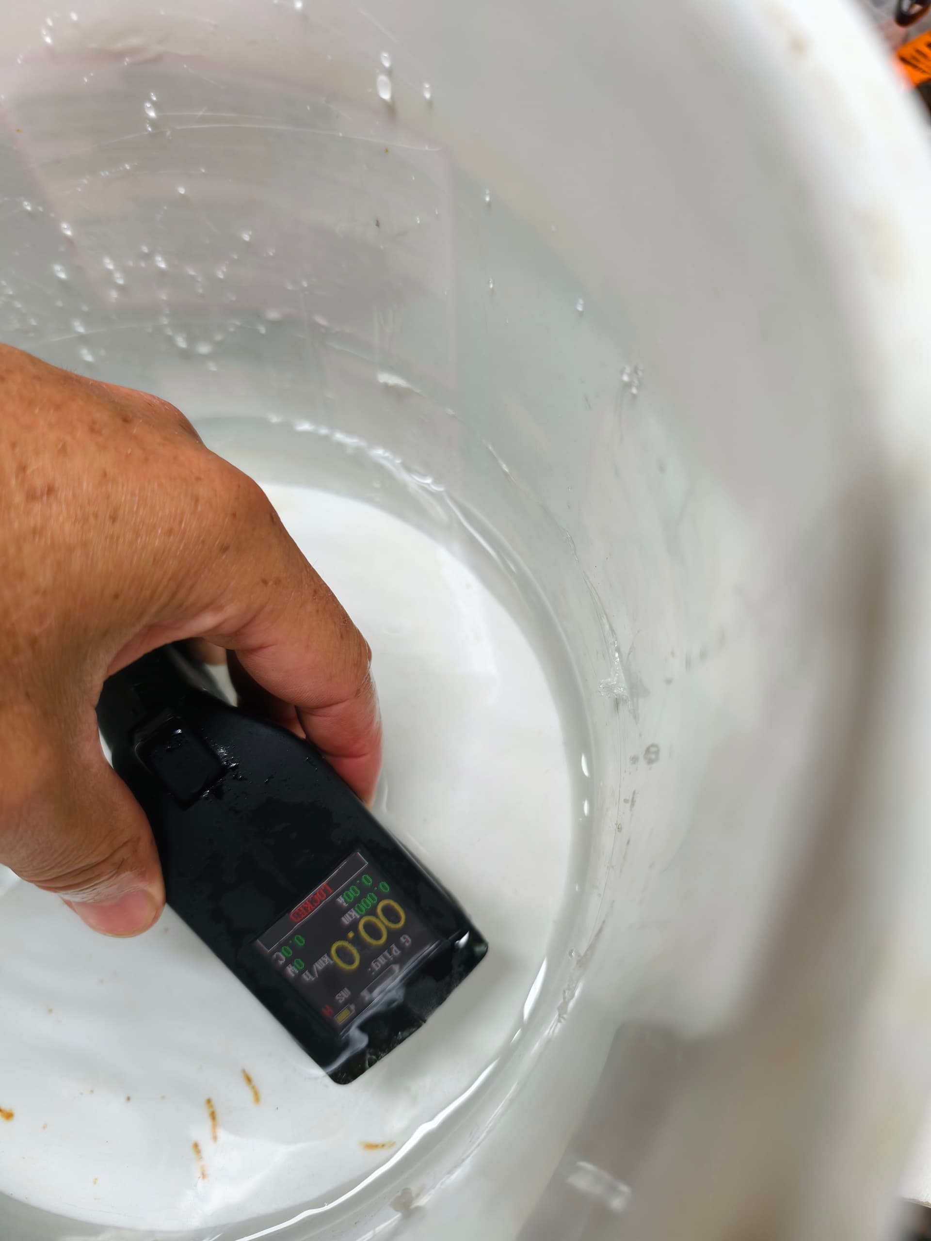

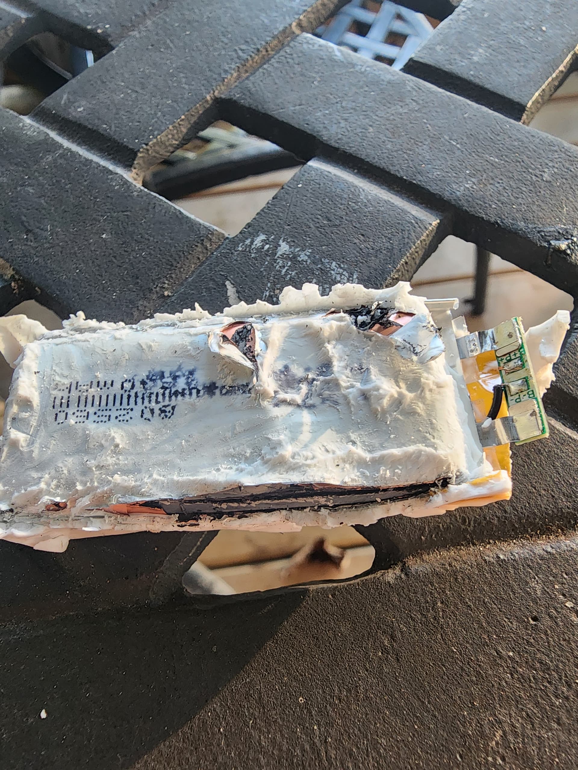

So as suggested by Bigbug my first Flipsky VX3 failed 2 years ago after 2 or 3 times using it. Since replacing the battery worked for him and the remote was dead anyway I thought I would try to fix mine the same way. I pulled the old battery out it was a pouch cell 1500 ma/h. There was a small BMS on it. Water got to the battery and BMS and the contact rusted out the battery was dead, I had an almost identical battery from an old drone that I no longer have it’s 1800 ma/h same size. I soldered it in place. I didn’t have silicone left so I potted it in with Goop I use this for everything and it never fails. I could not salvage the BMS so I went direct. It worked the remote is back. I had it in water turned on for 30 minutes and it still works, I tested the charging and it works. You can probably find this type of battery on Aliexpres for a dollar or two.

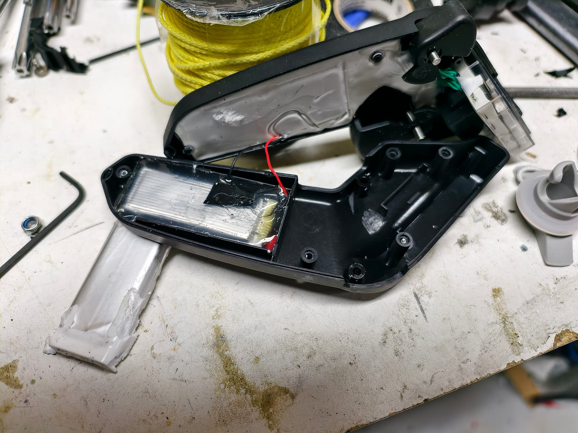

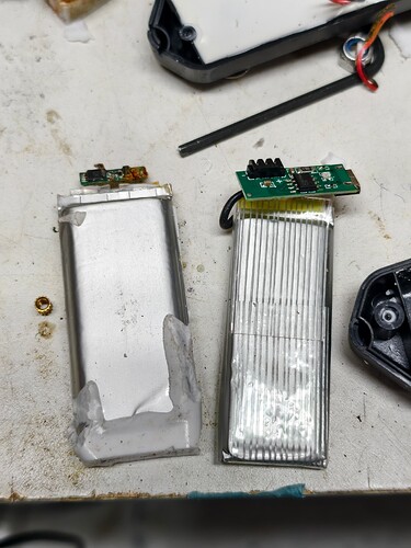

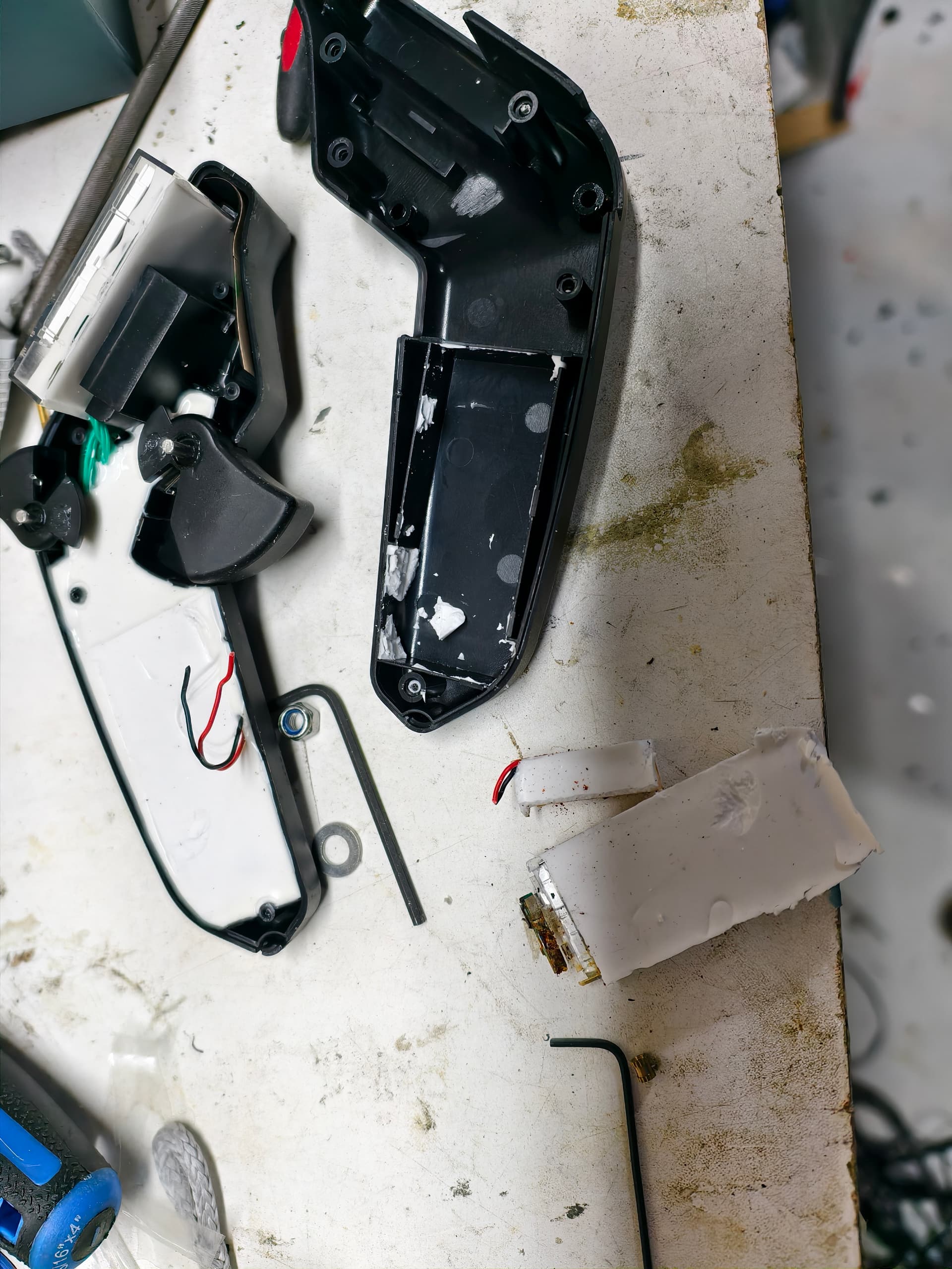

I would love some advice on how to remove the battery. (In case my new vx3 fails) I tried to take the battery out of the old one and nearly set the house on fire. So any advice on how to remove the battery safely would be greatly appreciated.
The battery is potted in with white silicone. I just ran a small screwdriver all around it to detach the silicone from the plastic body and pulled it out. I didn’t puncture the battery. Puncturing a charged battery could be dangerous but mine was dead 0V so probably safer that way. The silicone peeled off pretty easily with my fingers.
Pretty sure mine is black epoxy.
My battery is dead and blown. It happened at the end of a charge so maybe the bms is the root cause. Now to find a replacement :wink:
