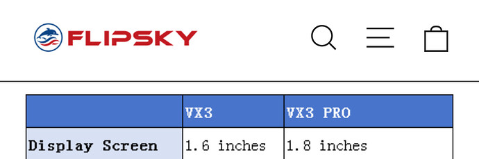

As far as I know the only physical difference between Original and Pro models is the size of the screen.

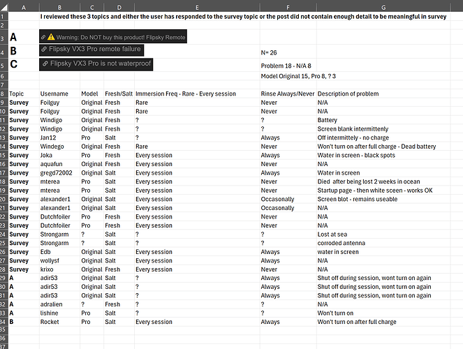

Thanks everyone for participating. Up to 13 now some with multiple so will start loading data into spreadsheet. I won’t be able to share actual spreadsheet here but will do some photos of it once I get it put together. Hopefully more people will add to the list :grinning:
I will likely go through the three topics I listed above to see if I can find some more items.
A few of the responses to this topic don’t state some of the items that might be relevant such as model etc. so if you could review your post and edit if necessary.
If the data doesn’t reveal any big light bulb things I still intend to send it to Flipsky with no identifying info as a prod for them to up their game if possible. The price point of the VX3 might not have margin so they might not be able to change much.

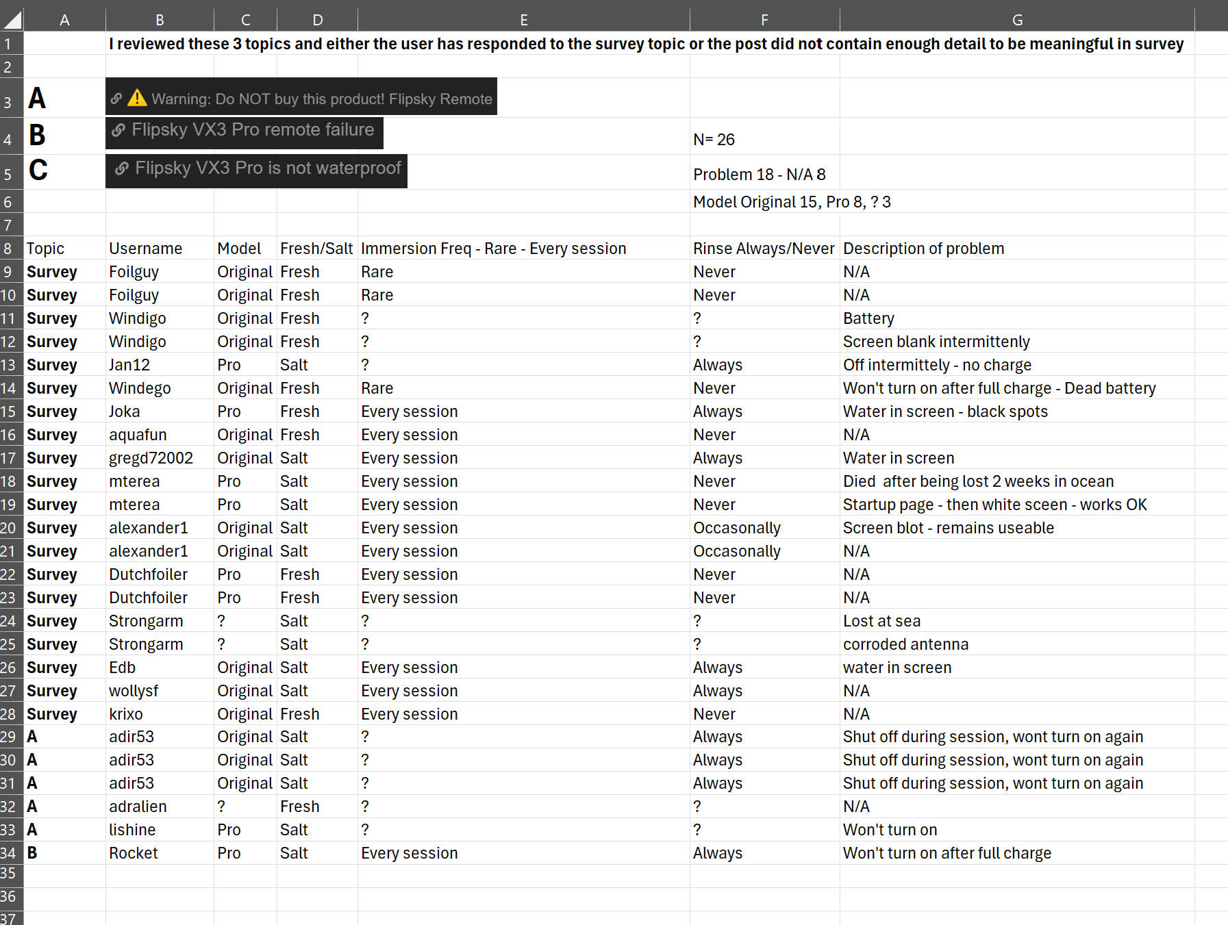

Spreadsheet as of today
As of today there are 5164 users registered ALL TIME. Not sure how many use Flipsky VX3 and for sure the survey hasn’t captured everyone who has owned one and have or have not had a problem.
For me there is no big lightbulb revelations but others may see something that I missed :slight_smile: An N count of 26 won’t yield much but I want to thank everyone who posted for supporting the community at large.
Please continue to add posts if you are inclined - at the very least it might prove useful to a user who is considering a purchase of one.
I intend to strip out usernames and the topic headings and send it to Flipsky.
