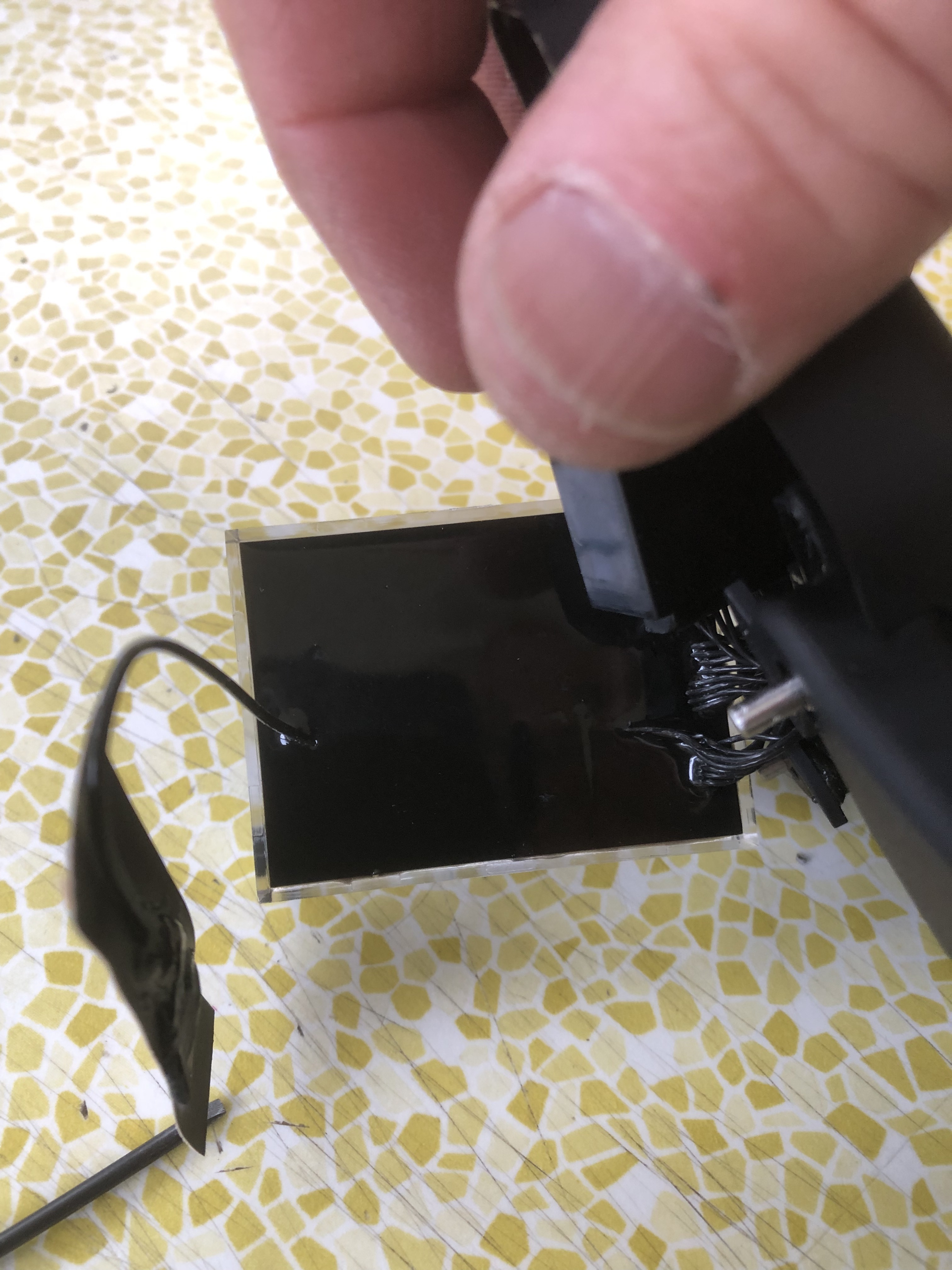

This is what the back of my VX3 pro screen looks like. Is this the potting scenario you are talking about? If so looks like they may now be doing it. If not please explain?
My vx3 pro had water in the screen. The cable to the screen were really close or had contact to the sidewall. I believe the water came in thru the gap between sidewall and cable, where no compound filled the space between cable and sidewall.
In our opinion the water in ours came through insufficient bond between the potting compound and acrylic screen cover. It took a while to damage the TFT screens, as soon as we noticed it we dried the remote out in a food dryer after drilling two little holes in the acrylic screen cover sides close where the wires go in. After drying it out we injected clear epoxy into it. This procedure was described in a post here, it works quote well and we could salvage about half of the ones with water in it.
I did the same to my screen. I flushed it with isopropanol quite a few times and then dried it in the oven.
I flushed the screen with epoxy. The visibility got worse. I can barely see the battery now.
It still works though and is usable
