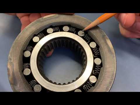

Can anyone explain how the mechanism in the bearing for this prop works?
Like free spin in a bicycle wheel.
Or the one way bearing like they use on RC helicopters
Called a clutch or sprag bearing. Lots available, just need to make sure they are 316 stailess.
There’s no real advantage of the true glide prop as can be demonstrated by fliteboard putting folding props on their newer wave riding efoils.
Thanks found this simple YouTube that explains it well.:grinning:
