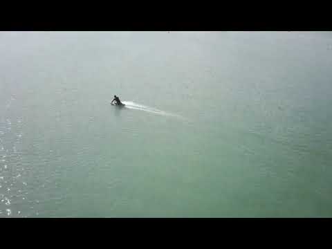

Yesterday I could finally water my own homebuild and this is now the time to finally register in this forum.
The first ride didn’t get to the foiling in standing but I was very satisfied with the performance. Unfortunately my Antisparkswitch said goodbye and I had to end the session after half an hour.
Beside the smoked switch there are also some small leakage problems…
I like the design of Fliteboard very much and I have orientated myself a little bit here. Still working on the optical impression, the technical side is more important for now. :face_with_monocle:
