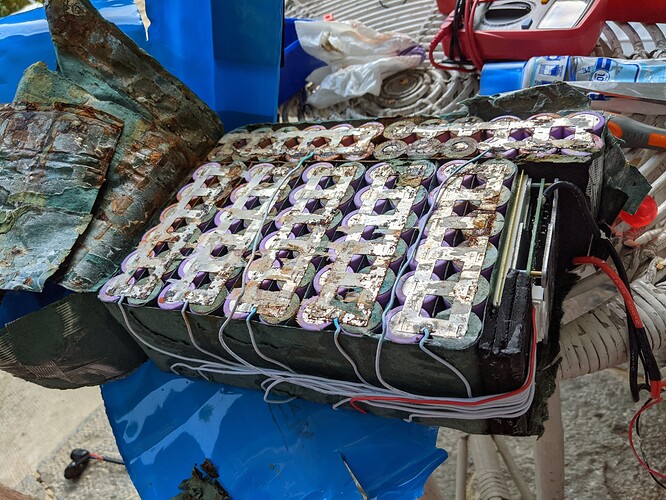

Then I modified my SUP for a first test making a drawer for the battery. But the cover was not as watertight as I thought
2nd lesson: Test throughfully the waterproofness of your compartments. Water WILL find its way in…
I only allowed some 3 minutes with water in the compartment before emptying it and the battery was in a quite protected plastic cage (which I wrapped in plastic to close any possible opening) and inside it it was protected by the usual heat shrink plastic. Externally It looked as if no serious issue had happened… But the battery didn’t sustain the voltage any longer when connected to the motor or a load. So I had to open it and discovered that it was seriously damaged: rust had completely destroyed some of the welding nickel strips.
3rd lesson: Just some seconds in the water will kill your battery even if it looks good externally, so go back to 2nd lesson
