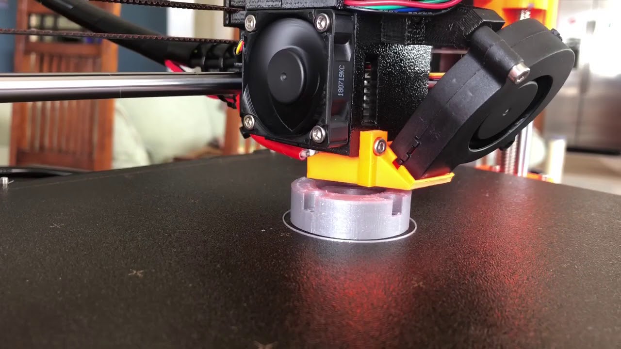

I have finally collected all the various parts (and a few tools) from around the world. That alone was quite an interesting odyssey. One of the tools (from Prague) is a Prusa MK3 printer kit which took six weeks to get and two days to assemble. Here it is in action just finishing the thrust bearing mount (STL file courtesy of PM!)…
