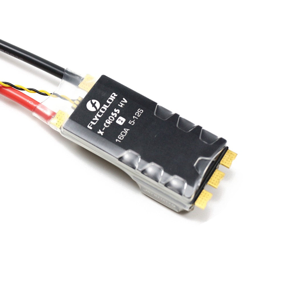

Update on the flycolor 160 Amp ESC. I bought a few more from this supplier seems like a good deal for buyers in the USA.

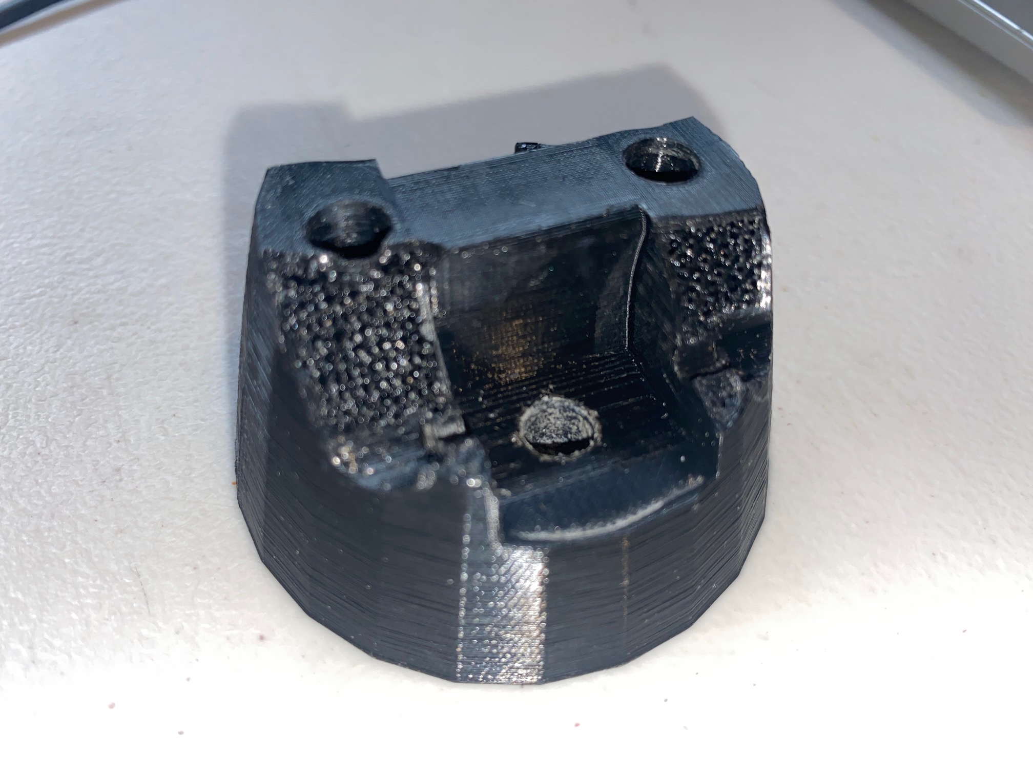

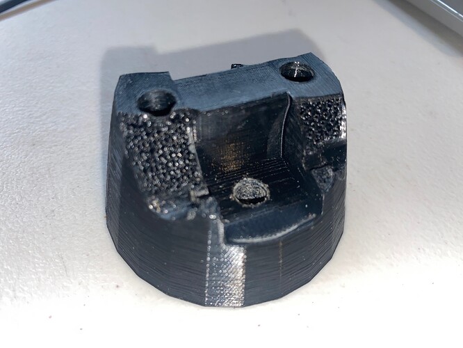

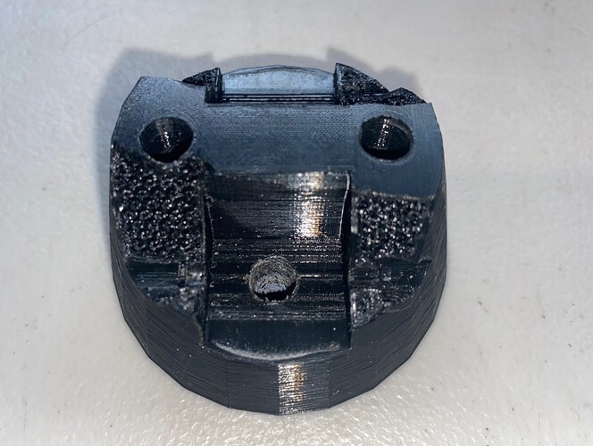

What material did you print your hub in? I tried PETG and it failed after 2 sessions and I lost my genuine FD props :frowning_face: I also drilled 2 extra holes for mounting the hub to the motor.

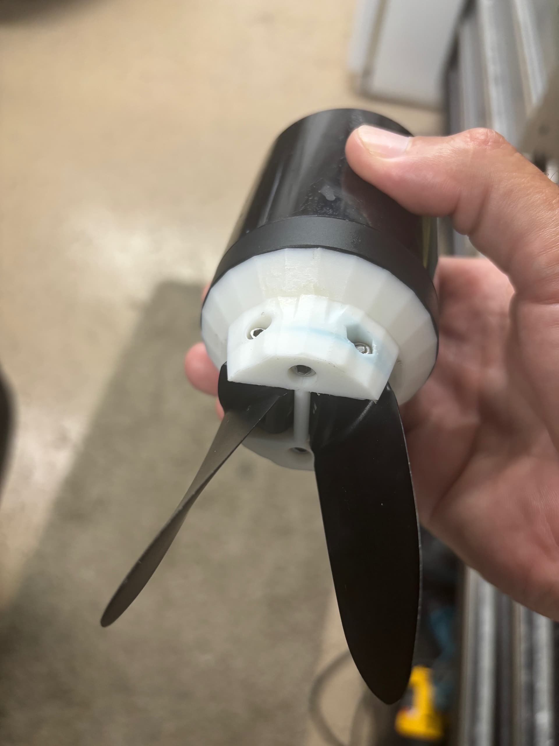

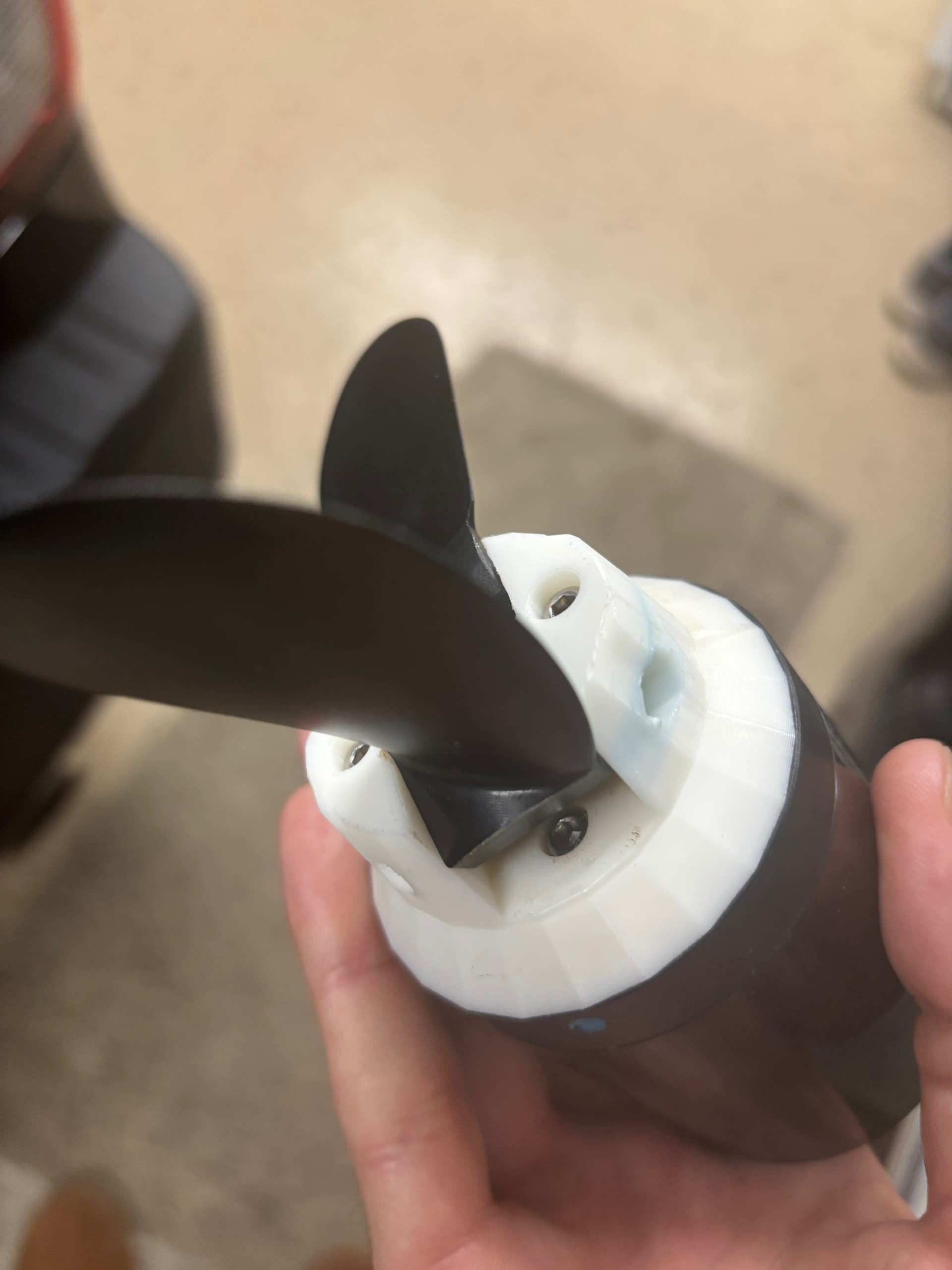

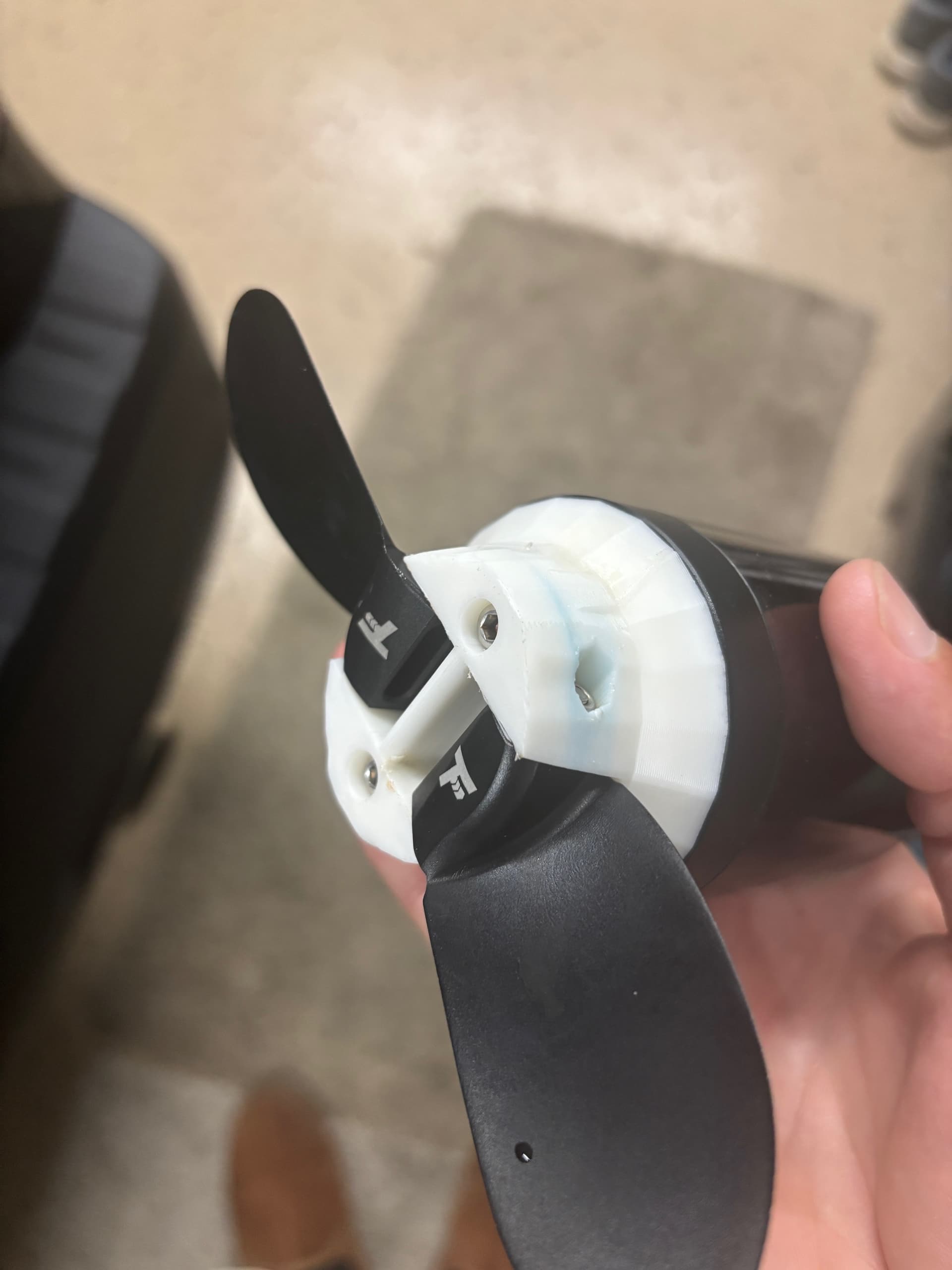

Wow I’ve never had a failure, sorry to see that. I use eSUN PLA+ Filament 1.75mm for all of my prints off of Amazon. The Pod that connects to the mast, the hub, everything. I printed them out and hit it with a hammer 10x and it didn’t break, that gave me confidence. I do 100% infill which looks like you did too. I’ve heard of issues with PETG being brittle and needing proper 3d printer settings and wasn’t confident using it. The only thing I noticed was a small crack by where the bolt head threads into the prop, so I replaced it with a new print. That was after roughly 50+ hours of foiling. I’d recommend printing with PLA+ it’s cheaper and seems just as durable. Maybe replace every 25-40 hours of use? I went out to check my setup and it seems like I’m using a thinner version of the hub with 4 bolts that works better with foil drive props (they fold closer together). I’ve run this setup and the one you printer well over 50 hours without a failure. I will put up the link to download below. Here are the pics. Also I use blue loctite thread locked on the nuts for the props.

Thanks for your feedback. I’ll print this V4 design in PETG and PLA and do some stress tests on both before heading out to sea again. My previous hub print was done at 80% infill, so probably not ideal.
No worries happy to help. 80% infill won’t do it you want that thing rock solid no voids. Also there is a big difference between PLA and PLA Plus. PLA Plus is stronger can handle heat better, etc. I wouldn’t trust regular PLA to the task. I say try PETG again and if it doesn’t pass the hammer test then try PLA Plus.
In my experience 15% infill with gyroid infill pattern and fill with epoxy after printing works really well. Drill a couple of 5mm holes from the back and slowly fill via a syringe. The gyroid pattern allows the epoxy to flow right through, seals the part and bonds the layers. Bulletproof !
The other option that has never failed me is having the hub printed in sls nylon by an external company. I have used both Zelta 3D and PCB Way. Most likely someone closer than Singapore or China but freight is actually very reasonable. You can get a quote by dropping the stl file onto their website.

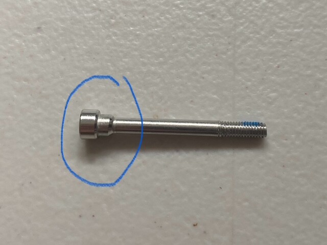

The FD bolts I recently bought have two different dimensions at the head and don’t fit the 3D print. Is this what your bolts are like?
FD Prop Bolt
No the only thing I use foil drive specific is the prop blades. The new shouldered bolts won’t work or you’ll have to just customize the print. I use stainless socket head cap bolts. The same as original foil drive used. Cheap to buy on amazon or pickup at local hardware store.
