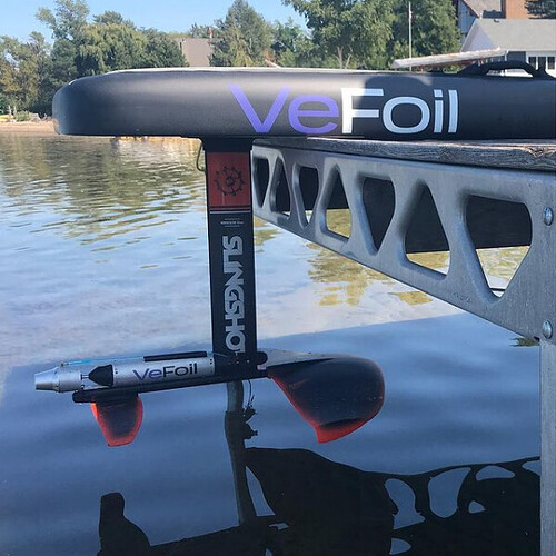

Vefoil got his working too. Videos on his youtube channel…
The only time it would have acceptable performance might be for a wave assist surf setup… But even then you may as well skip the jet altogether and just use a small prop…
I was not on the board back then, but it seems from reading old threads Vefoil did quite a bit of pushing the jet drive. Is part of their disappearance perhaps due to the fact that they put all of their eggs in a bad basket while also bolstering the Canadian government’s mentality that props were too dangerous? They essentially painted themselves into a corner it seems to me. So glad I was not a backer, I almost backed both vefoil and waydoo before deciding to take the time to DIY…
Vefoil never had a working jet drive. They have some videos but never showed the jet drive working and It is obvious they initial tests were with prop. Without a proper fall detection both in the board and remote prop always can cause serious damage. Now that It has been couple of months I am pushing the limits, I see it clearly with me DIY foil and lift foil. Sometimes there is a situation in choppy water, during very sharp turns board falls to one side and I fall to the posit side where the prop and wing are. I see there is a change some part of body gets tangled in to prop section even with the prop guard. In this situation remote fall detection baes on emu will not help a lot but the imu in remote early can detect the board angular limits (angle and angular acceleration).
At 2:30-2:31 you can see the jet system through the water…
Vefoils kickstarter was to opensource the jet systems design. It was never to actually deliver a physical product to the backers. I think a lot of guys misread what he planned on doing when they backed them. Unfortunately he never actually even delivered the plans and instead patented them…
you are kidding right? that can be water cooling spitting some water out
I backed Vefoil and never got plans. Instead was promised a discount on the product they are trying to sell.
Bait and switch with this one.
I don’t think you understand where the jet is located on the foil…
Look at where the intake is over the rear wing and then again where the nozzle ends… He is clearly riding a Jet drive…
