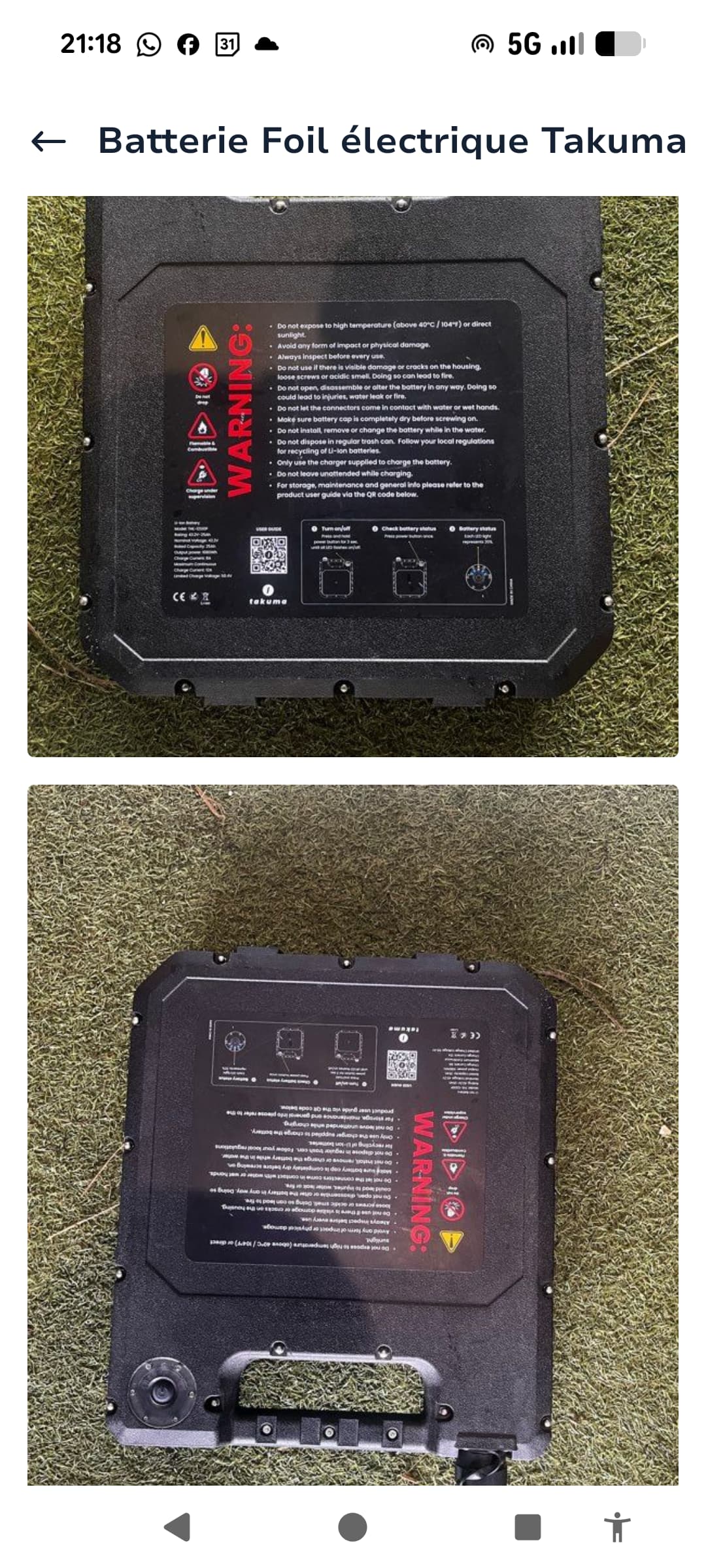

I’m 90kg, maybe it influences the current needed. According to my research, average power is not huge (around 2–3 kW), but take-off and recovery phases regularly require 4 kW or more.
At 12s (~44 V) this translates to:
3 kW → ~68 A
4 kW → ~90 A
Also, I’m planning to use it on flat water.
Do you think your option is sufficient ?
And what do you think about 25ah battery from Takuma?
Thanks!

I don’t know who, but somebody told be the Takuma batteries like burning (I hope I’m wrong here)
