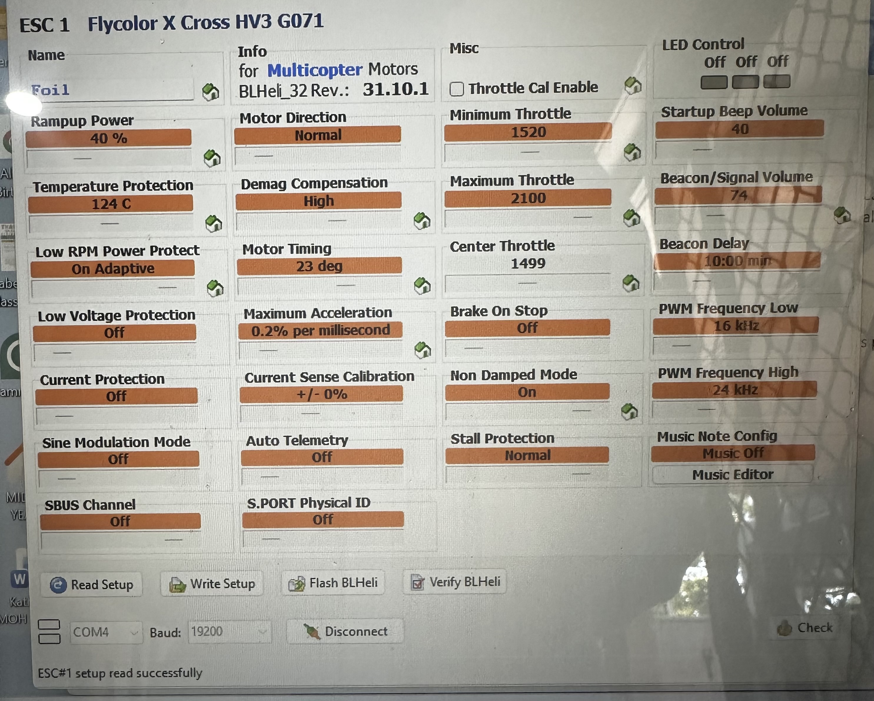

Hello, can you give us a screenshot of blheli settings please ?
Here it is sorry for the reflection
