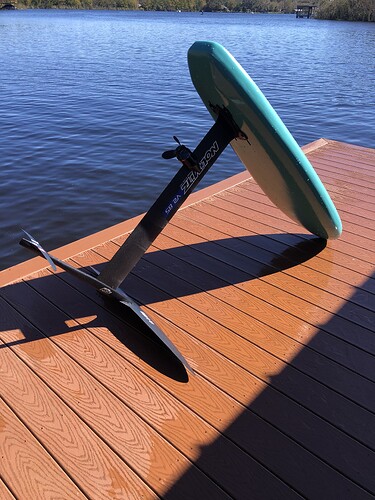

I’m having an absolute blast on my DIY foil drive inside the board. I love it. Power is fine in this with a 12s2p.

It baffles me a bit that guys spend ±5k on the foildrive and the ride it on std boards. You’d think they’d get custom boards so that there is no unit sticking out the bottom.
I agree. Even the custom boards that some companies are now making have a long groove running on the underside which often have a non flush lip at the front. It looks clumsy. The weight saved on a board with a foil drive inside is a big enough benefit for me alone. Then there is the dynamics. It’s a no brainer.

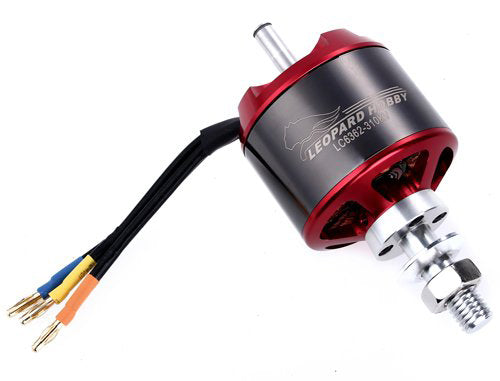

Today I tested a 6362 105kv motor. I used a two blade and three blade foil drive propeller. My goal was to shave some weight off of my setup by switching from an aluminum mast to a carbon mast. This motor is about 400 grams lighter and the mast is about 1.2 kg lighter. I was worried about the power to get up on the board with this smaller motor but it had zero issues on 12s and was more efficient then my 6384 baud motor and my 6374 Flipsky motor.
Max power used to get up on the Axis 1201 wing was 742 watts with the two blade propeller and 1367 watts with the three blade propeller. For reference I weigh 78kg. The total board weight with a 12s2p battery (p45 cells) ready to ride is 10.8kg.

Hey Tim, thanks for providing such concise info. Can you please share more details on the motor, link to AliExpress or brand. I’m 65kg, I’m sure it would be enough for me!
Here are some pictures, there should be more high up in this thread…
I think I purchased the last one from this retailer but you can find them from other sellers.
