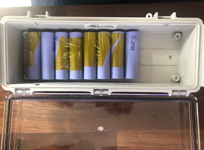

that’s the space left for the ESC & Receiver. I will cut a squared hole on the bottom of the case and epoxy/microballon + sikaflex the ESC to enable passive cooling.
enough space to fit a 40T 6S4P or 8S3P. I was hesitating between both, but I’m going with 6S4P because I could also fit my 6S8AH Graphene lipos… and get more batteries with me
What ESC do you plan to use? I have had good luck with 3m 5200 for watertight pass-throughs. Its crazy strong + tough and always has some flex left after fully cured so you dont need to worry about the seal becoming cracked/compromised if the joint were to take a hard hit. Only issue is that the stuff is crazy permanent so difficult to undo if you ever want to remove the esc.

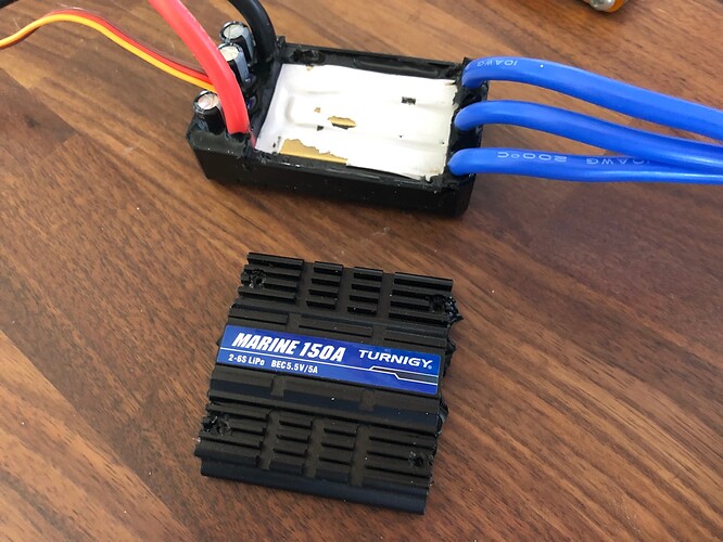

Hobbyking Turnigy 150A. I got already a fly color 150A on my existing build and it works fine.
Cool im using the same. I actually have both hobbyking and flycolor versions. They hit their thermal limit pretty quickly if you use it for much more than like 15 or 20 seconds at full throttle. Having some additional cooling would be great.
yes, I agree with the thermal limit. I had a thermometer measuring and it seems around 65/70°C
likewise, can only do little bursts. Not that big a concern using it in surf, as you are only using it to get into wave. But we have been trying for flat water pump training: a buddy is better than me and get do a 5 second burst, up onto foil, flat water pump for 40-50 seconds. I was doing too long a burst to get up, it’ll overheat. My buddy is going to experiment with the heat sink that others have commented on above.
moving on my second build. I’ve reduced the size of the heat dissipator knowing that I have no other choice than to put it up. I’ve also dig two holes, one for the ESC bottom (it’s plastic but still this will cool the ESC because of the water going below).
I will secure it with 3M 5200.
So far, so good.
I was tempted to install the esc that way but the plastic on the bottom side discouraged me.
Keep us updated on how it works when its ready ( how long you can keep it running before hitting thermal throttling)
yes, I also hesitated but that’s the only way to fit it. I believe that having a good part of the ESC outside will help a lot. When riding, I often put some water on my board and with the ESC below it will help to cool down faster. My plan is to get around 2 to 4mm depth outside/below the box as I will not be able to put 3M velcro tape in that area.
One of the big win with that box is that I will be able to use my 6S 8AH Graphene lipos (got 4 of them) and also a 6S4P 40T pack. So ultimately, that’s plenty of joy in the water!
