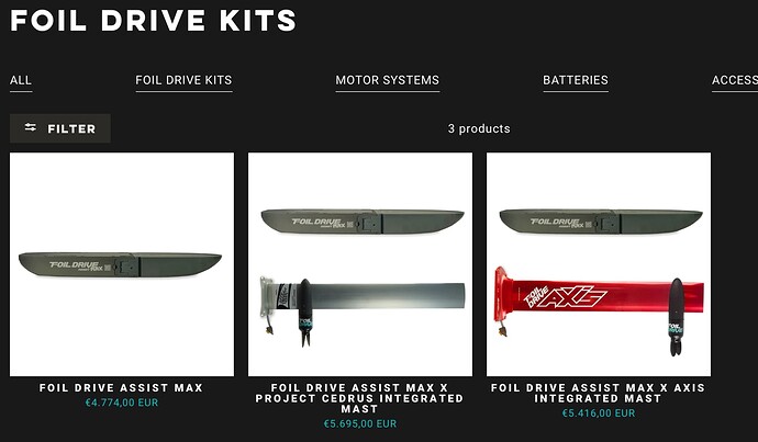

I just had a feeling they had copied the coffin drive…
I am a bit more blown away on the length of the unit though and not convinced that front pod is going to hold up over time…
Price is very high for what it is as well.
I’m assuming they are running 10s now with their 40v operating voltage.

A giveaway in the battery model number, 11S @3.6V. They also have the ‘Slim endurance’ at 8S2P 28.8V while the slim performance is 11S1P. So these units can run off 28.8V or 39.6V.

Actually the new foil drive assist max is just a better customized idea of the drive assist ideas made here. Those selaed boxes on top of the mast have been posted already 2020, Everyone knows the motor and the Maytech remote…In my opinion this new foil drive assist is well done but the problem will be their price of more than 5300€ +custom taxes… At that price you get already good efoils like the Sifly Rider or waydoo Flyer.
But that brings big potential for us DIY… We know how it`s done and we know it will work great… The most difficult thing for us is to get such a coffin drive alloy housing… if this is available we can have a foil assist below 2000$…maybe by group buy or crowd funding? Anyone has a good source to do such housings?
