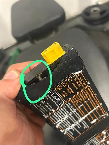

Hi ,
So glad I came across this forum.
While charging my foil drive travel battery , it stopped charging , when to green for a bit , then red and started charging again. Happened repeatedly.
On the removing the battery and on closer inspection, it seems like the battery is seems damaged on one side, very small damange. I have attached a picture of it.
I reached out to foil drive, and they will sending me a replacement battery.
What I was trying to understand is it this battery is damaged ( and could potentially cause a fire? ). The damage seems really small on the outer edge only,so doesnt seem like anything inside would be damaged.
Is it okay to try to charge this battery and use it again ? If it charges normally fully, any issues or risks with it ?
im trying to attach a video and some more images, but its not allowing me to since i am a new user. I could maybe email them to u ?
Based on your description of intermittent charging it would imply that the damage isn’t just to the exterior cladding of the battery.
Without “knowing” what damage there is internally it would seem logical that any further use charge/discharge could result in a fire.
If it were me I would get it outside immediately and put a plan in place to safely dispose of it.
2nd that opinion
OP got free replacement and even a new battery would only be between 300 and 800 Euro? Thats cheap compared to a house fire :wink: Especially now that OP admitted publically that he knew about the fault..
:joy: :joy:
Fair point. The only thing is it will be a while before the replacement battery reaches me. I dont want to have less time in the water. From your responses, it sounds like it can be quite risky.
There is no scope of getting this fixed/repaired right ?
Also, if not, how are you supposed to discard these batteries?
To repair you would have to open the case to get a look at the problem
In Germany you would take the battery to the trash collection facility every city has, they have special containers for damaged lithium batteries
A few friends have had travel batteries not balance correctly and were replaced.
This would cause the same issue with the charger turning off (due the the BMS switching off due to a high voltage cell) before the whole pack is at full voltage.
I would peel back the heat shrink and look for damage. Maybe scrape a bit deeper and see if there is actual damage.
You could also figure out the voltages from the pins and see which pack isn’t balancing correctly and top it up manually.
Prob safe to use and charge outside, but would not fly with it.
