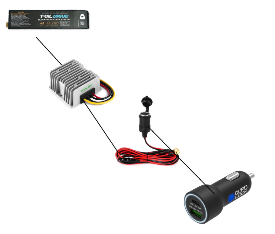

Youll need to have a step down voltage converter. Im pretty sure foildrive uses xt60-xt90 connections.
So it should be something like this:
Battery → Voltage Converter (to 12V) → one of those 12v car sockets → plug 12v car usb adapter in and start charging your phone.
Simple:
