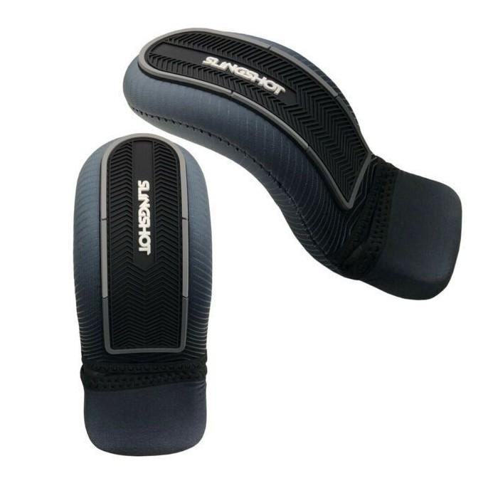

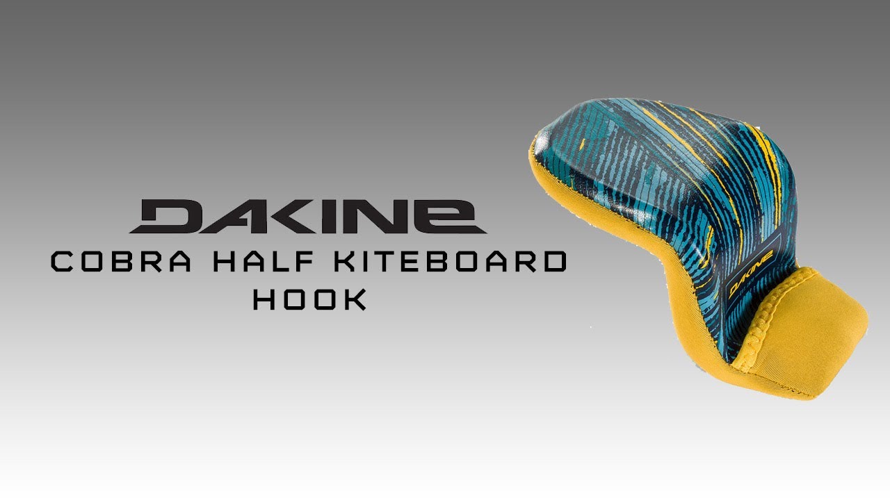

To preserve your ankles, you also have foothooks: Slingshot, NSI, … or the comfy Cobra Half Hooks from Dakine

@SoEFoil Ive seen those too. I think i need to try them out to really see how they feel. Both in terms of good connection to the board and safety. The only problem i see with these is the mounting as they will result in really high forces being applied to the inserts. I dont think a insert only attaching to the laminate will suffice here. At least not with my super thin (2x160g/m2 gfk) laminate. So im considering using one for the back foot where i can attatch it to my electronics department lid. Have you ever tried them?
