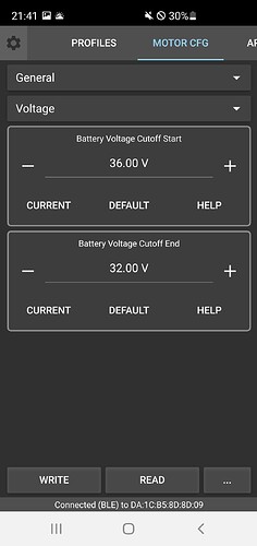

What’s your motor current set at? That or battery limit could both limit your power.
Motor current is set at 150A.
I don’t see any error on settings … body position and foil maybe ?

Additional photos, its just gorilla tape and I redid the front nozzle so not too bad. Also managed to run it in a bin today some interesting errors! I’m getting an abs over current at 165A but I’ve it set to 185A. Also on the vesc tool logs motor current only ever hits max of 149.78A. Battery in current only hits 120.58A max. Anyone any idea why?

VESC Tool Screen Record in Bucket
Sorted my ABS Overcurrent by increasing to 420A. Not happy about that setting so will gradually lower but it works.
