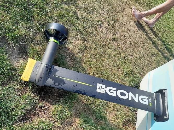

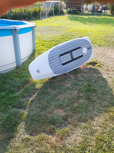

Hi friends,
Jezza, you were right, today was the first pool test, everything was great except for a few leaks but I’ll manage that too.
Here are a few photos, there will be more after the first test drives.
Thank you very much Jezza and all the other important posts from which I was able to learn a lot.
I love this forum, don’t give up
Best regards
Franz
