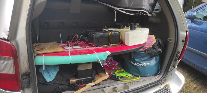

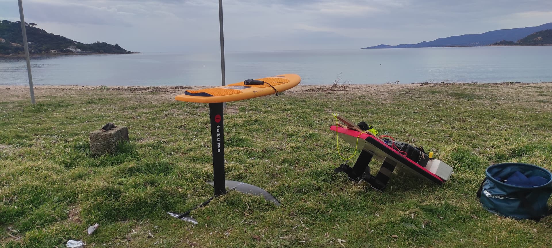

Inspired by your builds, and frankly because it seems that sometimes for some of us, when it works you start thinking about the next project, i wanted to show you my tow boogey.
I wanted to keep it simple, and it’s called “scratchy”, because the board has been in my basement for a decade where stray cats went feral on it.
I mainly tried to use all the parts left over from my efoil journey:
Two 6384, flycolors 80A esc, a bremote kit ( that’s new).
I use the same battery than my efoil 12s8P. So i can choose my horse for the day.
It works reasonably well. I haven’t tested it much because rain have kept us grounded for the past 5 weeks.

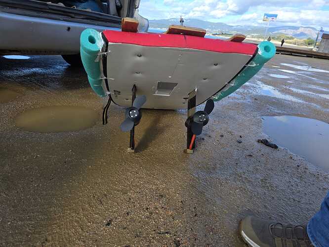

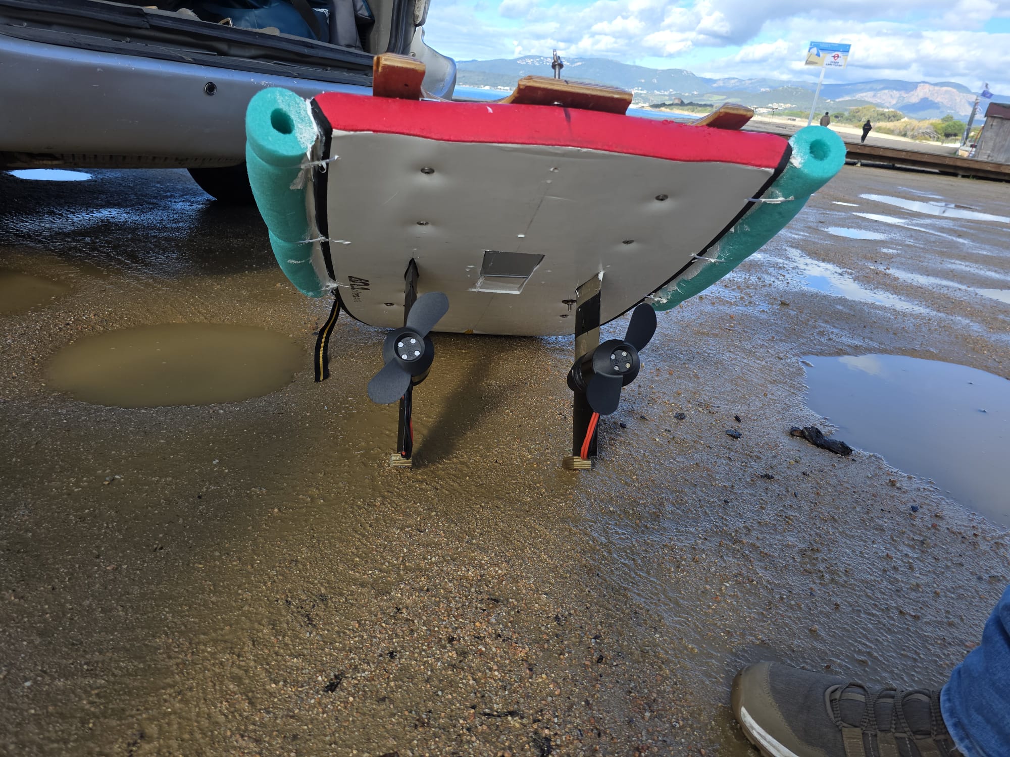

A lot of nose up at the begining, solved by a long pole at the rear.
The Esc are glued in an aluminium box, which is on contact with ocean water.
It oscillates on the roling axis, and pool noodles have been added to the rear to make it squarer, I have yet to test it.

I put the motors up in the middle of my masts, and i found that the board expresses less “rodeo/nose up”.

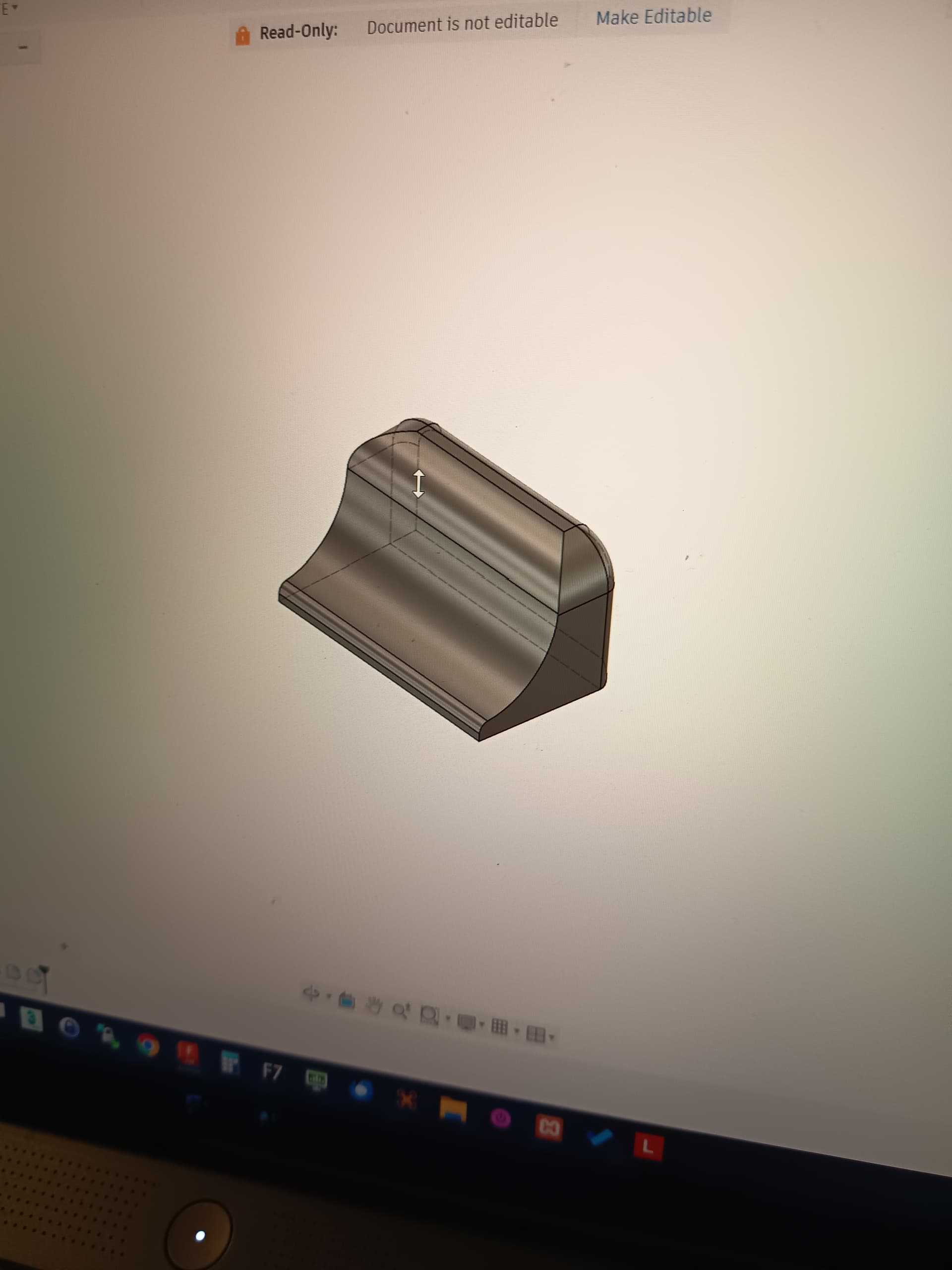

I added a small “hook” to my board, printed in TPU.
When starting I push the handle onto it and use that to push up and stabilize the board.

Whoa that’s a neat idea ! So it makes a handle. Very cool. Can you share your file please ? I’m not the best at curves on tinkercad. I will try your idea
Thanks ! Its a good feeling to see it working after so much time in your head :slightly_smiling_face:.

https://3d-visualisierung.de/dateien/stopper_handle_tow.stl
